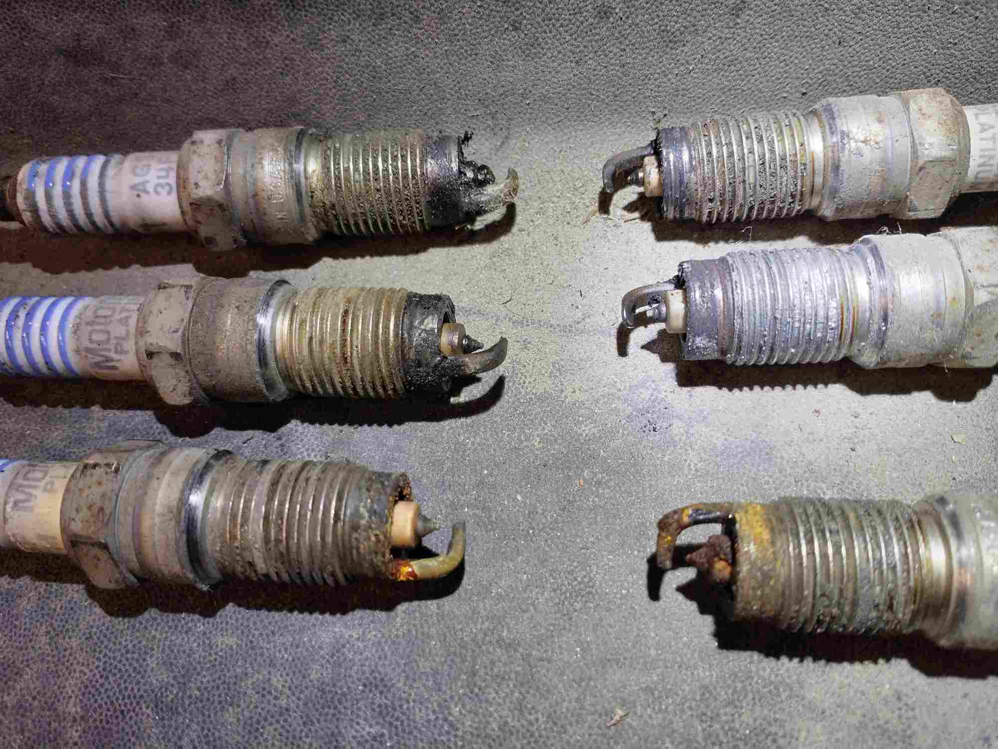

Things are not looking so good. After removing all 6 spark plugs I noticed signs of moisture on both front cylinders.
This is how the plugs are in the engine.

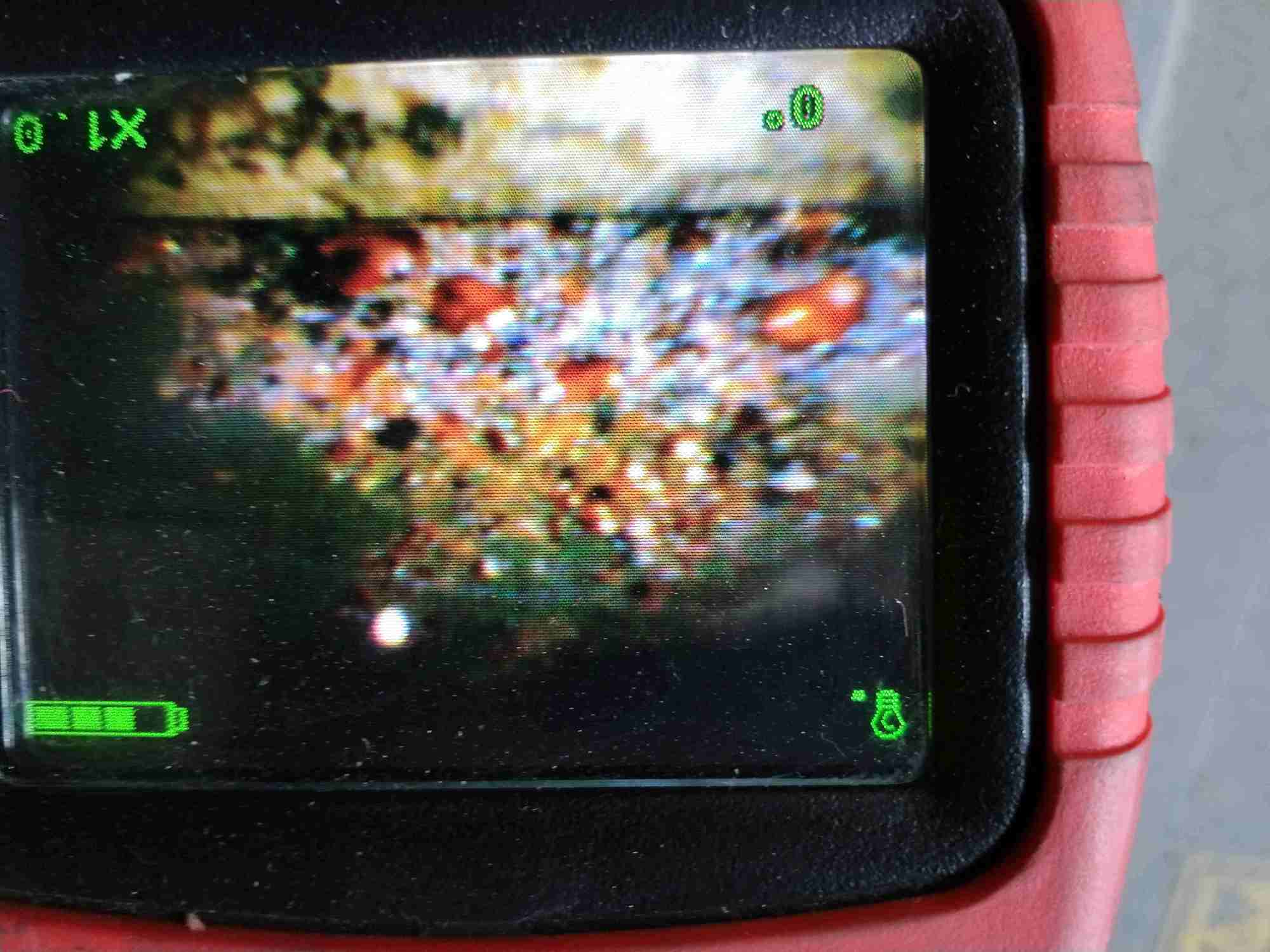

Next i stuck a camera down the cylinders. Again not what I wanted to see, obviously.
Piston is at the top. The bubbly rust is only in this one spot. Most of the cylinder is clean. Both front cylinders have rust. This is the worst in pic.
