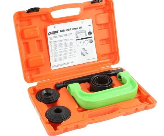

I never tried it but could this work for wheel studs? Autozone will rent it out for free. (If you have a store near you.)
Yep, I was going to suggest something like that. Just didn't know what to call it. I used one to remove my king pins.
