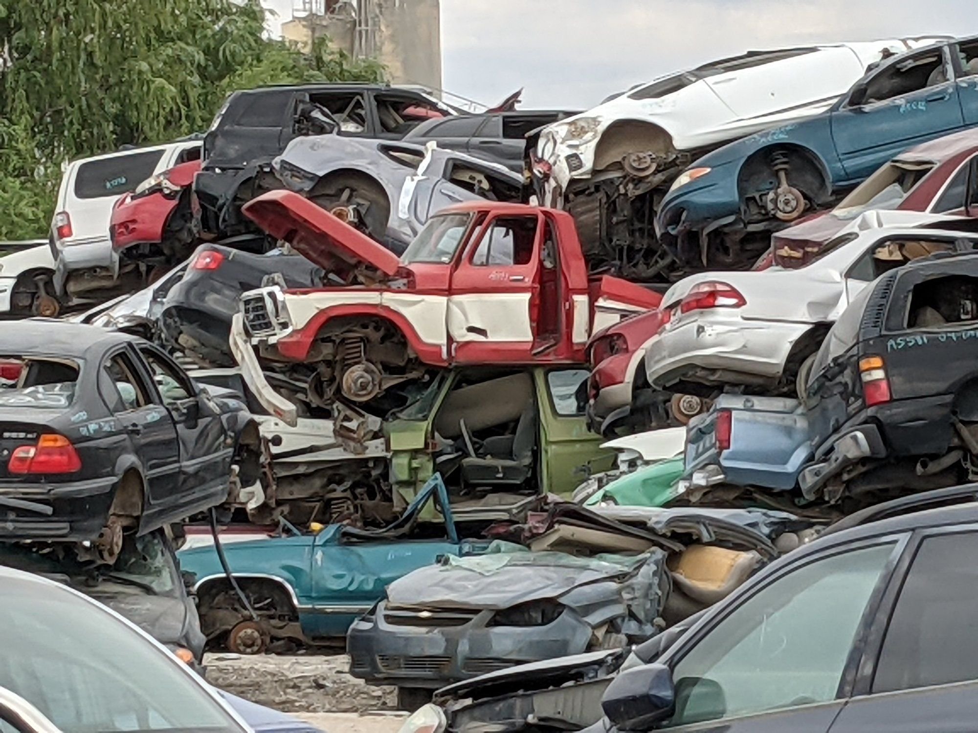

I would venture to say that you might consider a cordless sheet metal nipper and cut a cowl off of a clean Calif pickup.
I didn't even know that there is an "ipull-upull" recycle yard in Sacramento, until I found it during a search for something.
I am constantly looking thru Pick-n-Pull website for the northern Calif, yards. Then pulling actual pieces is a booger most times.
If you patch in a piece of cowl, will you be using Panel-Bond if possible ?
I just recently pulled an upper trim for the passenger front fender, and the pickup had an intact cowl and cab.
Gosh, it saddens me to see these intact pickups go to the crusher.

Yes makes me sad also. And the green Super Cab underneath the red/white trucks also.

Yes, seeing a good vehicle go to the crusher is moving experience.
