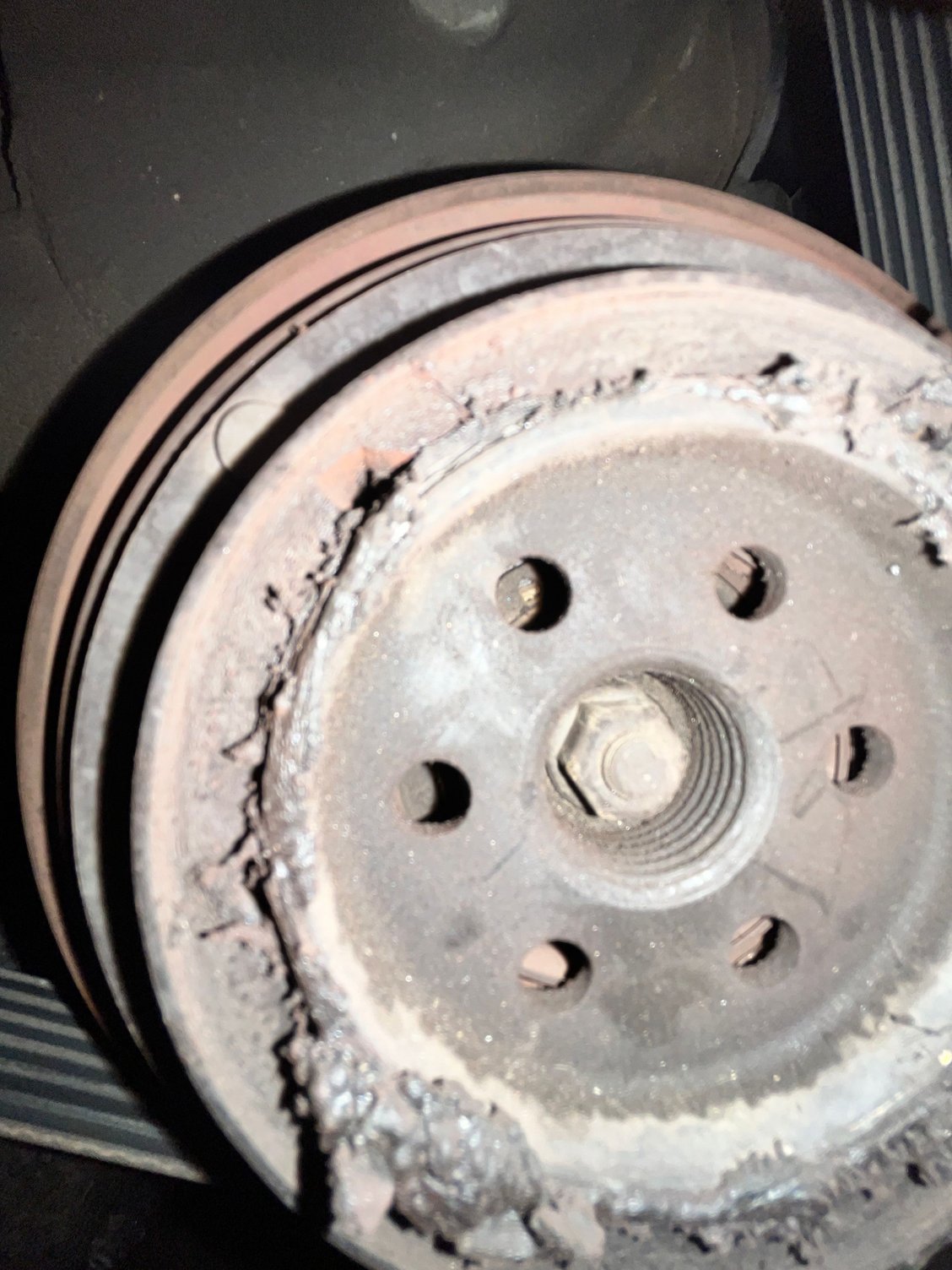

AC compressor clutch went out on the 88 F150 300-6 with factory air. All original AC parts, was told only the clutch would need to be replaced, but i can’t seem to find one? Anyone know the original part number for these compressors/ clutches? Thanks

At that point, just go through the system. BTDT. especially at that price

Been there, done that. It was on an '05 CRV with a K24. I would never again put $100 into an unknown age compressor.
Seeing on a 4.9 you have a lot of hassle to R&R the thing.

88 should have the FS6, at least V8s. Remember, you also have near 40 year old rubber hoses that are junk too.
I know it is not what you want to hear, but I would 100% not mess with any of the old junk and fully replace the system.

I disagree. If the system was working correctly other than the pulley bearing failure then I would only replace the clutch, pulley and field coil.

Agreed, no absolute reason to replace the compressor yet
However, sometimes the hub melts because the compressor is failing
Have a Ford dealer parts department tell you the obsolete clutch hub and pulley part numbers and the field coil too (it might have melted as well)
Then check Ebay for NOS parts
I at one time had a few of them for sale on Ebay
Sold most of them
I doubt I have any old FS6 hub parts left, but come up with a part number and I will check
Pull that hub off and check the spline count, the early ones had less splines.

Are we not looking at same photo? That has melted rubber on its face. If you really think just a clutch is able to fix it, go for it.
Go pull the FOT and report back what it looks like with a picture.

Any comp I have clutch slapped has already lived its useful service life and often make a few more years before their time is over. A compressor from 1988 is far beyond that time.
That thing obviously became beyond hot to melt all the rubber out. Who knows what other damage happened internally to it during that.

That looks rough!
Last time I saw a compressor clutch melted like that was because the the compressor itself was locked down. Might want to check and see if you can turn it without the belt on it.
