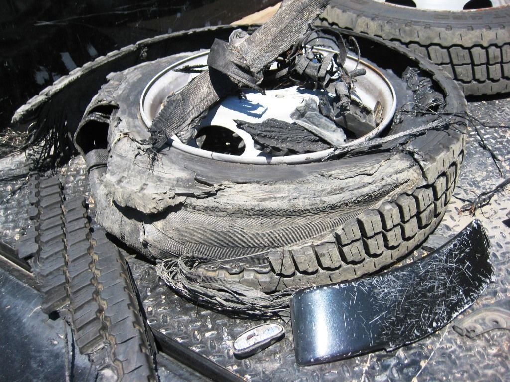

Check out the full depth, flawless, thick and meaty tread on this spare tire.
It isn't the tire damage that hurts.
It is the destruction of the fender, the fender liner, brake line, ABS wiring, running board... that'$ what hurts.
That is, if one manages to steer to the side of the freeway safely with only 1 front tire.
If not, then the damage extends beyond the truck's body to the human body. Or bodies.
I remembered seeing this picture of your tire before so I tracked it back to this thread. 2022 F450 Lowest Tire Pressure - Ford Truck Enthusiasts Forums (ford-trucks.com) It seemed in that one you indicated it was a zipper failure from low pressure. Or was it correctly inflated and just old?
I had a whole front wheel leave the truck a few years back, and yeah the other stuff got expensive. To the tune of $4000.
It was correctly inflated and just old.
How old? That will be answered in a moment, in response to one of our sentiments in held common, which I hope you will let go of.
The THREAD you referenced, which was begun by another FTE member, was about his 19.5" commercial tires being under-inflated, and I was merely responding to that thread within the context set forth by the original poster.
Yes, under inflated steel sidewall tires can fail dramatically via zipper failure. And over-aged, under-utilized tires can fail similarly.

How old was the blown tire in the photo above, and that you found in the other thread?
Let's put it this way: When Ford brought to market the reimagined Super Duty brand to full size pickups and chassis cabs back n 1998, Ford did a number of things to get attention. One of those things was to give Gary and Monika Westcott, of Turtle Expedition fame, a brand new 1999 F-550, which became the foundation for their Turtle V Expedition rig.
For decades prior to the existence of "EarthRoamer" and "Expedition Portal" and "VanLife," the Turtle Expeditions 1 through 4, with the latter two both based on Ford trucks (#3, a brick nose 6.9L, and #4, an OBS 7.3L IDI) captured the riveted attention of camping enthusiasts who wanted to wander off the beaten path, and do so self reliantly. Before the existence of YouTube, forums, blogs, or even the world wide web, Gary and Monica regularly submitted articles published in magazines like Peterson's Off Road, Four Wheeler, Trailer Life, etc, as they traveled around the globe, slowly, like a turtle, in their protective shell.
While today the Westcott's have faded into the cacophonic white noise of many me too expeditioners, it was quite different just prior to the turn of the millennium. Back then, the Wescott's were celebrities in the world of truck camping. Their articles on sponsored products that they incorporated into their rigs made them quintessential "influencers" and "key opinion leaders" before such terms existed in the vernacular of marketing.
So it made sense for Ford to give them an F-550 upon which to design and build their ultimate "Tortuga" Expedition V vehicle... an all terrain, all climate, all countries camper that wasn't on a UniMog or a MAN military troop transport 6x6... but rather on a plebian 4WD light medium truck chassis... a concept that Earthroamer copied and commercialized.
The first thing that Gary Westcott did was have Stockton Wheels build a set of custom 20" super singles, to run 335/80R20 tires, so that he could ditch the OEM dual rear wheel 19.5" wheels and tires, even though Ford had upgraded the tires to traction type with their gift.
There were initially two tire models in the Continental General LMT series, both Load Range F...developed for the introduction of the 1999 Ford F-450 / F-550.
The LMT 460 was the All Terrain, All Position tire with big center tread lugs for traction, but closed shoulders for steering stability. This was the traction tire upgrade. The LMT 400 was the All Season, All Position tire that was the standard issue tire for all Ford F-450 and F-550 chassis cabs prior to 2002.
It is important to understand that prior to 1997, there was no 19.5" tire on the market with a speed rating higher than 75 mph. The "M" in the LMT name stands for General / Continental's all new 19.5" tire's speed rating, M, which is 81 mph. No other 19.5" tire on the market at that time was speed rated higher. In fact, no other tire even matched the speed rating of M... which sort of forced buyers to continue to select the General Continental LMT series if they wanted to maintain the tire same speed rating as OEM. The now ubiquitous 87 mph speed rating N for 225/70R19.5 LRG tires that are quite common today, didn't exist with any brand of commercial tire, including Continental, back in 1998.
Anyway, the blown tire in the back of my truck, is one of the LMT 460 tires from the F-550 that Ford gave to Gary and Monika Westcott, who brought the tires to a rally that I was involved with, attended by a few Ford employees in the Super Duty program, from leadership to engineering. In a circuitous path, I somehow ended up with the OEM tires and wheels that the Westcott's didn't want, which were stored INDOORS, until one fine day, 10 years later, I was in a conundrum similar to yours.
I had bought four new Michelin XDS2 drive tires, but I hadn't bought steer tires yet because I was scheduled to receive some steer tires from Ford (Continental HSR) which I hadn't received yet. So in the meantime, for what was intended to only be a temporary interim solution, I pulled a couple of those LMT 460's out of storage (indoors) and mounted them on the steer axle.
Why?
Because I was "just trying to get some use out of the resources currently available to me first if I can."
On the first trip longer than 10 miles, I felt a subtle vibration at 65 mph, but there was no place to pull over, as I was heading into a tunnel, where after I entered, KA-BOOOOOOOM....the reverberation of the sound in the echo chamber of the tunnel amplified the horror, to be immediately followed by FLAP BANG FLAP BANG FLAP BANG... which was the tire tread alligator beating on the truck every revolution. The tunnel was nearly 3/4 of a mile long, so that wasn't fun listening to the truck get wrecked while trying to get safely out of the tunnel. Had to call a taxi to take my wife to the airport from the side of the freeway, while I spent the rest of the day playing musical tires in order to get the truck back home. No tow truck was called or harmed during this exercise.

If the spares had any visible cracking I wouldn't consider using them.
The blown tire's sidewalls were not cracked. The entire LMT series of tires were junk. During the years 1999-2003, there were so many LMT series tire failures, I know of at least two large contractors who changed the color scheme of their company trucks to have front fenders of a different color than the rest of the truck body, due to how many fenders had to be replaced from blown tires. A different color fender doesn't have to be color matched to the surrounding paint.
Ford abandoned the LMT tires, and moved on to a Continental offering that was not co-branded with General, with both a higher load rating (G) and speed rating (N), and never has looked back since. General ceased production of that tire shortly thereafter, despite having introduced a third version of the LMT Series, the LMT 450, a Mud +Snow rated Drive tire with open lugged shoulders and the center tread blocks of the LMT 460.
Despite understanding all of this, I still thought I could get some use out of the resources currently available to me, for just a short while.
I'm not telling you what to do. I'm telling you what I did that didn't work out too well for me.
