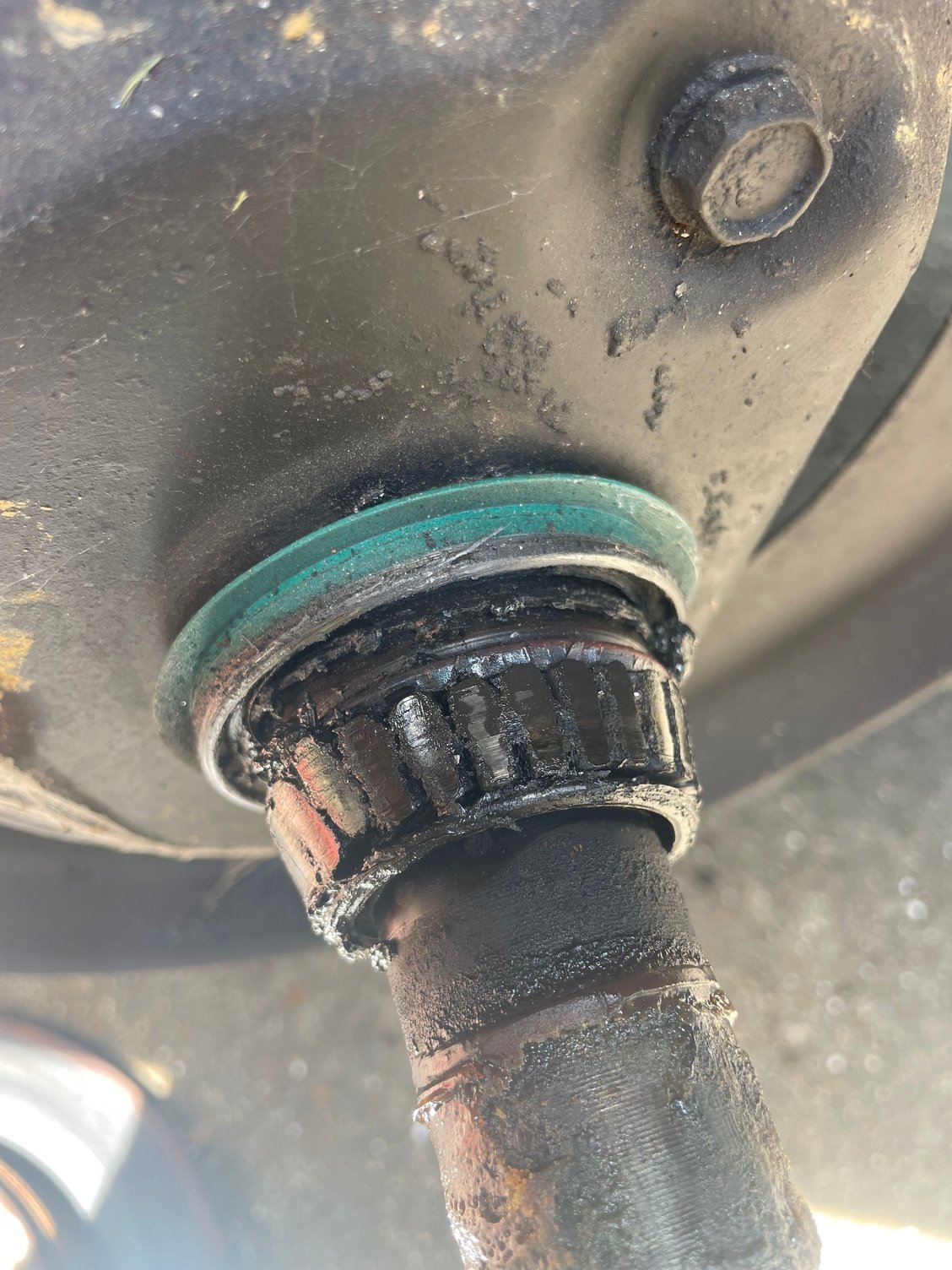

Hey all, I was replacing my bearings today and it snowballed. As shown, the inner bearing is destroyed…along with the spindle.
‘77 F100 Custom Explorer, all stock. (factory front disc brakes)
Nothing at the parts stores, I’ve looked a bit through the forum and haven’t seen anything. Rock Auto, National Parts Depot, LMC, Classic Industries, Dennis Carpenter, Bronco Graveyard…I’ve checked them all. I can get the bearings no problem, as well as the rest of the hardware.
Any help is appreciated. Last thing to get this truck back to daily status! Thanks in advance.
Keith

That spindle can be weld filled to fill any gouges and machined to accept the bearing race. The seal surface might take a polishing too.
