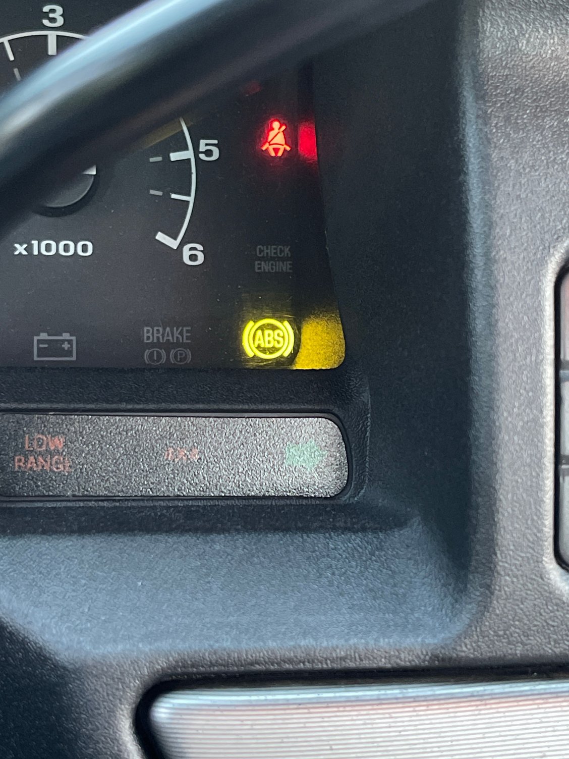

Fuses all look okay. I did notice that the fuse that was on there was a 15 amp instead of a 20, but it was not blown. Furthermore, I’ve noticed that’s there’s two different brightnesses for the light. When I start the truck it will be max brightness for a second then dim down and stay solid. When I pull the fuse it’ll stay solid at max brightness.
I’ve attached some pics to show what I mean about the different brightnesses. I currently have LED bulbs in the cluster, not sure if that matters. The cruise control was not working before I changed them either. But that could also be from my faulty crash sensors.
