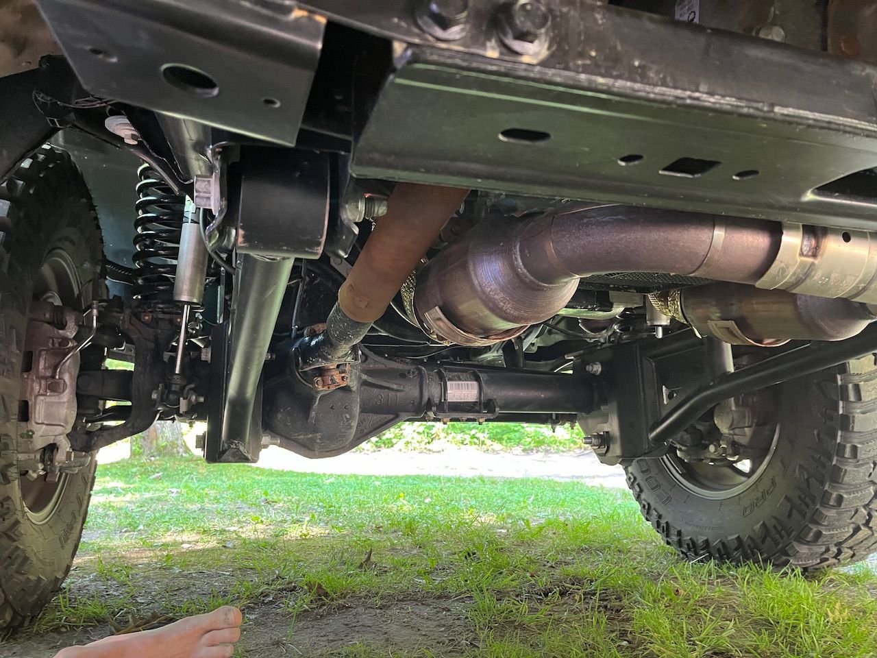

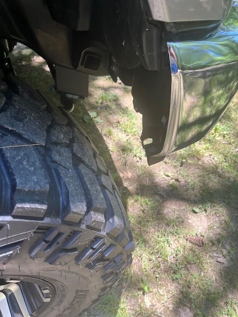

don’t know if this will help but here’s a couple pictures of mine with 38 x 13.5 tires.

This is great! Thank you. Do you know your wheel offset? And you have no rubbing on the radius arms that I can tell, right?
Old Jul 7, 2024 | 12:25 PM
Mainebucks's Avatar
Mainebucks
Joined: May 2020
Posts: 791
Likes: 156
wheels have 4.5 backspacing and
-18 offset on 20 inch rims.
4” bds radius arm lift gas engine.
Had a little rubbing on bumper corner that I trimmed. No rubbing on radius arms.

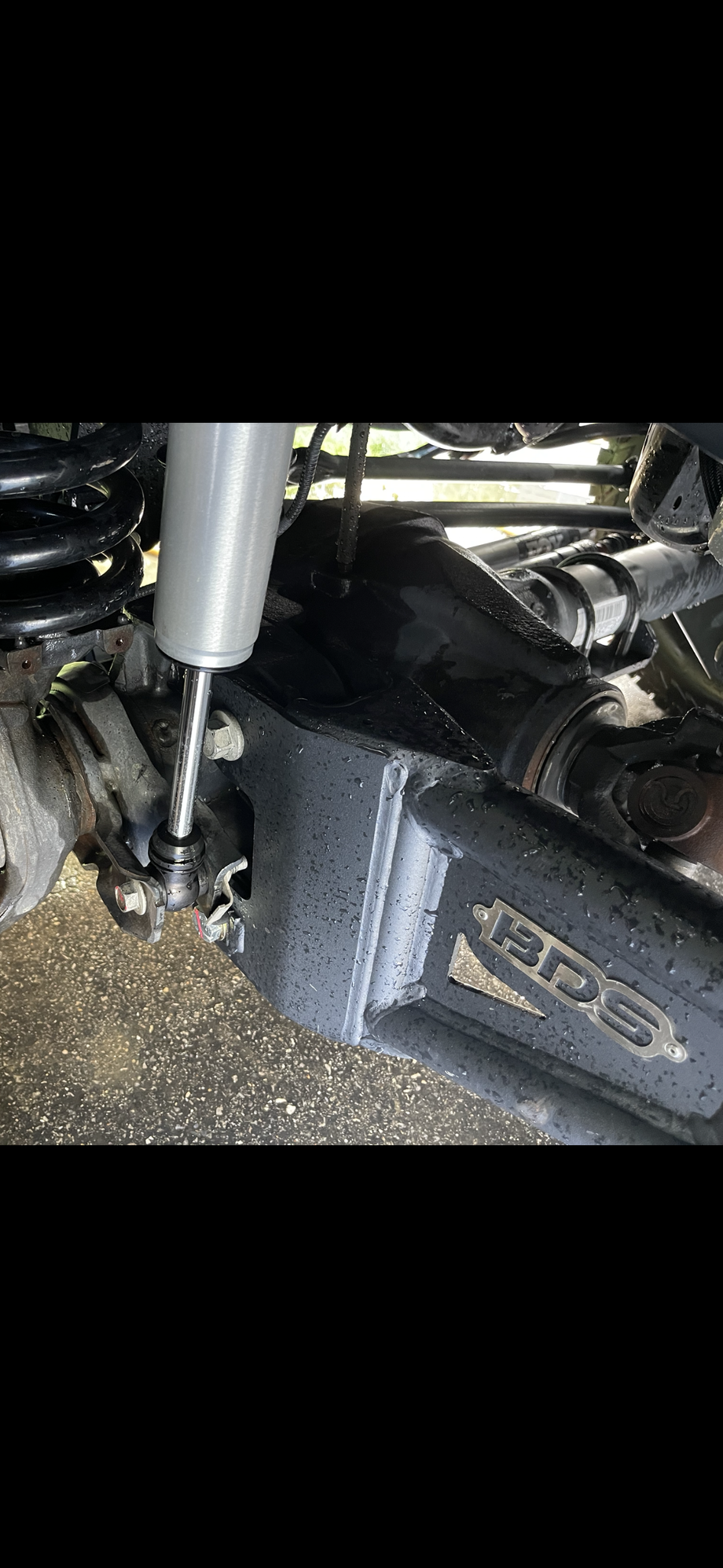

Found an old pic that show the smudged off paint. Not the clearest but it was from the short time I drove with bds arms and 37x12.50s on stock wheels
I didn’t like it rubbing so different offset wheels it was in the end even though I liked the stock wheels the truck had

from the looks of those arms, they do not appear to give any more clearance
