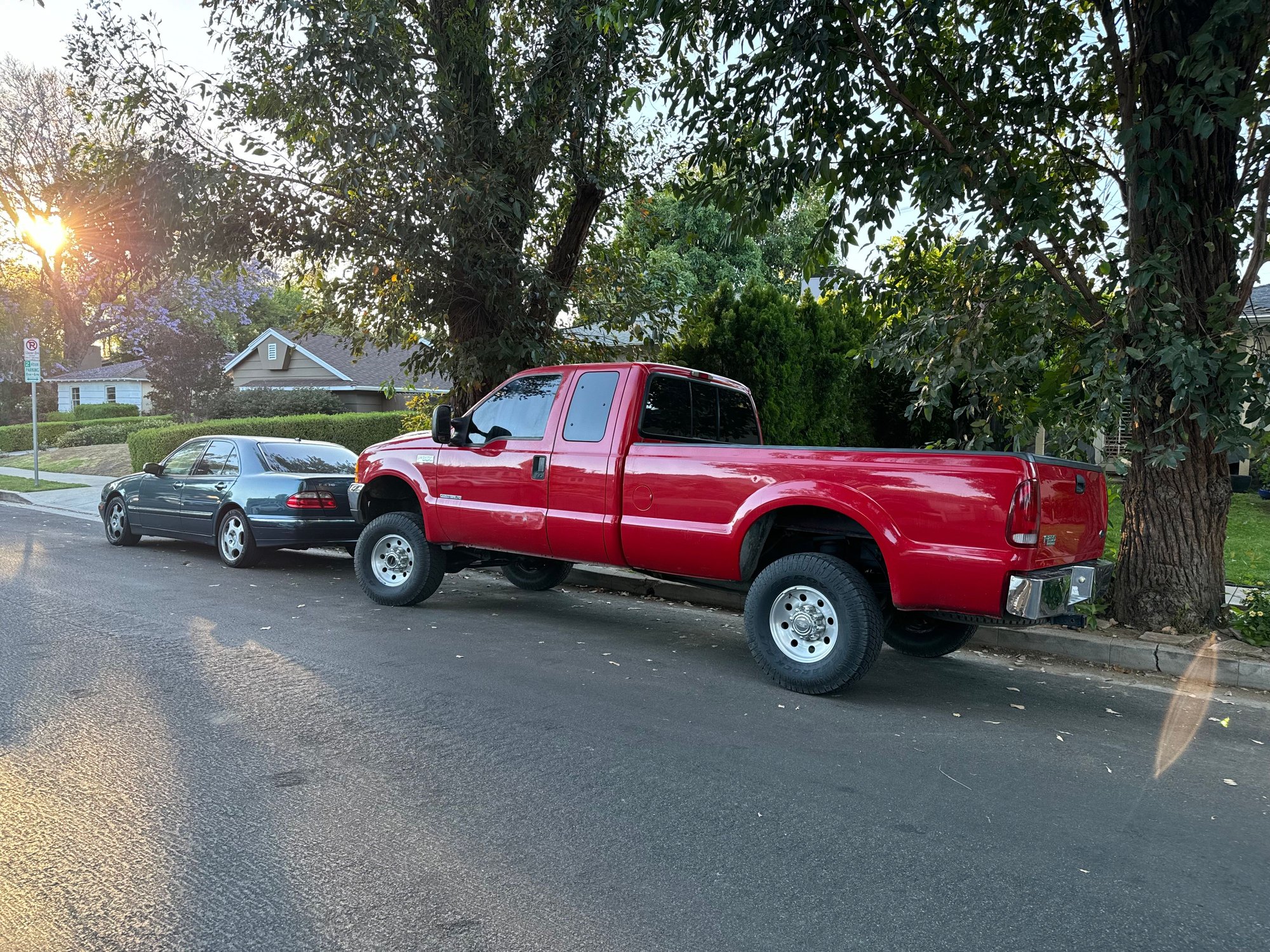

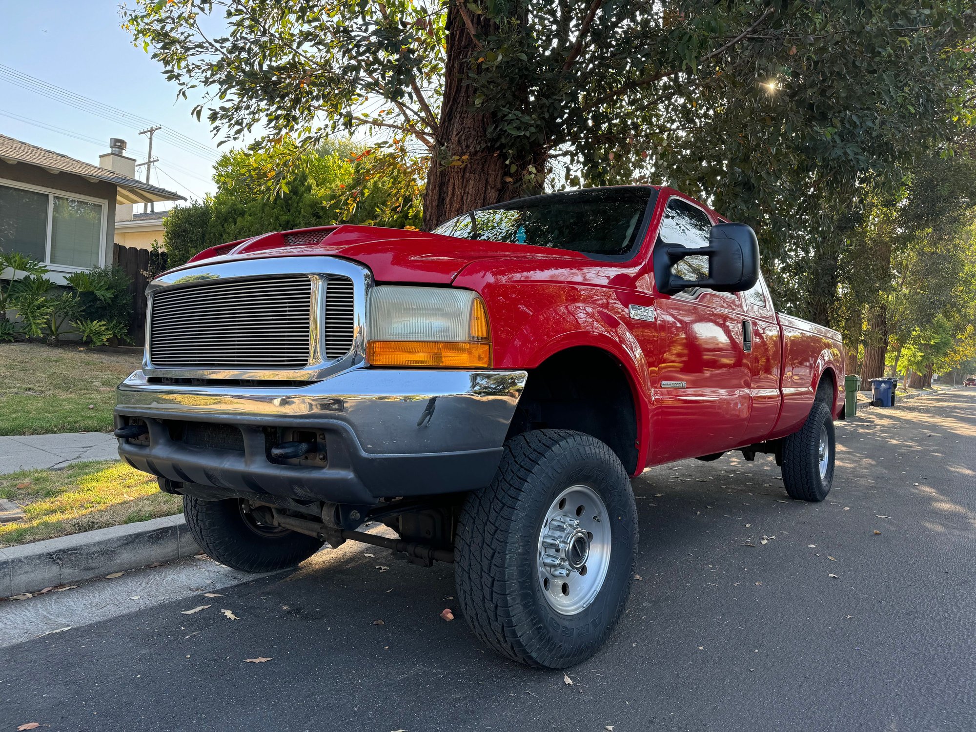

Bought a '99 F250 SuperCab which brought me into the fold. This will be my 5th Ford truck and a 2nd SD in same config. Time will be the judge of whether I got lucky with this one but so far I'm pretty stoked. Came with some good mods so not much I'd want to add, maybe upgrade the lighting down the road and install side steps.
