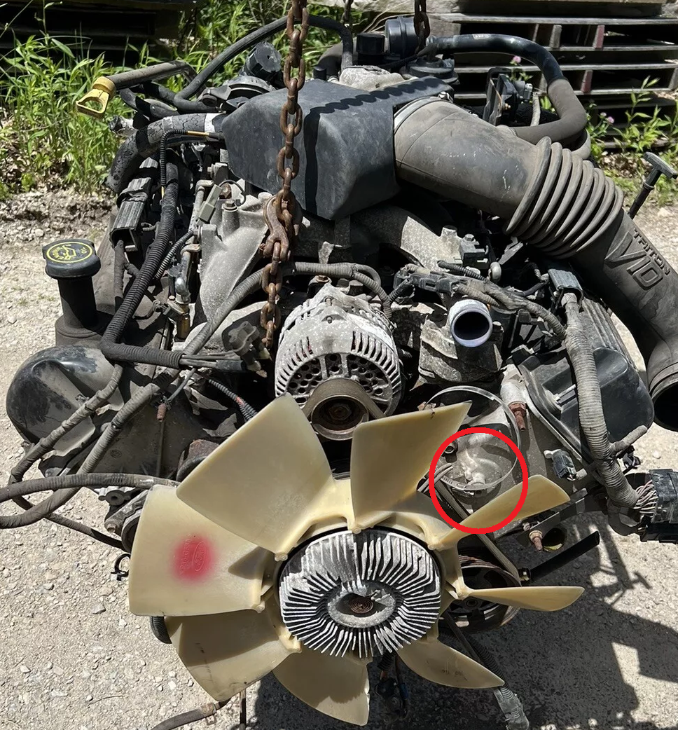

I've always been curious . . . well not always, but since I noticed this:
It looks like it is a vestigial pulley mount that they later decided to never use, but left the casting in place. It is perfectly aligned to be for an idler pulley for the belt.
What is this for?
Is there a configuration of vehicle/engine that uses this?

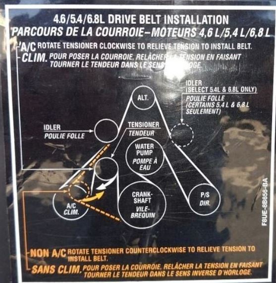

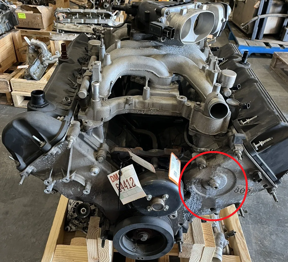

Looks like the earlier V10's used it as an idler pulley. Then Ford determined they didn't need it...?

I haven't been able to find a reference to this until your example. I'll have to fish around for the size etc. I suspect it is supposed to be 4".
Thanks!
Is that your picture or from the Internet?
