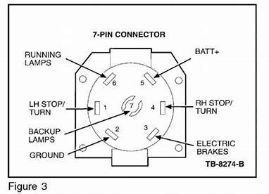

4 pin does not have power to the trailer, only turn signals, brake lights and ground. You need to wire off the 7 pin, then the usual tricks you mention might work. Not sure which wire the truck uses to sense that a trailer is connected, that may be your issue trying to figure out.

If your f150 is like the super duties, and assuming it is a 2019 not a 2029, there won't be any power to the trailer charge wire until certain conditions are met. With mine, the engine has to be running, alternator load below a pre determined number then push the brake pedal.
if the load goes higher than a pre determined amperage the computer will disconnect the power.

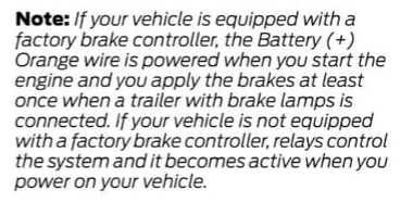

See your owners manual, with factory brake controller truck has to sense trailer attached, truck has to be started and brakes applied. All conditions not met power not turned on. See note section below:

Originally Posted by Wyldfire
I think this is your answer to the electrical behavior.
I suppose you could equip the lift with a number of light bulbs that are connected to the trailer brake/turn light circuits to satisfy the test for brake light presence. Then you'd have power while the engine is started, and the brakes have been applied at least once. I'm not sure how well the pickup's trailer power circuit would tolerate the inrush and continuous loads created by the lift.
Personally, I'd run a separate circuit straight from the battery.
