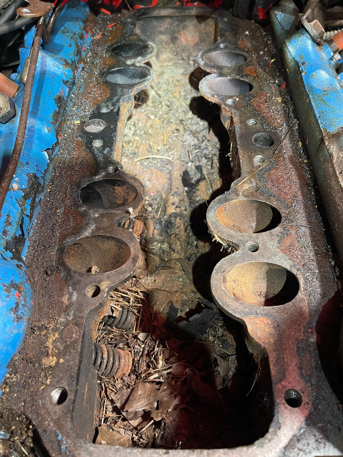

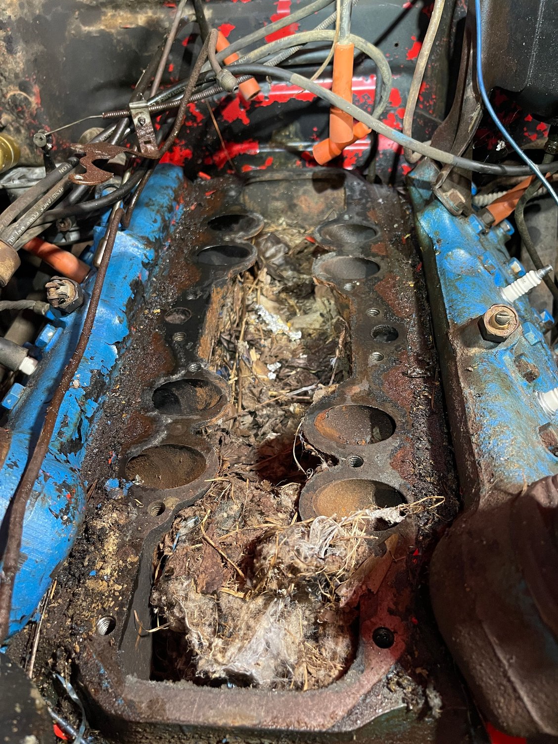

Hey everyone. I took off my intake manifold today from a 48 F1 and there was nothing but cotton and rat nest leaves trash and rusty springs etc. I was planning on eventually swapping the engine, but I wanted to fix/use the original flathead for now. I thought it would be pretty clean and try to crank today. I was very wrong on that idea. Everything is rough. Is there anyway it could be cleaned/ rust removed or does the entire engine need a total rebuild/replace?​​​​​​​

Most of that looks like creature invasion. I'd give it a good shop vacuum treatment, spray it with some WD-40 or similar and then try to rotate it via the crank bolt and see how things are moving. Based on that picture, it could go either way - a runner (not fresh/new by any means), or something that needs a rebuild.

The crank moves freely. I put oil in spark plug holes/cylinders before I knew how bad it was and turned the crank. I am glad it's a possible fix. I'll keep cleaning it out. Is there a bolt list for a manifold that you would know of? I got two bolts confused and don't have the service manual in ye to see what goes where.

That is a lot of garbage in the valley and it will not be fun to clean out fully, and you'll want to get it 100% clean and avoid getting any of that debris in the oil pump and passages. If there's that much up top, you can bet you've got more than your fair share down below, too. It might take pulling the engine for a deeper opening up to clean out the bottom end, too.

With the manifold off, you can see how the valve train operates and look for stuck valves, broken springs etc.
According to my parts book, the manifold is held on with 20 bolts, all 3/8"-16 x 1 3/8" in dimension with a 3/8" lock washer.

Well the top is finally clean and I think you are correct. I'll go ahead and clean the bottom end. I was told its probably been parked 40+- years.
That's great to know this manifold has different length bolts throughout the manifold. Im guessing someone just used whatever length they had close by. I'll check valves springs etc. Never done much major engine work nows a good time to check and learn though.

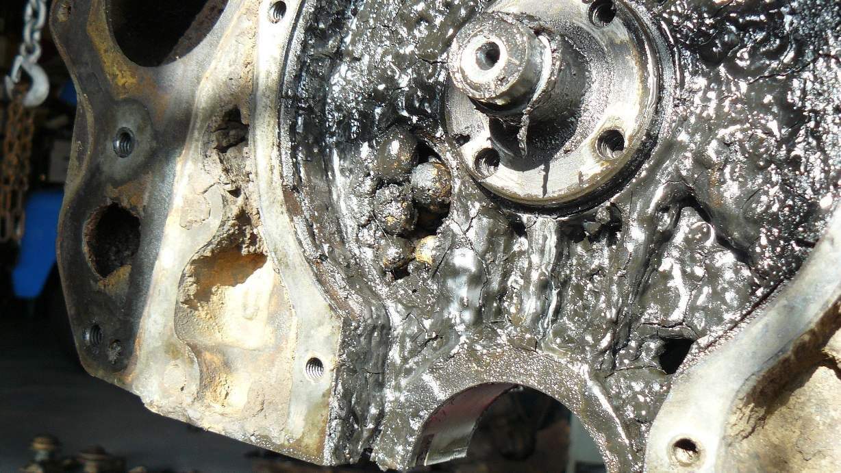

I once got a flathead engine cheaply because it would only turn about 1/2 turn before locking up. It had had a rodent infestation, so I assumed their pee had corroded some lifters. It turned out to be acorns they tossed down the breather passages into the timing cover, that were jamming up the timing gears. Be sure to check there, too.

You can see how sludged-up it was, I would never try to run an engine like that. After a few thousand in machine work it is a great engine, in an FTE'er's truck.
