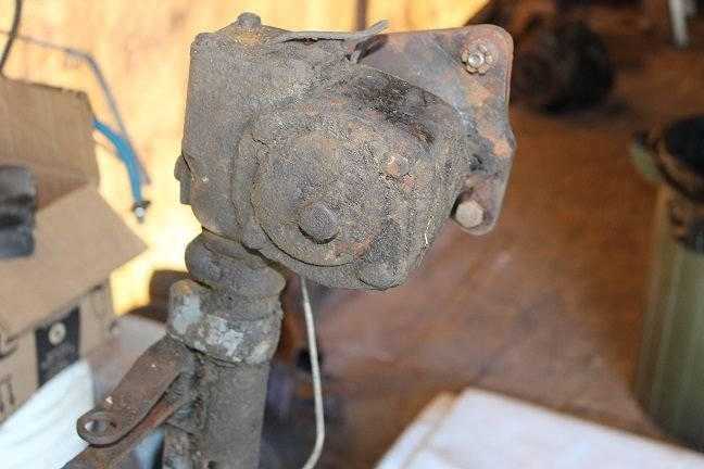

Retired here so on limited budget as usual. I need to repair / replace manual steering gear box. Would it be cost effective to install power steering or should i stay with what i have?

find you a 56f350 steering box. They are larger and stronger and have a different ratio and steer easier. I might have one here. I'd gave to look

They are the same, Abe. F100 and F250 use the same "Gemmer 3CC03", and F350 on up use the "Gemmer 4CC07"

just so you are aware, the f350-500/600 boxes require one new hole in the frame and a little massage to another hole.

In 1982 at the advice of an old ford dealers mechanic I installed a F350 box in my 56 F100. He told me the original box was not strong or robust enough and it would need to be adjusted regularly and would wear out prematurely. He said that he repaired them frequently back in the 50s & 60s. Bought two 350 boxes from a salvage yard, rebuilt both with new ford parts, still have one as a spare as I’ve never had a problem with the one I installed. Kevin is correct in the mounting of the box. Drill one new hole and elongate another one and it bolts right in. The steering is much easier than the original box.

so the boxes are still difficuilt but are out there. Now the tough part: do i have to remove the entire steering column to replace the box as it appears to be a cover all the way to the top of the box ?

The box and column is essentially one piece. Removing the outer sleeve will expose the steering shaft, which is part of the gears in the box. You simply have to disconnect the pitman arm, remove the trim plates in the floor board, remove the steering wheel, unbolt the box from the frame and the shaft from the column drop bracket and remove.

so is there a coupling in the shaft housing to break apart so i can have a new gear box pressed on or do i take the entire shaft and box to the shop?

Yep, you’ll need to strip everything off and the only thing left will be the box with the steering shaft and sector shaft sticking out. They are pretty easy to rebuild if you have all the parts and are mechanically inclined.
