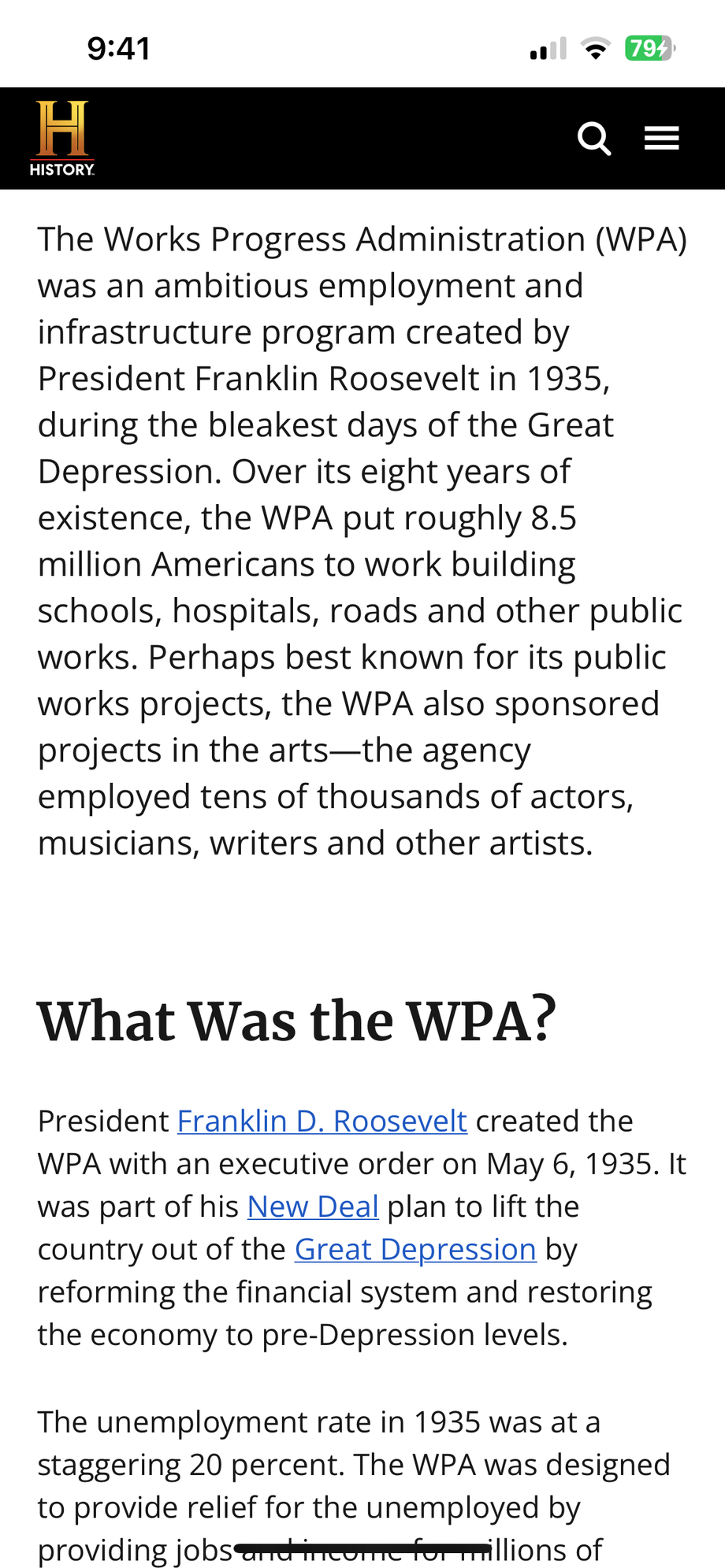

basically the same as WPA

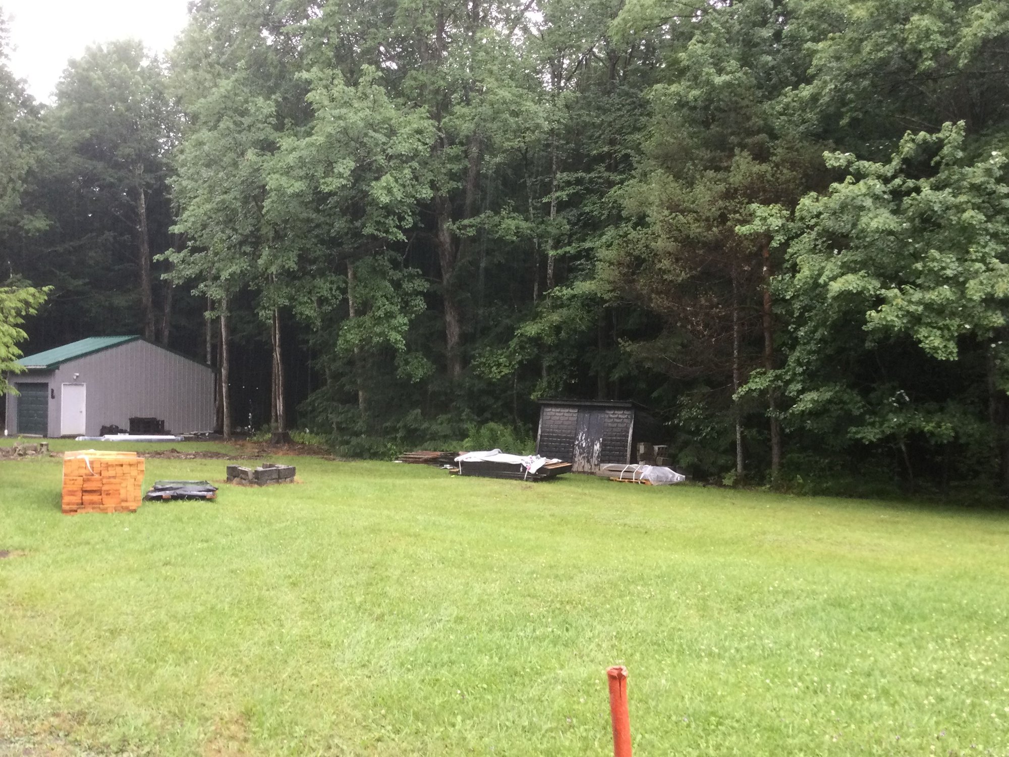

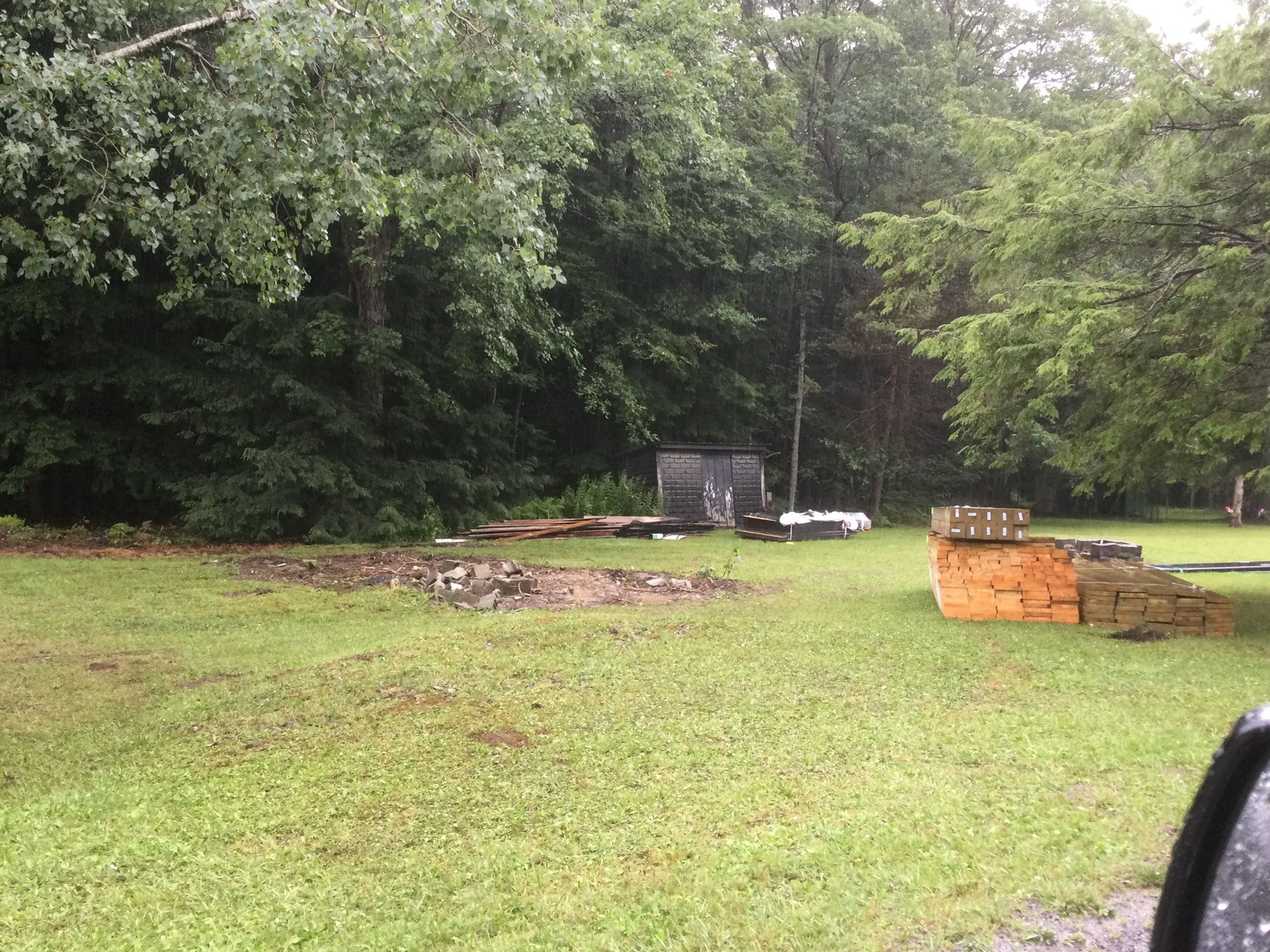

Well, I guess you guys were right. I drove by today and it’s gone. The builder said when he tore into it, it was too far gone. There were no studs in the outside walls, just the horizontal boards. I tried to post pictures, but it wouldn’t let me, and it would delete my text also. I’ll try and edit and add pictures later.
Edit, they still disappear a second or two after I hit upload.

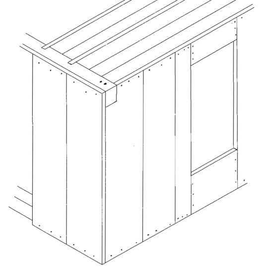

My guess is "Box" construction. It was popular until post WWI. Now they call it "Vertical Plank Wall" construction. It was cheap, easy, and there was no need for a hollow core because most houses didn't have insulation, plumbing, or wiring.
Look ma! No studs!
It usually had siding or batts on the outside, and wallpaper on the inside. Sometimes the wallpaper was paper mâché. Liquid starch and newspapers that were painted after drying.

No studs in the exterior walls??!! Oh my goodness!!! Hahahahaha. HOW did it even stand as long as it did. I think the owner just did themselves a huge favor on the rebuild timeline.

Remember, if this was a CCC workers' barricks or even a CCC office buuilding, it went up fast, cheap and not intended to last very long.

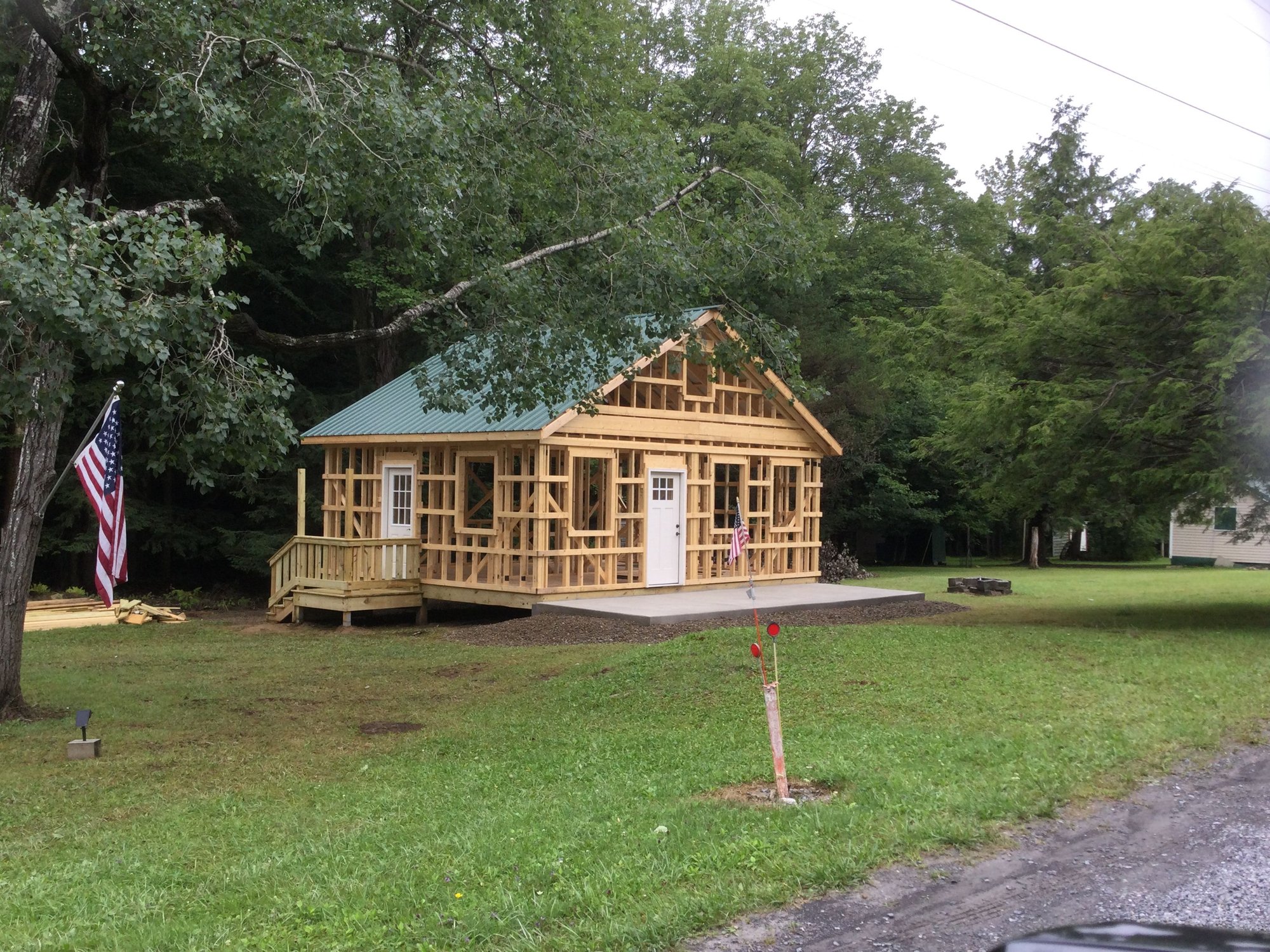

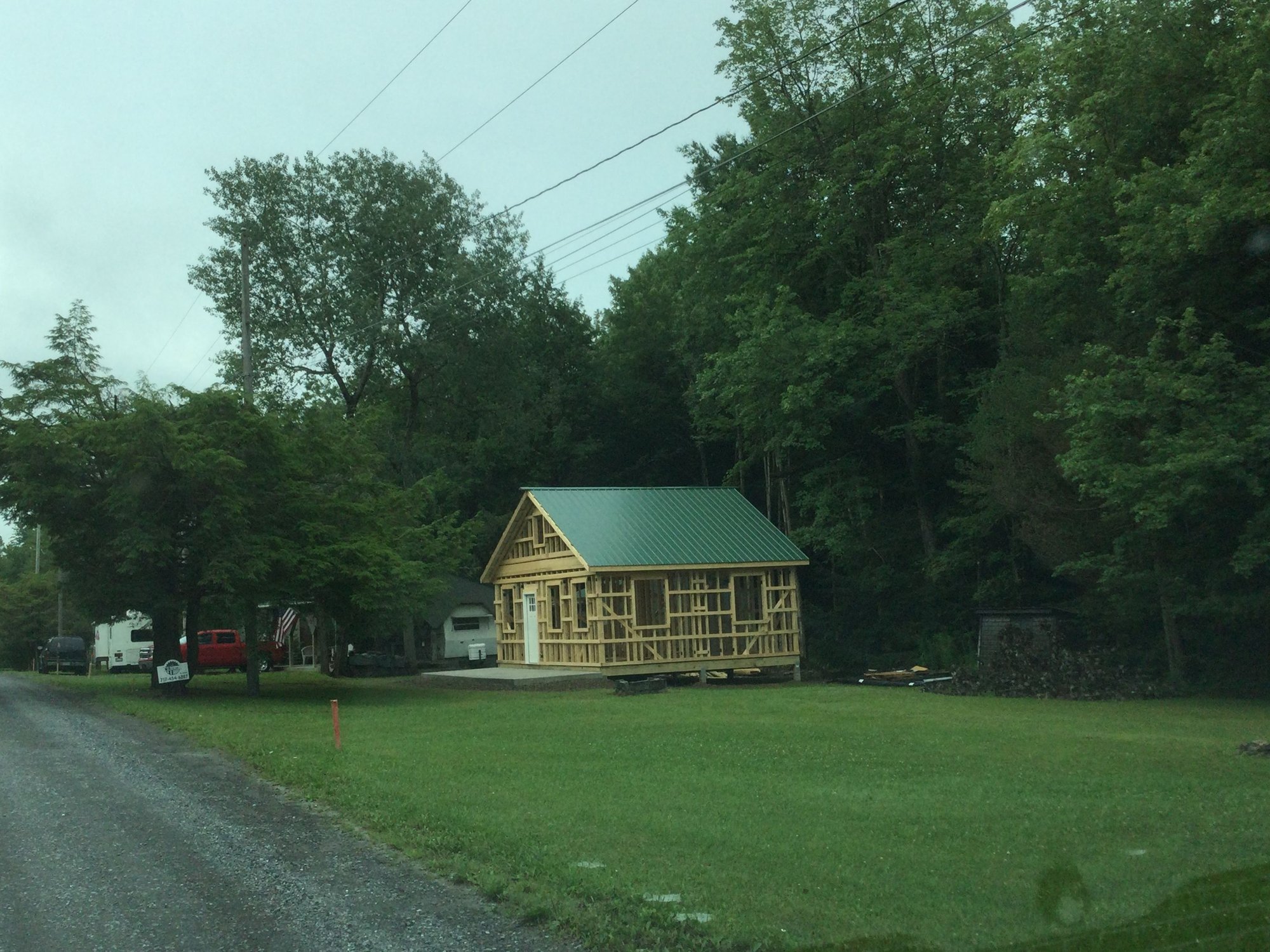

Well, before I hurt my leg, I got some progress pictures.
