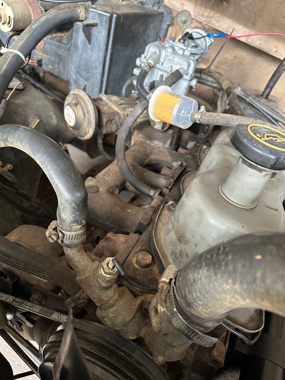

I took the line going into the carb off that looked pretty good though. it might not be putting out enough? I’m assuming if the fuel is there it is enough. Here is a video of that.
the gas the fuel pump pushed up
I tried adjusting the timing by advancing and retarding the distributor but I still couldn’t get it to crank. I think most of what it was doing was the starting fluid. Here is a video of that.
Old Jul 2, 2024 | 11:33 AM
FuzzFace2's Avatar
FuzzFace2
Posts: 30,886
Likes: 4,119
From: Angier, NC
Ok from what I have seen the volume "I" dont think is enough.
It should have 3x that amount for for the 3 or 4 pumps I saw push out.
What was wrong with the old pump? I know you showed the 2 pumps side by side but I cant say the smaller new pump would be the cause?
Get some 5/16 fuel line and replace the hose from tank to the hard line.
If you have dual tanks do them both. Also if dual replace the 3 hoses at the switching valve on the frame.
Last replace the hose from the hard line to the fuel pump.
It could be the hoses a dry rotted and sucking in air but not leaking fuel. Yep had that happen on a car hose from tank to hard line.
FYI I replaced a fuel pump because I thought it was bad and it was not.I was trying to use 3/8 and even with 2 clamps it would not pull fuel from a can on the inner fender.
Also it looks like the choke is not closing. Being the motor is cold the choke should be only open maybe 1/8"
This could also be why it is hard to start or not stay running. But the fuel above it the biggest that I see right now.
The timing I see you really go to town on the hold down.
You dont have to go that tight and if trying to "dial in" the timing you dont want it that tight.
Loosen it so it takes a little bit of power to move it. but not need to use tools to loosen the hold down.
As long as it dose not turn on it's own you can leave it that way. Mine has been that way for years now.
But what I see if you can get fuel into the carb so it had some to run off of, the choke closed (maybe idle turned up?) she should start and run as it is so close right now.
If you can fill the carb float bowl, hook the fuel line back up she may run long enough to pull more fuel from the tank if the hoses are good.
To fill the bowl you see that little tube sticking out in the carb opening? That is the float bowl vent and if the float was not to close off fuel when full the gas would come out it and go down into the carb & motor flooding it and motor stop so no more flooding and you would then look into why it stopped.
Find something you can put in the tube and fill the bowl. This way when it starts it has more to run off of that what you spray into the carb.
Dave ----

last year around August I changed the fuel pump for giggles it did run fine after that. I’m not sure what other pump you seen lol
THIS⬆️ I just replaced that hose coming off the tank with a 3/8 bc I ran out of 5/16 I’ll try to change it tomorrow and buy it before I go into work. Fingers crossed lol
I’ll have to do some digging on adjusting that carb i appreciate the feedback. Ill also try to funnel some down that vent tube tomorrow before I try it
My bad I am working 2 different "no run" issues on the 300 six and got them mixed up
Yea change that 3/8 hose for a 5/16 and do the rest like you said and I bet the fuel volume will be better and motor will run.
