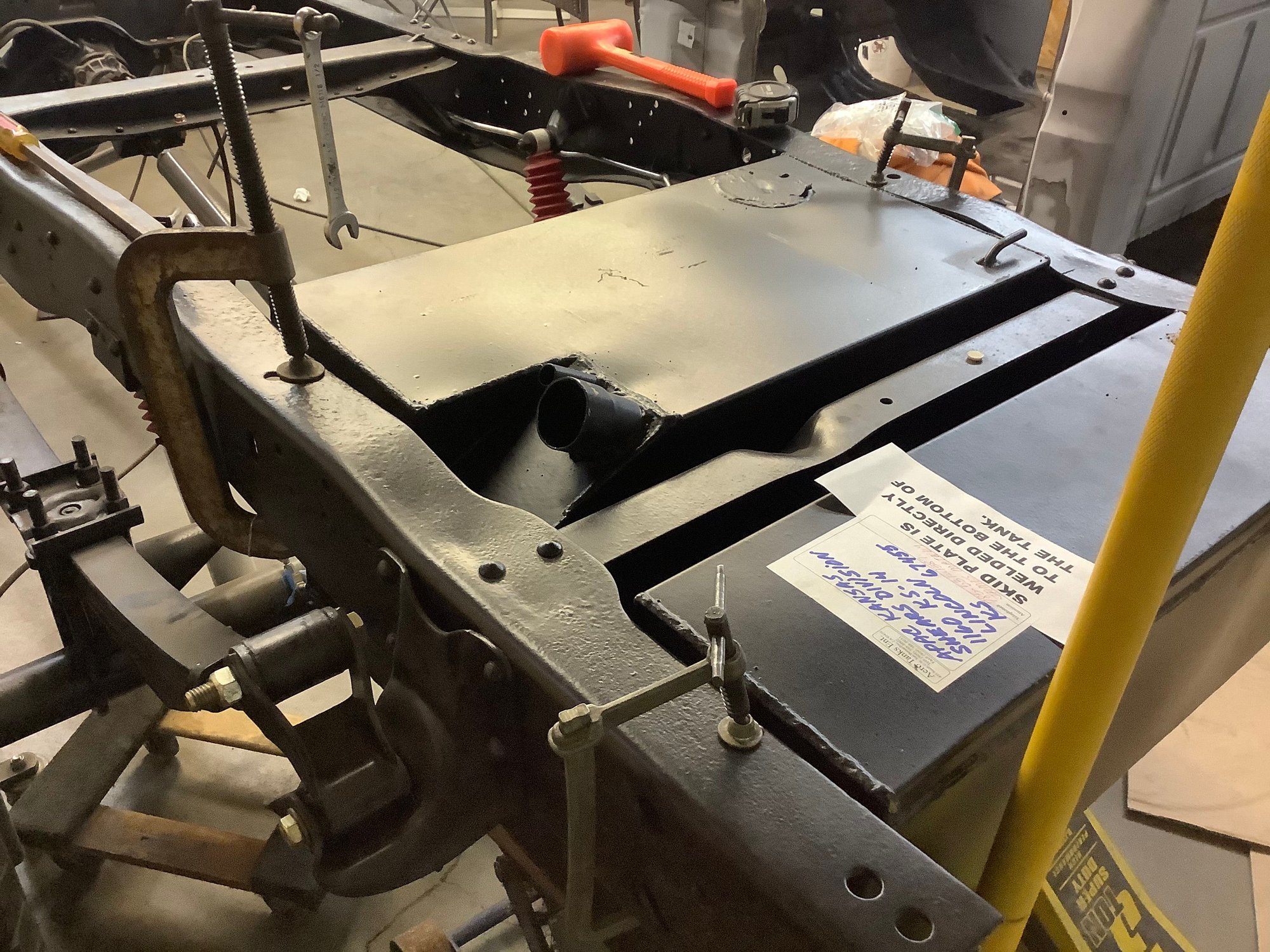

Hey everyone,
In the process of installing one of Aerotank's highboy specific fuel tanks under the bed of my '76. I had them prep the tank for EFI for my turbo build, which involved them adding an opening and providing an in-tank fuel pump "cartridge" with pump connections, outlet, and return lines. While attempting to install the tank today, I got the rear mount tabs on the frame, but the front was stopped solid 1.5" away from the frame. I found that all the lines and wires for the EFI kit are shoved up against one of the longitudinal bed spars, preventing it from going up any higher. With where the flange is for the pump, indexing the cartridge to one of the other 6 positions would notfix the problem, since it's almost directly centered under the spar.
I have an email out to aerotanks about it, but I'm wondering if anyone else has run into this problem with their tank? I feel like I've heard about a lot of these being installed over the years and haven't heard of a problem like this. Honestly it looks like the main body of the tank might not even clear if the pump wasn't there, but hard to tell.
Thanks!

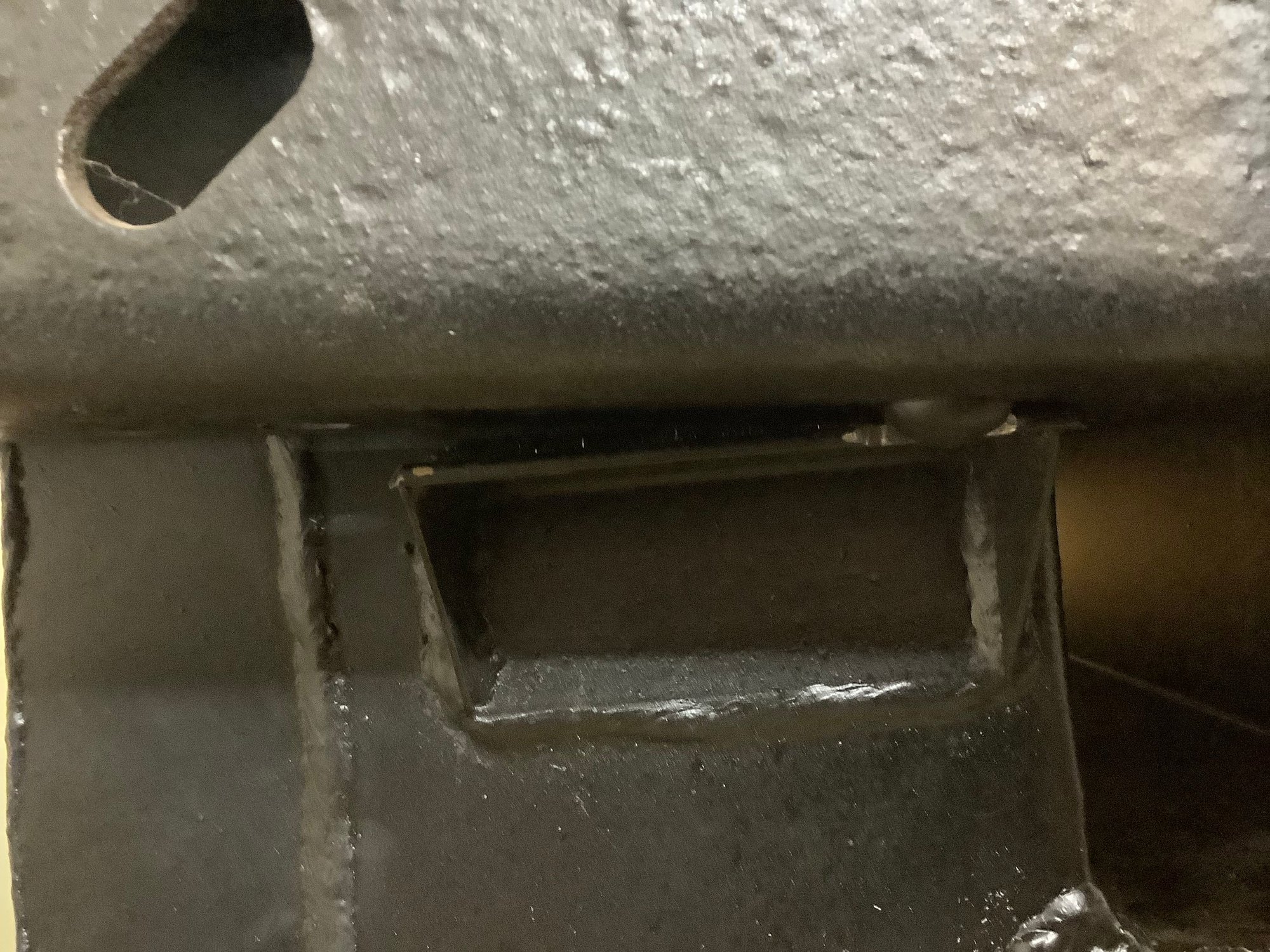

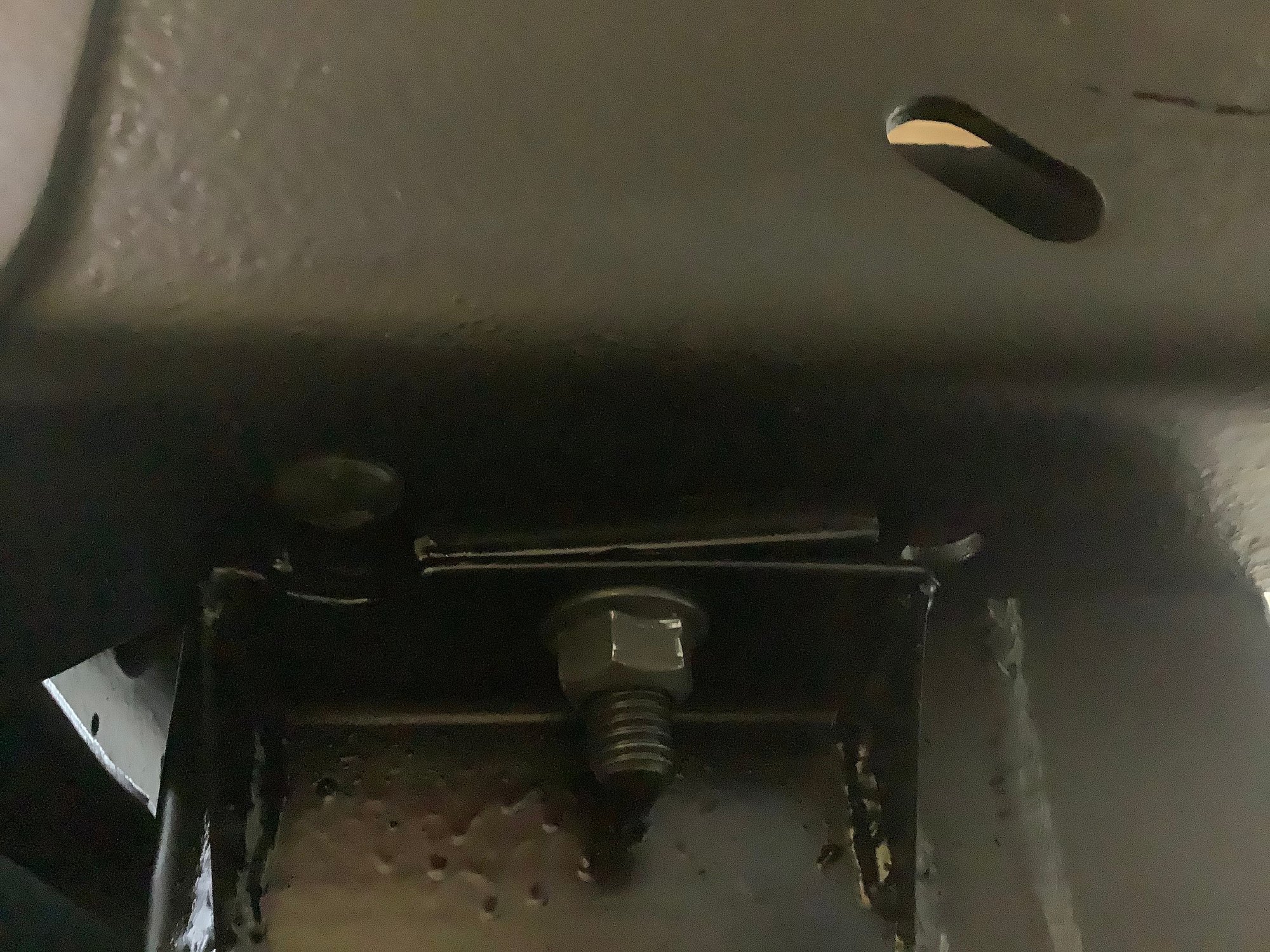

Originally Posted by 73 hi-boy 428 fe
you will need to shim the tank. Not as good a fit as you would expect for the money! Just like all builds nothing is easy, if it was we all would be driving home build perfect rides.
Hm, I'm seeing similar comments elsewhere. For as long as Aerotanks has been selling these (and like you mentioned, how much they charge), I'd have thought this would have come up. I'm going to wait until I hear back from them directly, because sometimes mistakes happen and maybe something is in the wrong spot.
But your photos did answer another question that I had which was if others had their brackets hitting some of the rivets on the frame. Much more minor problem, but still glad to know it's not just me being dumb lol
