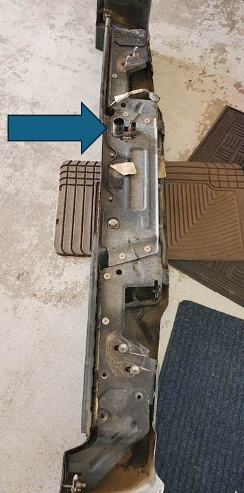

Below is a photo I took a few days ago when I was doing some preventive maintenance on my bumper. This is the back side of the 7-pin receptacle that is part of the bumper. It was packed with grease from the factory. You can see corrosion on the tips of the leads. I sprayed the heck out of the male side, cleaning the leads and all the grease. I then repacked it with grease. I was NOT getting the Trailer Disconnected message. But I suspect that if I had let it go on much longer it could have happened.
Just to clarify, below is a photo of the backside of the bumper with an arrow showing where the receptible from the above photo is located.
