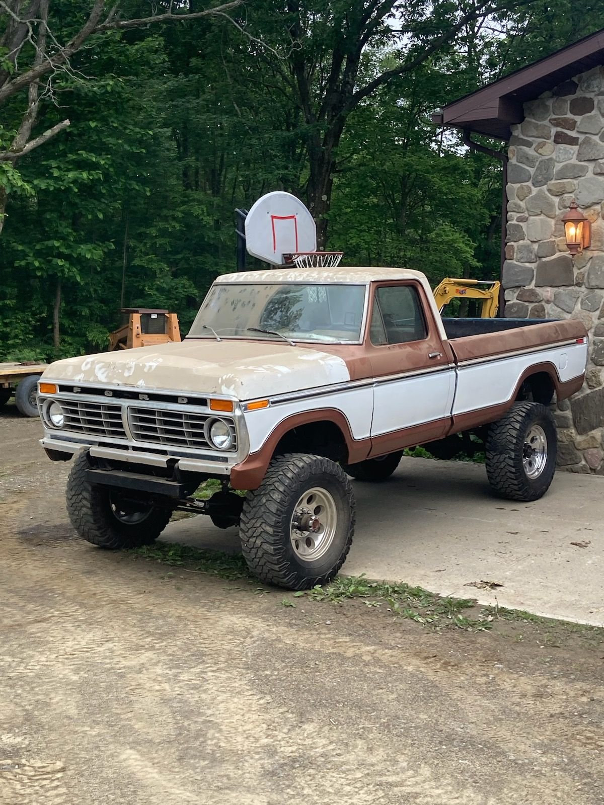

It’s time for wheels and tires on my 78 f150 project. I know the ones I want, I just can’t identify them but I see them often. Does anyone know these wheels ? This is the exact look I want on mine.
thanks!

Either Mickey Thompson Classic 3's or Pro Comp 1069's

Doosenberry is on it! I have the same on my truck. Here's what I ordered.
www.4wheelparts.comPro Comp 69 Series Vintage Wheel, 16x8 with 8 on 6.5 Bolt Pattern - Polished - 1069-6882
PXA1069-6882
QTY: 4
Price: 523.56

Thankyou! I can’t wait to not have to air tires up everytime I want to drive it at this point. Would you guys say those are a 33” tire ? I don’t want to lift at all ? I would like to stay factory height.

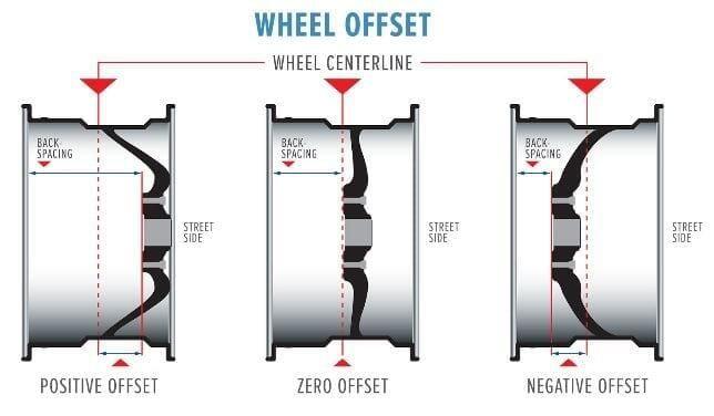

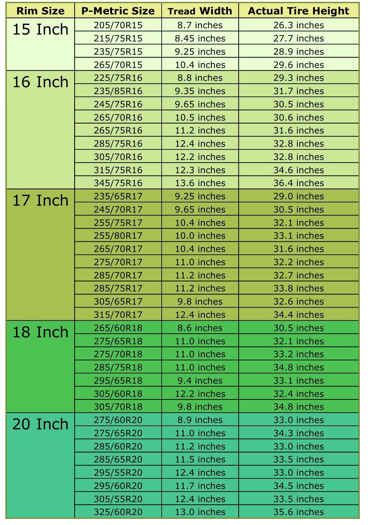

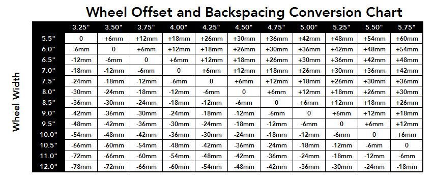

I am guessing that 33's might be a bit tight for an all stock 1/2 ton (with no lift). Also might depend on the off set/back spacing you get on the rims.
33x10.50's or 33x12.50's ?

Not gonna work out
Go with 285/75/R16. 33s will rub a little. I have a late 77 4x4 F250 and 33s were rubbing. I'm running Firestone Destination MT/2.

Here are some handy charts to consider.
that looks about perfect. 285/75/r16’s it is! I don’t want any lift. This is about the perfect look for me. Now to find the wheels mentioned above in stock. First searches showed them backordered everywhere.
