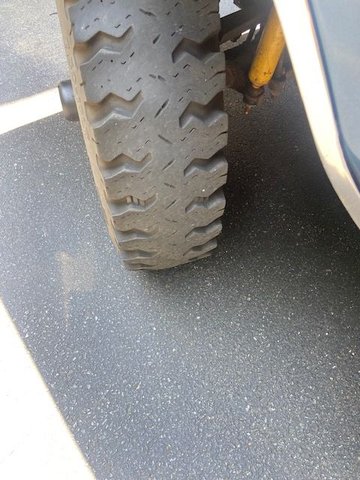

1975 F250 Highboy with FE360 and C6 transmission. Front end is a DanaHD44 with closed knuckles and truck is 100% stock as Ford built it. I am located in southern NH
Front tires have worn unevenly after about 10K miles to the point that I need replacements.
Yes I should have rotated them and/or dealt with the issue sooner but I didn't and now I get to purchase two new tires.
Are todays alignment machines at VIP , Pep Boys or any of the generic big box tire stores capable of aligning this front end or should I be seeking out an old timer who worked on these trucks
"Back in the day" ?
Do these axles have all the same adjustment capabilities, caster, camber, toe in toe out as modern axles?
Thanks in advance for any advice/guidance.
Tbruz
Passenger side
Driver side

If you can post a picture of your tire wear someone on here can probably tell you whats wrong.

I would look at the tires, left versus right and see what tire has the worse wear and it is on the inside or outside. That can sort of ID the problem side to look into harder. Then X2 insp the ball joints (upper and lower on both sides) and then tie rod ends. I am not fully experienced with closed knuckles, so bear with me.
But also a combination of a little bit of play from bad/worn ball joints (or even 1 side), a little worn tie rod end/ends, loose or not tight tight wheel bearings, and or some worn steering components (like the steering box). Even a set of bad shocks, can add up to a front end tire eater. Yes you should of at least rotated the tires, but this way you only have to buy 2 instead of 4. Also make sure you do not have a bent rim.

Found an old timey front end shop in Manchester NH that still has its old time mechanic1 to 2 days a week.
In fact they had a MINT 65 chevy pick up and a 53 chevy two door that was being worked on today.
Next week, they will inspect the front end and put it on their alignment rack.
First blush from them just looking at the wear pattern:
DS- lack of rotating tires, overinflation
PS- alignment issue, lack of rotation and overinflation.
New tires have been ordered.

Make sure when they tire machine speed balance them ask them to please they check the rims REAL close for any sign of being bent. Overinflation is as bad as under inflation. Remember that 4wd front tires always wear different than a 2wd front tires. Look at some tire vale stem caps that are low pressure indicators. As far as over inflation...that is on you and a quality tire pressure gauge. What size tires are you running?

Wow so not a big tire at all, you must have a bad ball joint or tie rod end for sure.

AS others, just guessing but,,, prolly over pressure and toe in too much.
Maybe it is the angle the picture was taken but to me it looks more like wareing in center of tire not so much on either outer edge.
Always fun to guess...with pictures.
