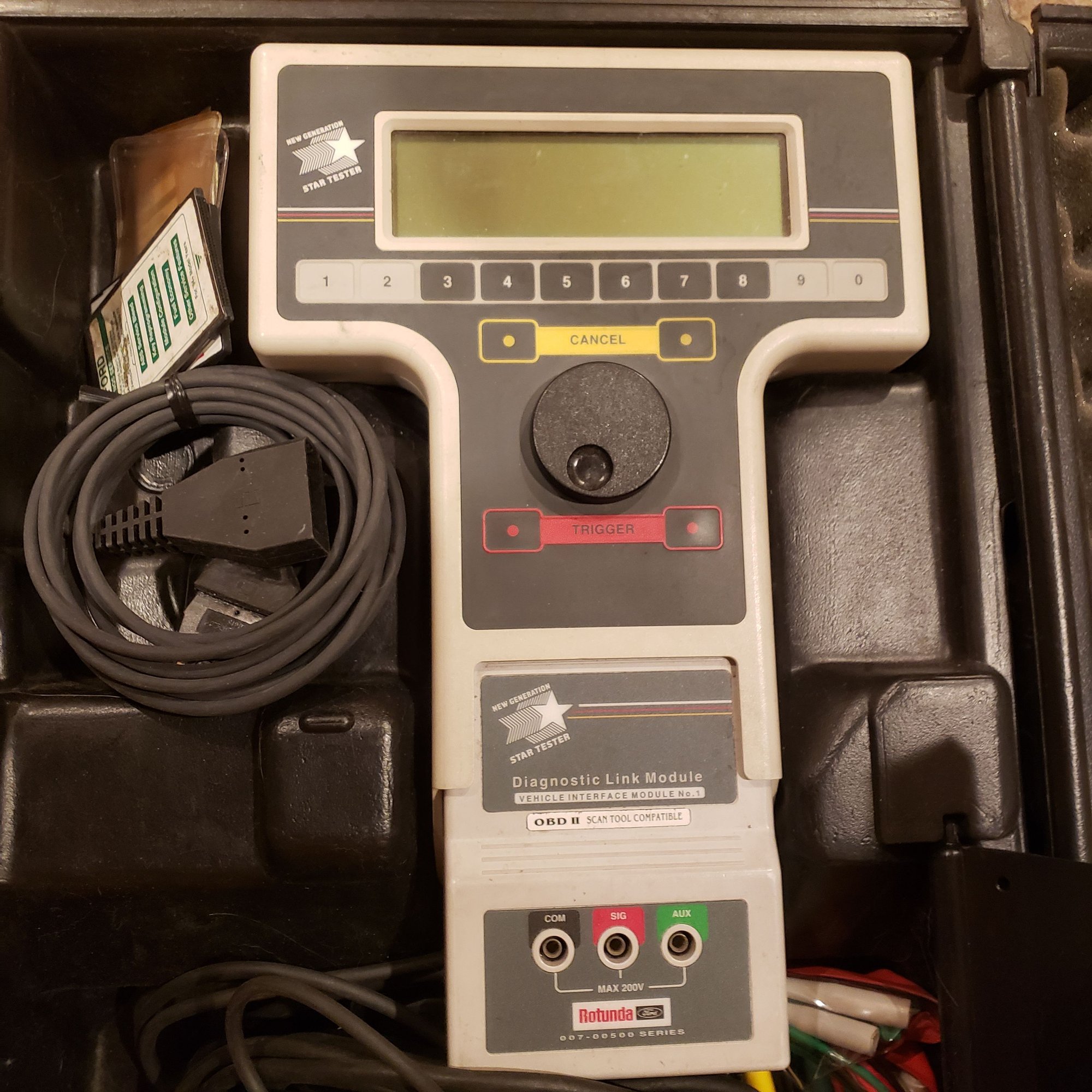

About a scan tool
I have 4
One that costs 40 bucks now, is better than one that cost 200 a few years ago
Get one that will read PIDS
That way you can check your fuel trims and watch your oxygen sensors switch
Not much goes wrong with 96 Broncos
The MAF sensor and the O2s need to jive
You can check a few pids against reference tables if you get a decent scan tool
This is your actual scan tool for a 1996 Ford Bronco, but they were 5500,00 back then and required support
