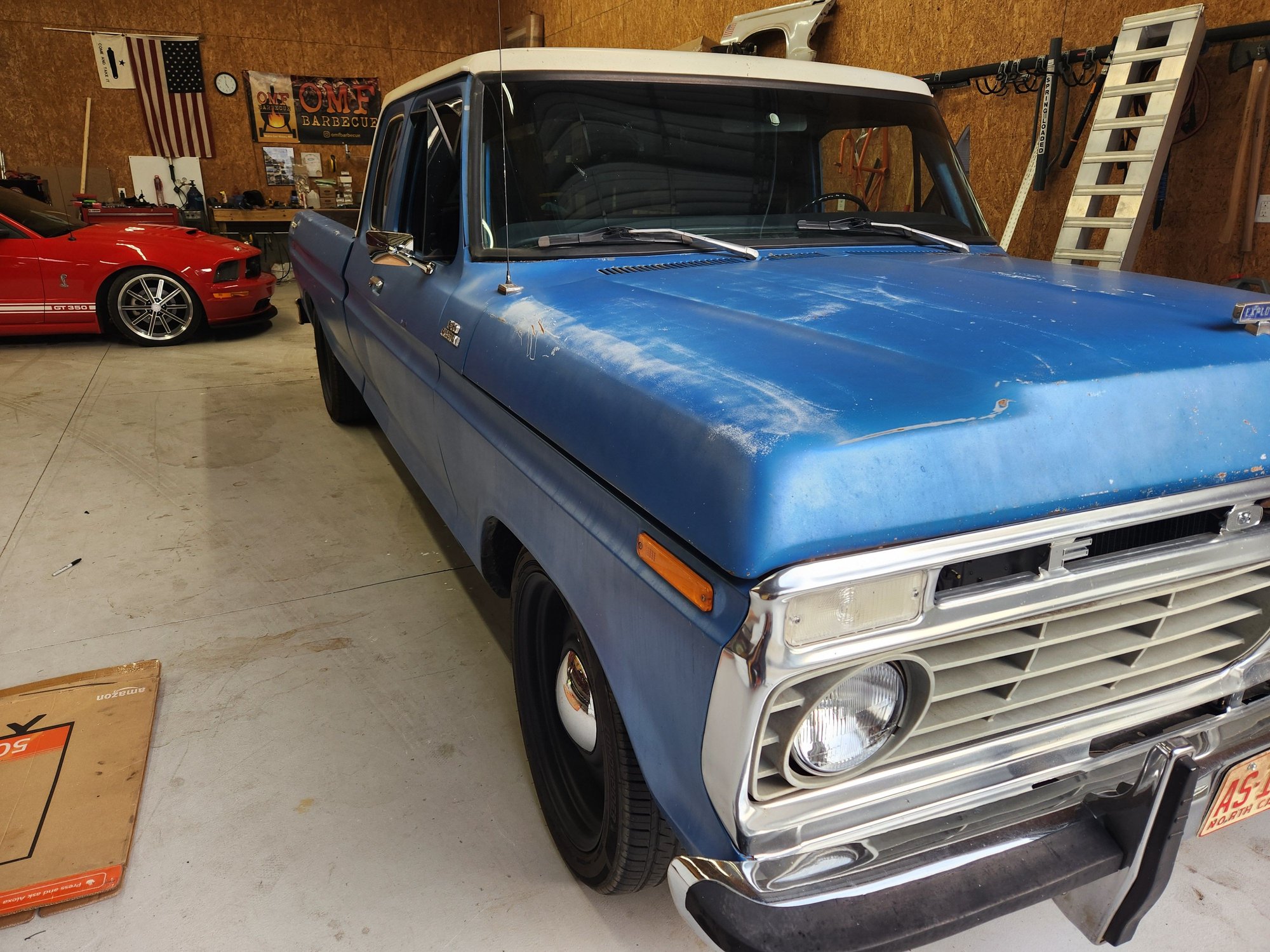

I just picked up a cool little 1977 F150 with a moderately built 351w and a crappy C6 that is slipping pretty badly between 1st and 2nd.
I like the idea of an auto for leisure and some towing, question is what is the best compatible transmission with an OD?
I leaning towards an AOD, but I am not familiar with all of the automatic transmissions that might be compatible.
Any help would much appreciated!
Pic of the truck cause we all love pics!
