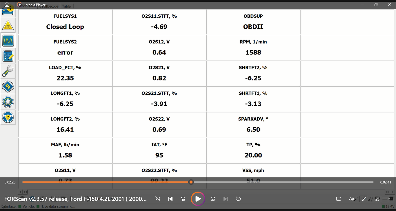

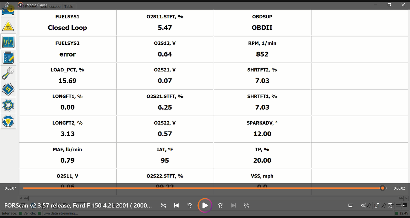

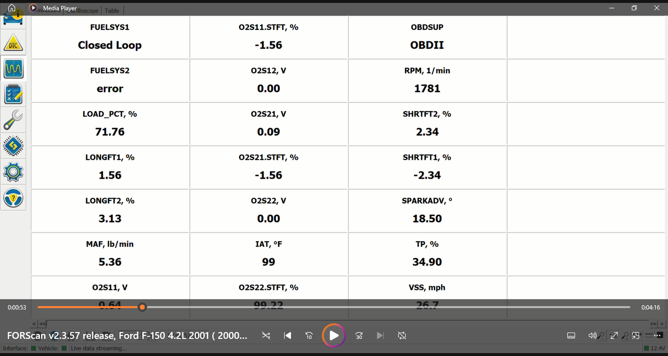

Scanner Results
Thanks. Attached are several screenshots showing data from the truck that I made a few minutes ago. It start at idle and then a trip around the area and back to idle. Needless to say if I knew how to understand all of these I would probably not be on here asking for help. Anything anyone see that can help diagnose? Thanks.
Idle 1 of 7
2 of 7
3 of 7
4 of 7
5 of 7
6 of 7
7 of 7

From: WA
Your MAF sensor readings are not right and don't seem consistent. Going from too high to too low at about the same RPM. Almost like there's a bug wing or seed moving around on it. The reading correlates to how much air is passing through the intake tube. One table shows 6.53 lbs/min at 1853 RPM, another shows 1.58 at 1588.
I'd get some MAF sensor cleaner and hose it down. It's easy and cheap.
