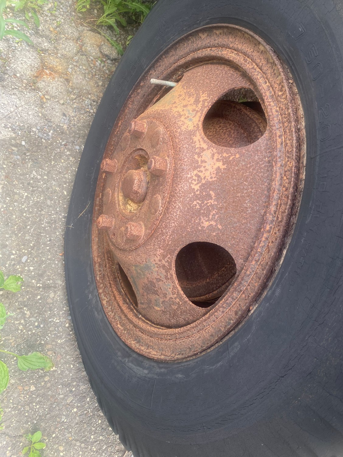

Widow Makers or no?
Truck beside the road
Widow Maker or no?

I can't readily tell, but the bolt pattern will not work on our Ford trucks...

No, not widow makers. But they won't work on a Ford. They have Firestone/Kelsey Hayes “AR” style three piece outer rims. The Chevy bolt pattern is a 10 x 7.25” circle with all mounting holes used on the rear. On the front you can see they mount blanking plates to cover the unused holes. Plus, they are hub piloted. Stu
