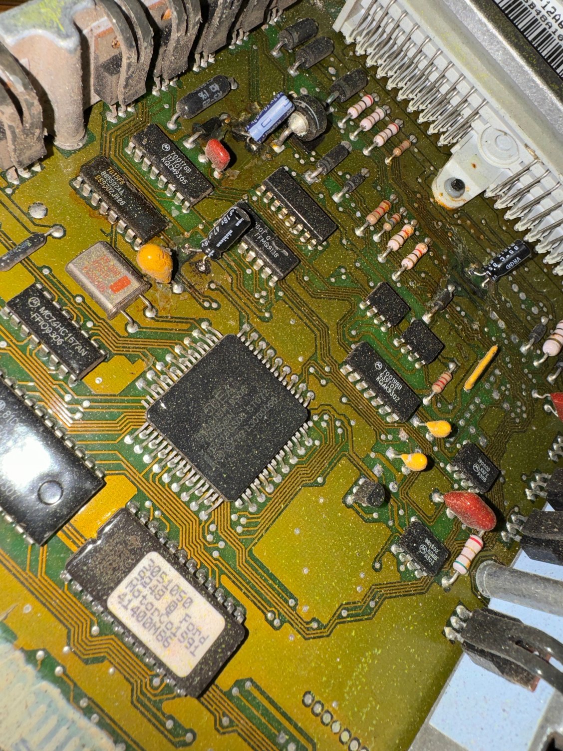

open yours got any burnt look

I had it open yesterday and it didn’t look like anything was burnt out but I’m not completely sure…
I won’t be back home till tomorrow night and I can send a picture of it then.

Posts: 6

Had the samw problem with mine. But with mine water was seeping into the unit watch out for that. You might wanna fix the leaked before you drop a few hundred on the pcm
where was water leaking from in ur situation?

it was leaking from the top of my hood down to my firewall
