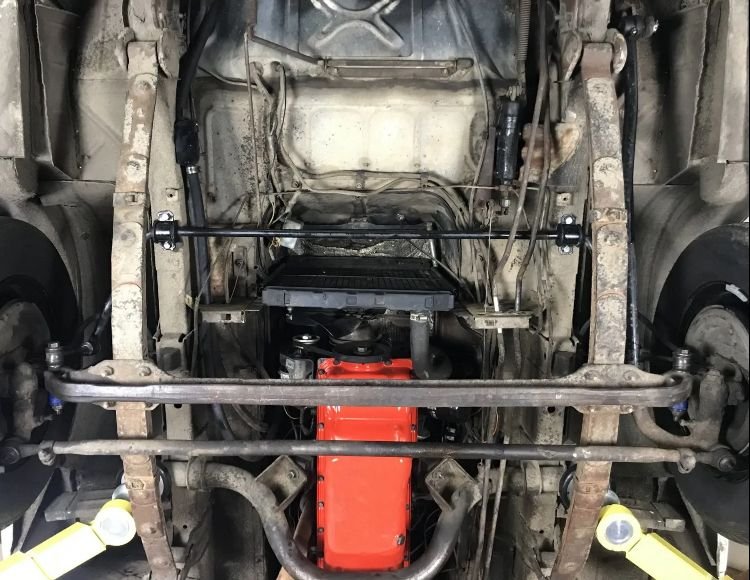

For the benefit of others, picture 255 provides an overview of the steering linkage: The pitman arm is in the upper right corner of the picture.
https://bringatrailer.com/listing/1965-ford-falcon-7/

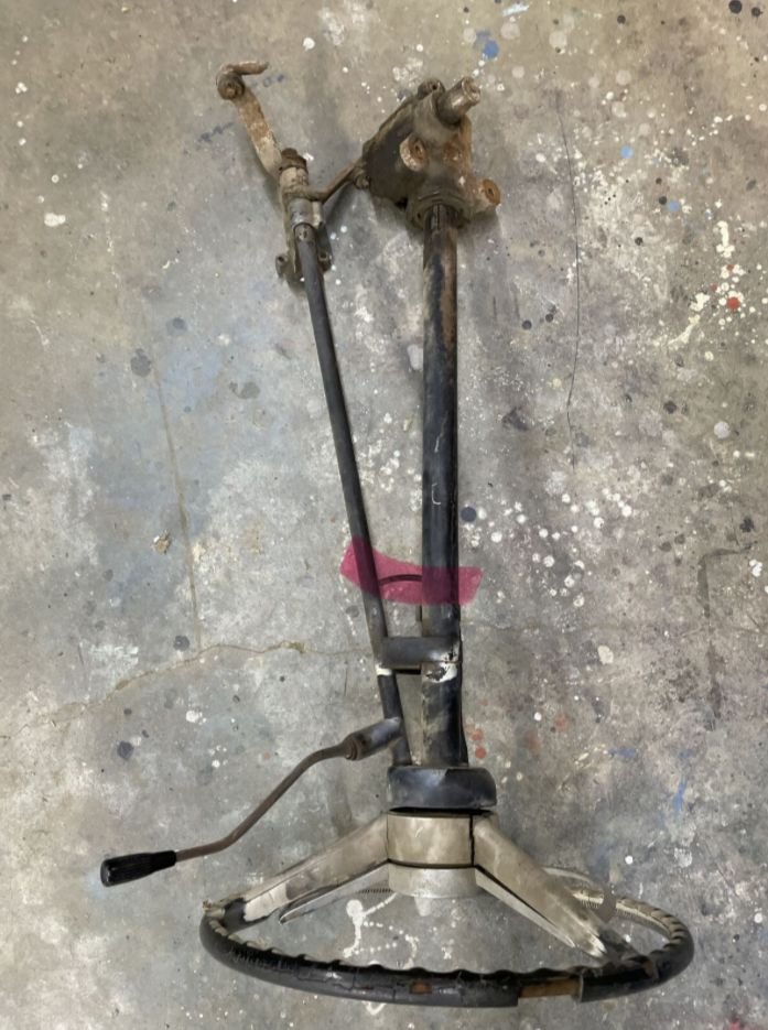

And here’s a picture of the steering column and steering box:
https://www.ebay.com/itm/255784859736
Looks to me like the pitman arm swings fore aft in this cab forward setup vs side to side in the F100. What’s a tie rod and what’s a drag link in this setup?
Assuming everything’s original in the truck/van, is it possible to mount the steering box 180* off? Does the output shaft have two exposed ends?
