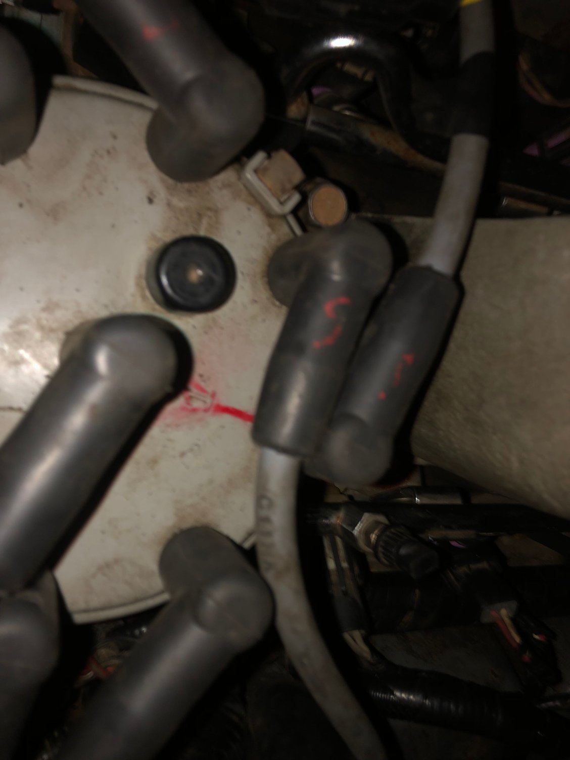

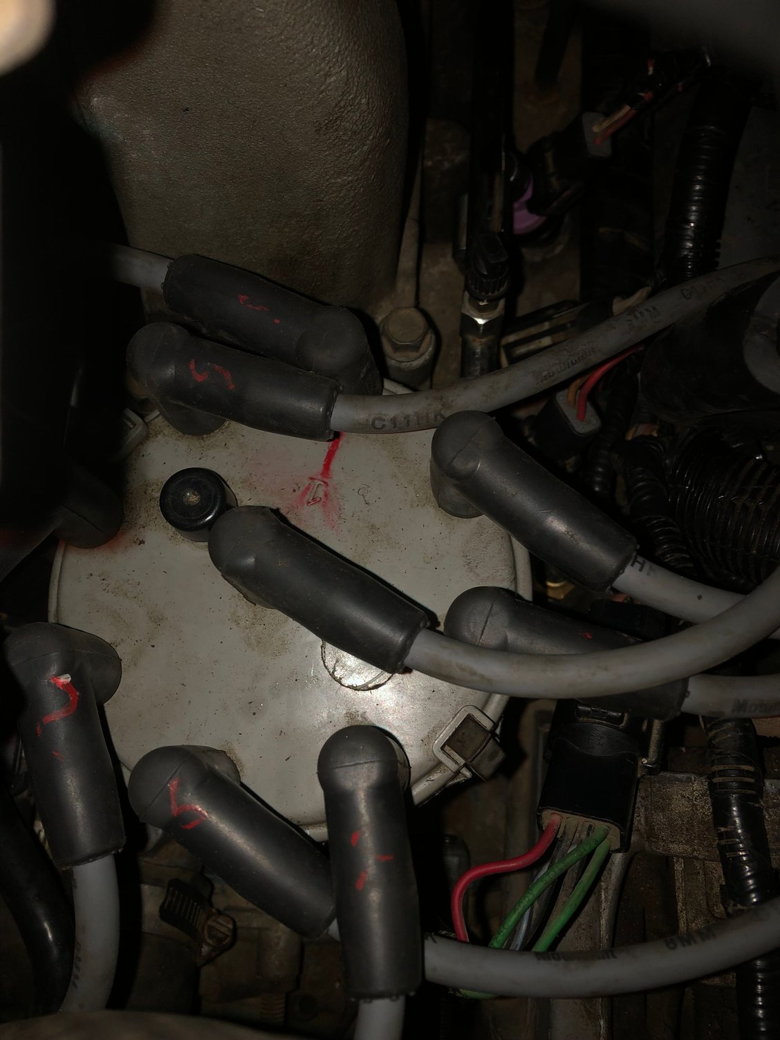

What spark plug wire routing and firing order did you use?
I just used the same firing order and I used the routing pretty close to that picture I just didn’t have the clips for the wires anymore.

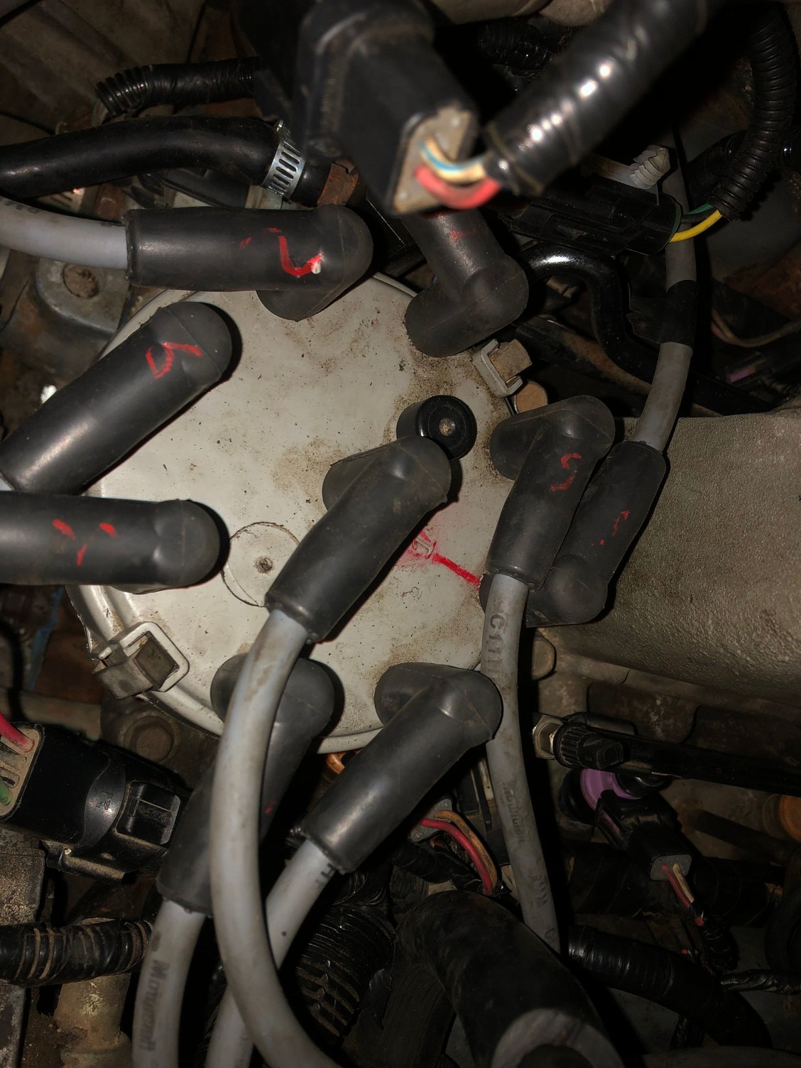

What
That’s what my distributor looks like

Originally Posted by Gustheobsford
I just used the same firing order….
I cannot read the numbers on the wires. The ‘92 firing order or the ‘94 order?
I went off the 92 firing order

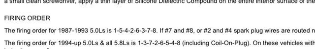

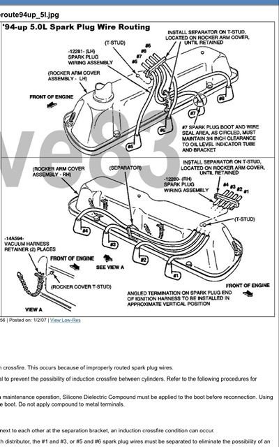

That is the wrong firing order for a ‘94 engine. Did you look at the TSB I posted?

I had a misfire on mine when I did the plugs and wires BEFORE I put the wire clips on to keep the closely firing wires apart from one another.

Posts: 53
I’ll switch it over later today
how was that causing it the misfire? Just curious
High voltage likes to jump.
Basically another wire is stealing the spark.
that could be a option I’ll check that
fire the truck up after dark and open the hook and look at the plug wires. if it's jumping, you'll see the spark moving
from wire to wire.
