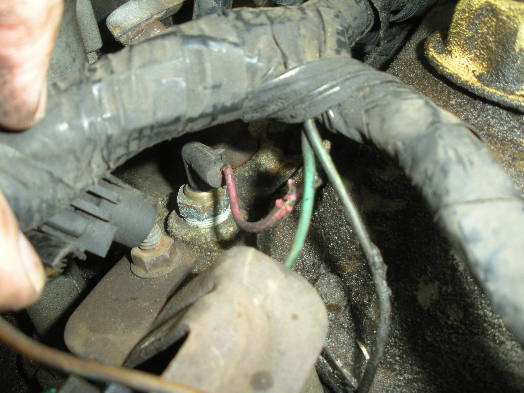

Temp sensor, here's mine from a few years back. The yellow thing in the upper right corner is the oil fill cap. Temp sensor is in intake manifold between #5 & 6 cylinders.
Make sure your's doesn't have teflon tape on the threads.
When you get it fixed, the gauge will rise above/to the right of the center. When the T stat opens, the needle will drop back to just the left of center.
Mine will go beyond the horizontal lines on that symbol on the gauge before dropping back.

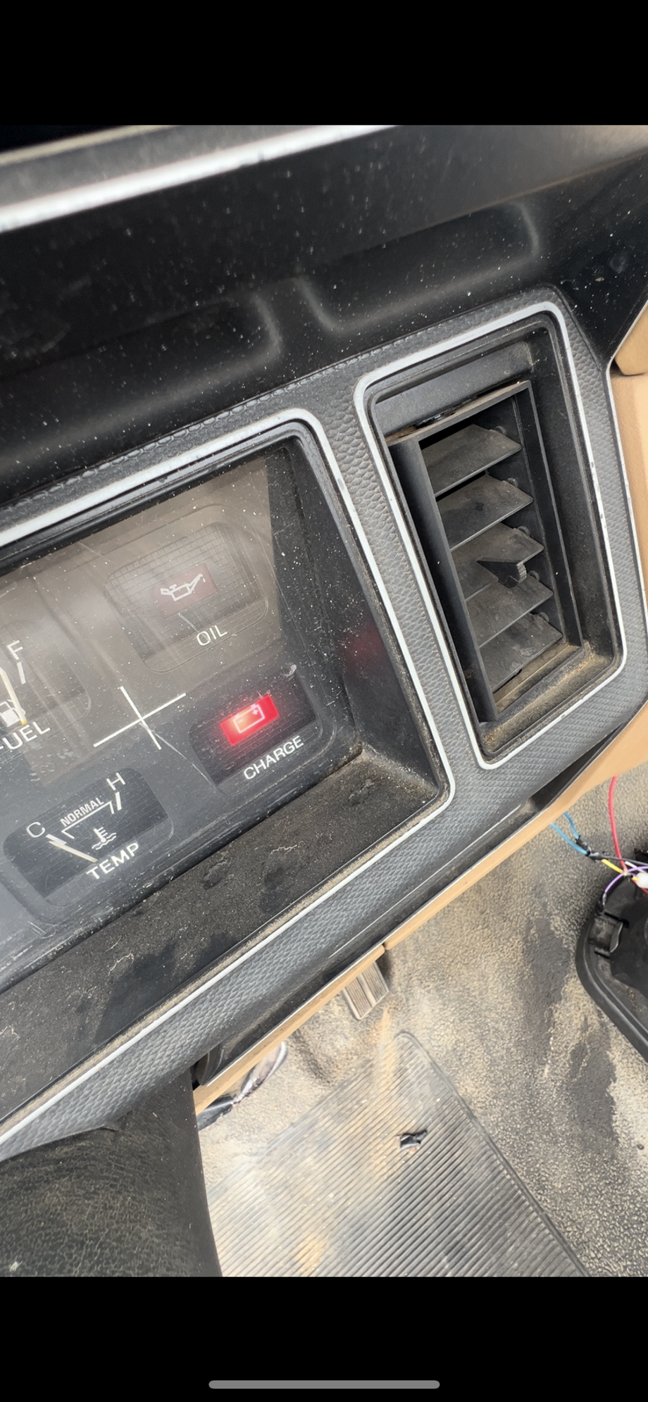

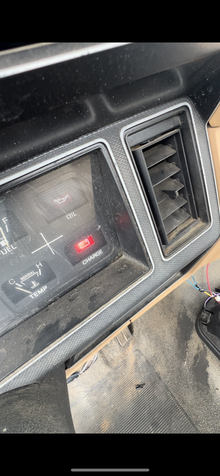

So i did the test grounding out the wire it barley moved
Before grounding
Grounded

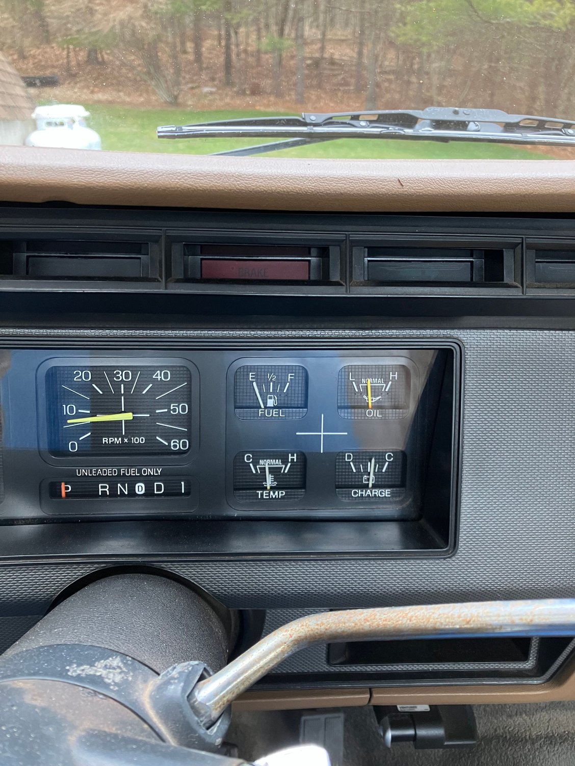

Where did you ground the wire? Did you touch it to the body of the temperature sender? If so, the sender itself may not be well grounded. That would account for the gauge barely working when connected normally and when the wire was grounded for testing.
I don't think the gauge itself is likely to be bad. They are pretty robust and lead a sheltered life inside the dash. And it did move a little bit, so that tells us it is not completely dead.
There is an Instrument Voltage Regulator (IVR) in the dash that powers the gauges. I see your fuel gauge appears to be working, so the IVR should be good.

So the fuel gauge works kinda.. it does have full range of motion and it does move but just last night it was reading full but took $50 of gas to fill up the tank.
