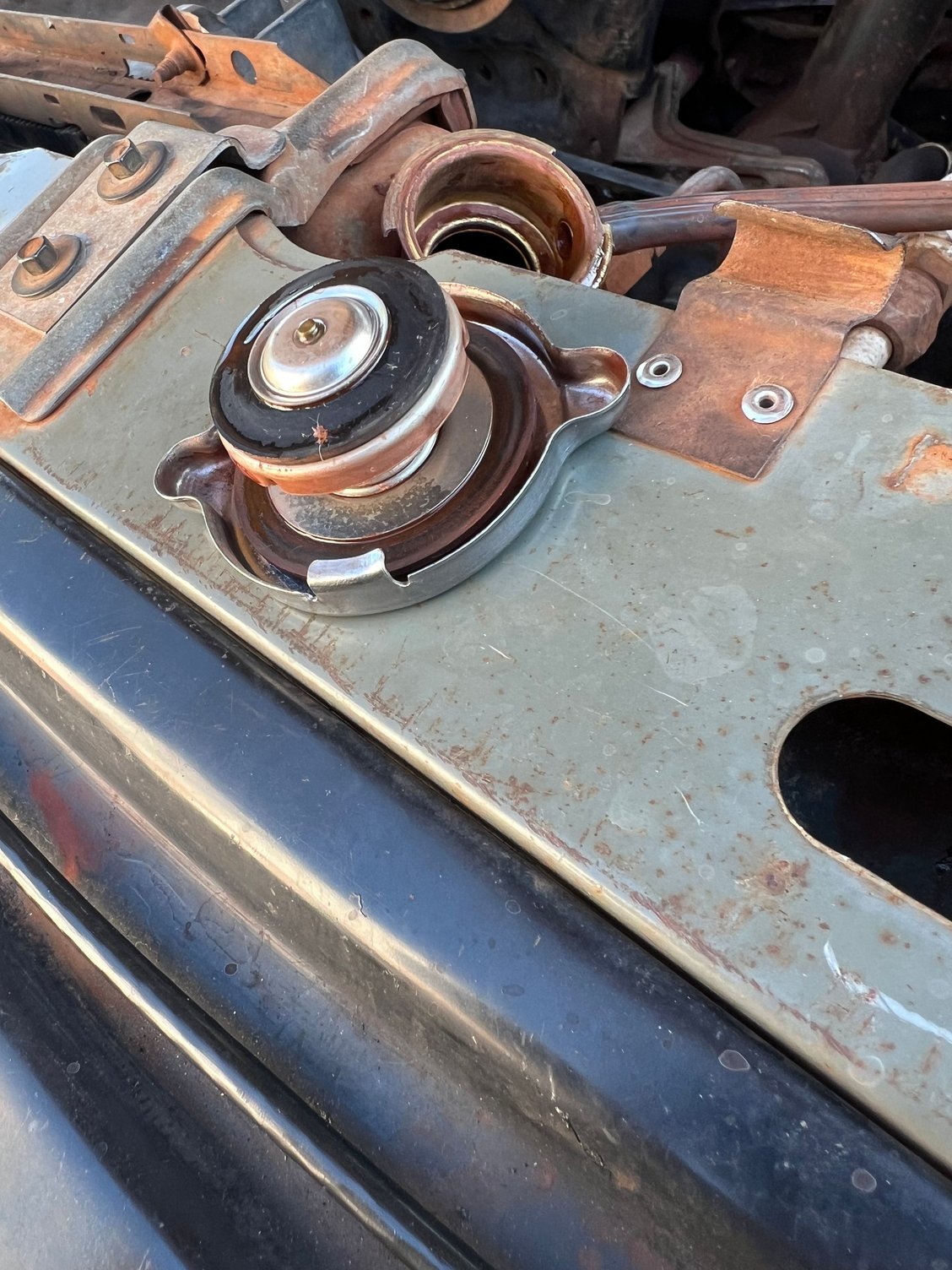

also here’s a picture of the cap.

Cap looks shot to me. Replace it. Consider the lever release type. Also a new truck to you maybe flush your cooling system. Is that rust I see on the cap? Gasket is cracked up.

I will buy a new one soon. And no, not rust just orange fluid from radiator.

I dont think the cap looks bad but will not hurt if you got anew one.
