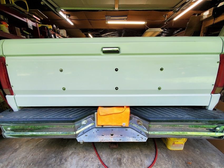

Hey Yall,
First post on here and hoping to get some help! I have a 1989 Ford F-250 XLT Lariat. I recently removed the back panel off of the tailgate and I like the look of it better without. Only issue is the holes. Do you all have any advice or know exactly what to use to plug those holes?
Appreciate it,

Sure! Put the panel back on!
(Sorry, but that was just too easy!)
I have no idea if there is such a creature out there, and you may either have to "make do" with something from the hardware store, or have them welded-up.

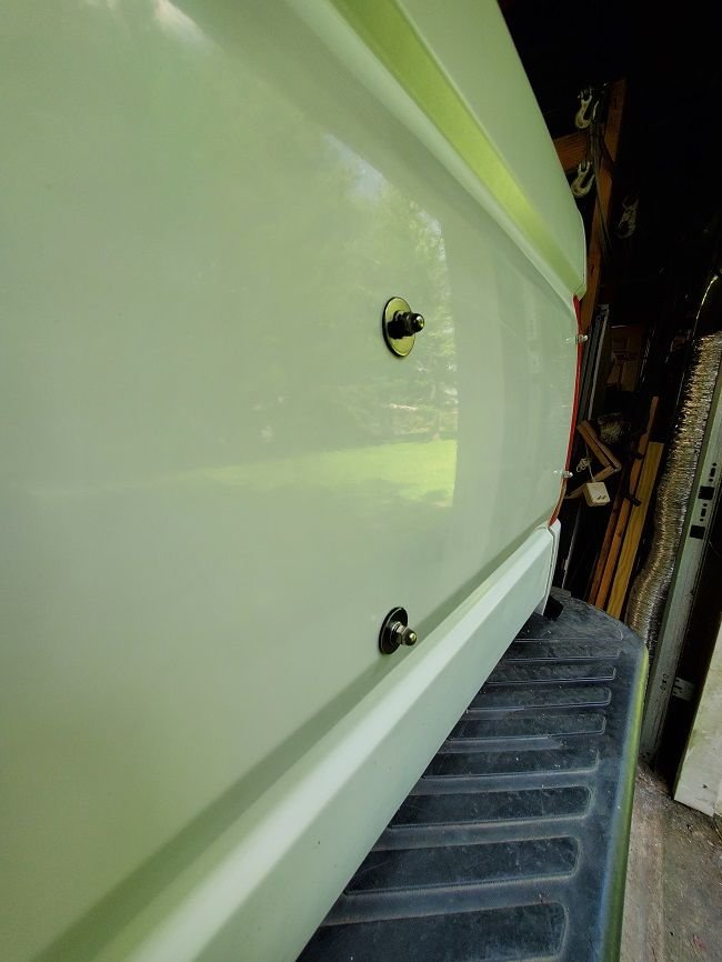

We had this discussion a few weeks back. Since then I've lost some pics including my solution so it's links instead.
https://www.ford-trucks.com/forums/1...ck-notice.html
My solution was SS machine screw, fender and gradually smaller washers capped with an acorn nut.
The biggest washer was covered with silicon sealant stuck to plastic & trimmed with an Xacto blade after it cures. Seals the hole nicely.
