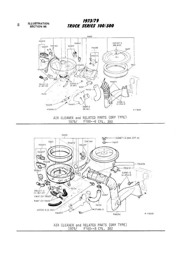

i'm trying to identify/find this item for my truck, or could use a picture of a complete one so that i might manufacture what i need

Intake heat stove. It mounts to the passenger side exhaust manifold and uses a piece of flex tubing to introduce warmed air into the snorkel on the air cleaner.

That above pic looks to be from a early Bronco (66-77) with a 302. Looks like you have part # 9A603. And yes Cleatus12r is correct on its function.

thanks, i finally have a starting place

i'n in nc, so far winters have not been in those kinds of temps, although got to 4 degrees once. found a picture in ford manual, thinking i can fabricate it if necessary
