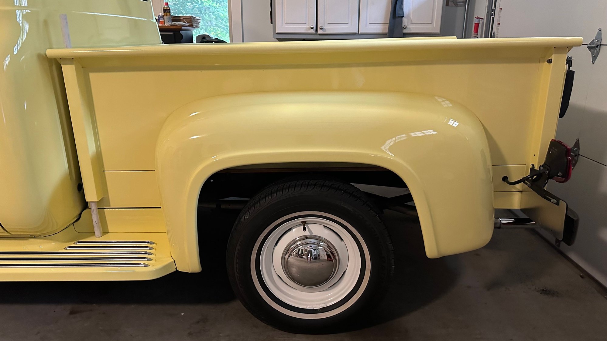

Finally getting around to my cargo rail project. What have people done for the front posts? As you can see from the picture there is nothing that stops the PVC pipe from going all the way to the running board.
I don't want the rails resting on the top of the bed.

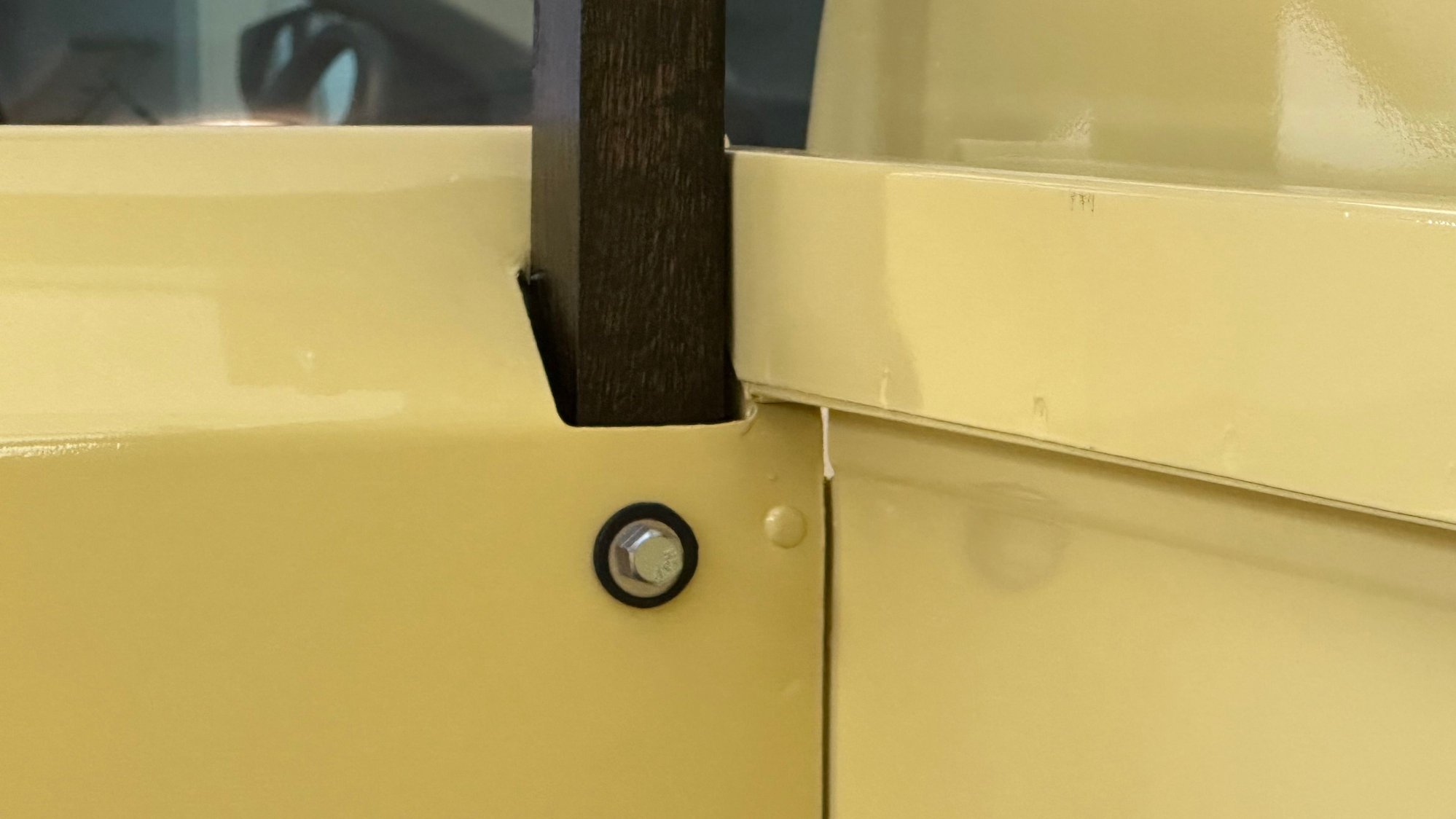

I did figure it out. Previous owner bondoed over two holes in the stake pockets where you should be able to put screws/bolts. Gonna drill those out and all will be good!

Bret, can you show us where those holes are?

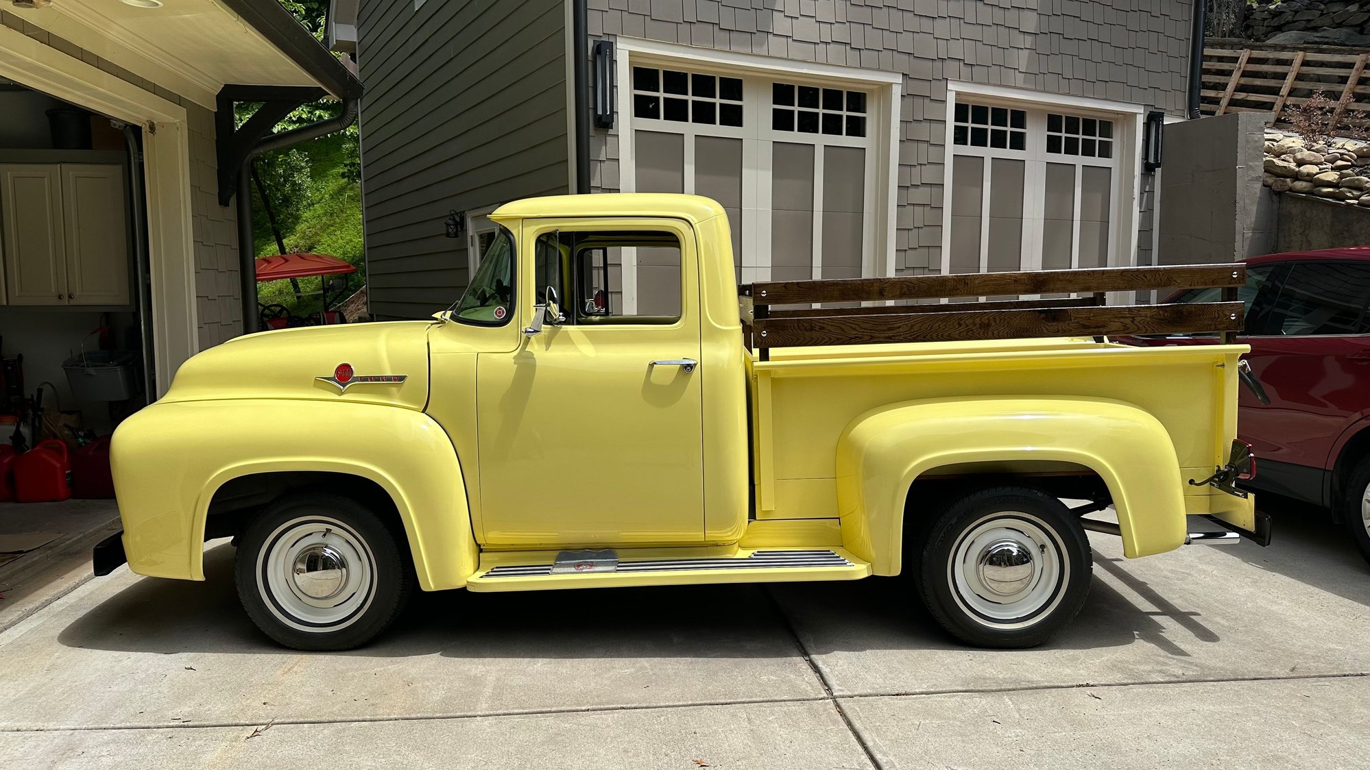

Sorry abe! Been way to busy.
and the finished product!
Stain was 50/50 Expresso and Classic Black.
Winter project will be redoing the bed to match the rails.

Thanks, Brett. The side rails look real nice.
The holes are not stock but they do hold the stakes in place.
