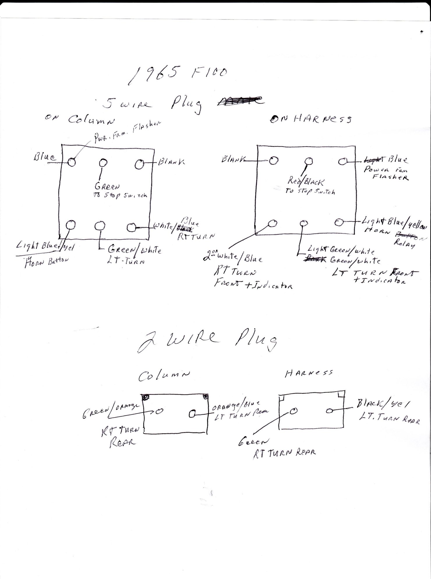

You may have ground problems but 99% chance the TS switch you have is no good, or you have it wired wrong. The ONLY switch to buy other than an NOS Ford is a Shee Mar. More Information for SHEE-MAR SM41F (rockauto.com)
Here is a wiring diagram 1965 Ford Truck Wiring Diagrams - FORDification.info - The '61-'66 Ford Pickup Resource
Here is a drawing I made when I was wiring my 79 column into the 65 harness if you can figure out my scribbles.

Okay so I will get to this around tuesday/wednesday, and hopefully reply by friday. As a note I don't have the original packaging but I'm pretty sure I have a shee-mar TSW? My first one the plastic is a different color, new one is the same coloration as shee mar and wires match the spots. It also came with a paper saying where each wire goes to fit the old wiring harness.
