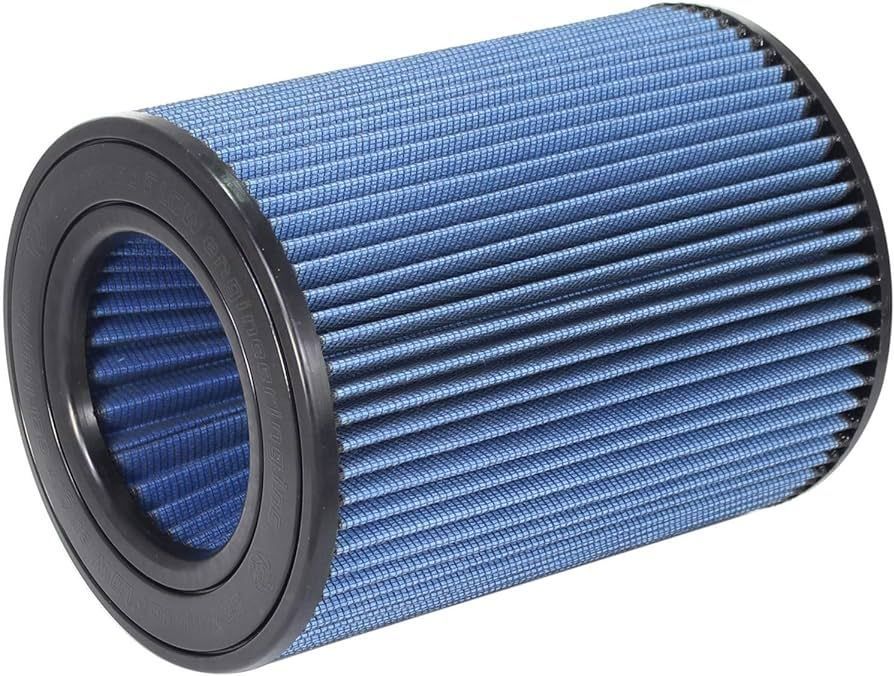

Even the 6637 will fill up with debris eventually. And the rim at the opening is taller so you can actually have something for the clamp to grab on to. What I ended up doing in the long run was to get an AFE Big Boost. Washable filter that is the same size as the 6637, then put it inside of a prefilter sock made of some pretty finely woven synthetic material that stops the chunks from getting stuck in the filter media.
EDIT: Not visible in the picture is a smaller filter of the same media built into the inside of the filter assembly to provide even more filtering area than the 6637.
https://www.riffraffdiesel.com/afe-b...shable-filter/

Here's a picture of the inside filter that I mentioned above.

IMO the blue Donaldson from Riff-Raff is the best slip on unit. In a pinch a regular white 6637 works and they are easy to find locally. AFE Big Boost sounded good on paper but it's construction was flimsy and the the clamp didn't want to stay put on the squishy and slimy feeling rubber. I also didn't like how it didn't have the lip-stop on the inside to seat the pipe in the right spot. Sent that back for a refund.
