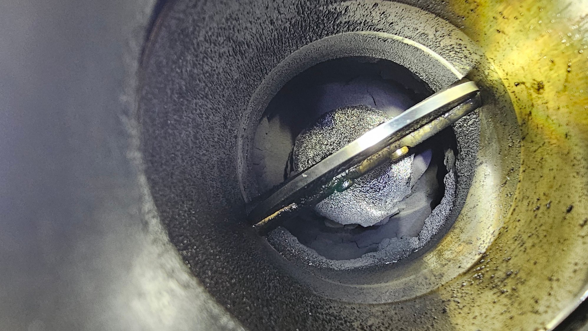

Kept getting throttle body faults on my 6.7 so I pulled it to clean/inspect. Wow what a filthy lower intake manifold. A combination of black soot and an oily substance mixed together to make a wet sludge. Built up to about 1/8”-1/4” thick.
Truck has about 98k miles on it.
any thoughts on if this is coming from the CCV or the EGR?

Here's mine at 90k. I've been told mine is cleaner than most. For whatever it's worth, I think my truck has been on 10W30 Motorcraft oil its entire life, and my idle hours are 1/3rd of my driving hours according to the dash. I still have plans to permanently fix this issue as soon as my truck is near end of warranty. EGR is going bye bye.

It is from the EGR and CCV. One way to reduce the build up is to remove the CCV and route the gasses to the rear of the truck, and cap off the opening into the intake. Adding a catch can may or may not help, depends on where the oil is coming from. The other way is to lose some weight, but that comes at a potential $45,000 fine. That round thing in the middle is a cone, the EGR gasses come in behind it. That "throttle" plate is used to block off incoming air so the gasses are sucked in.
