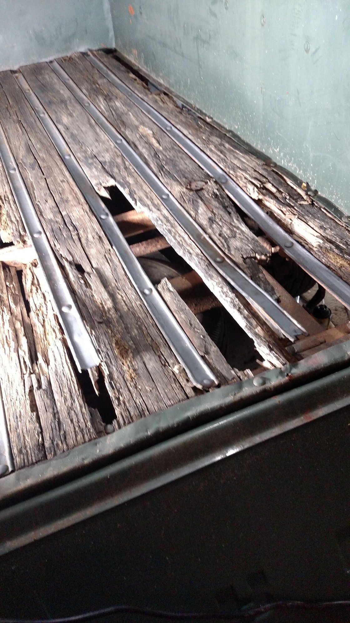

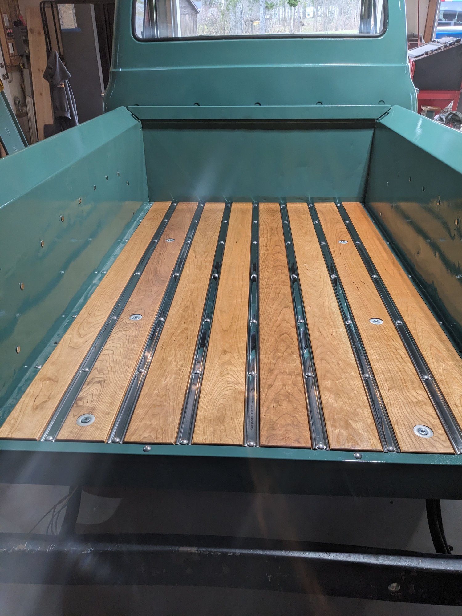

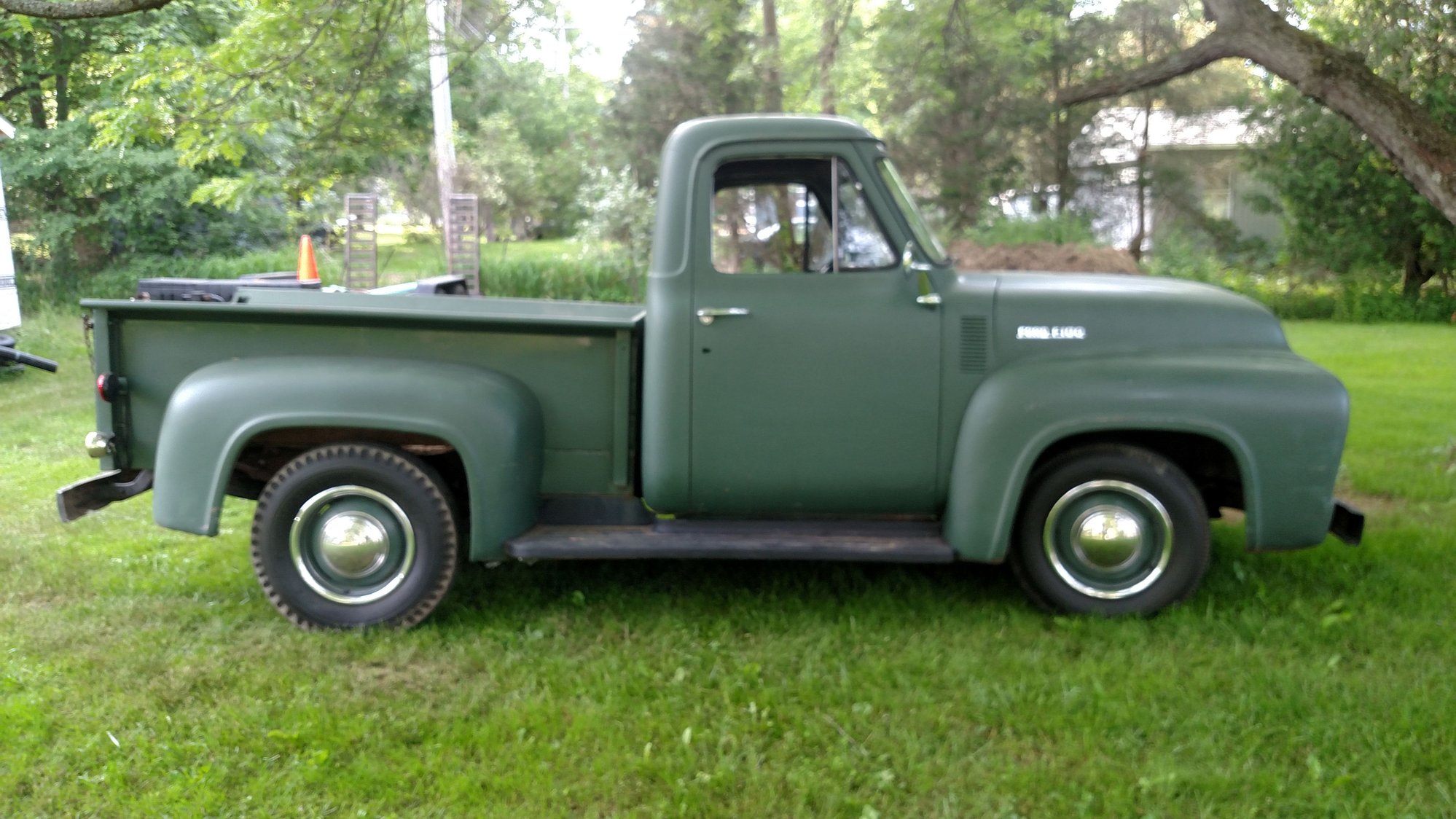

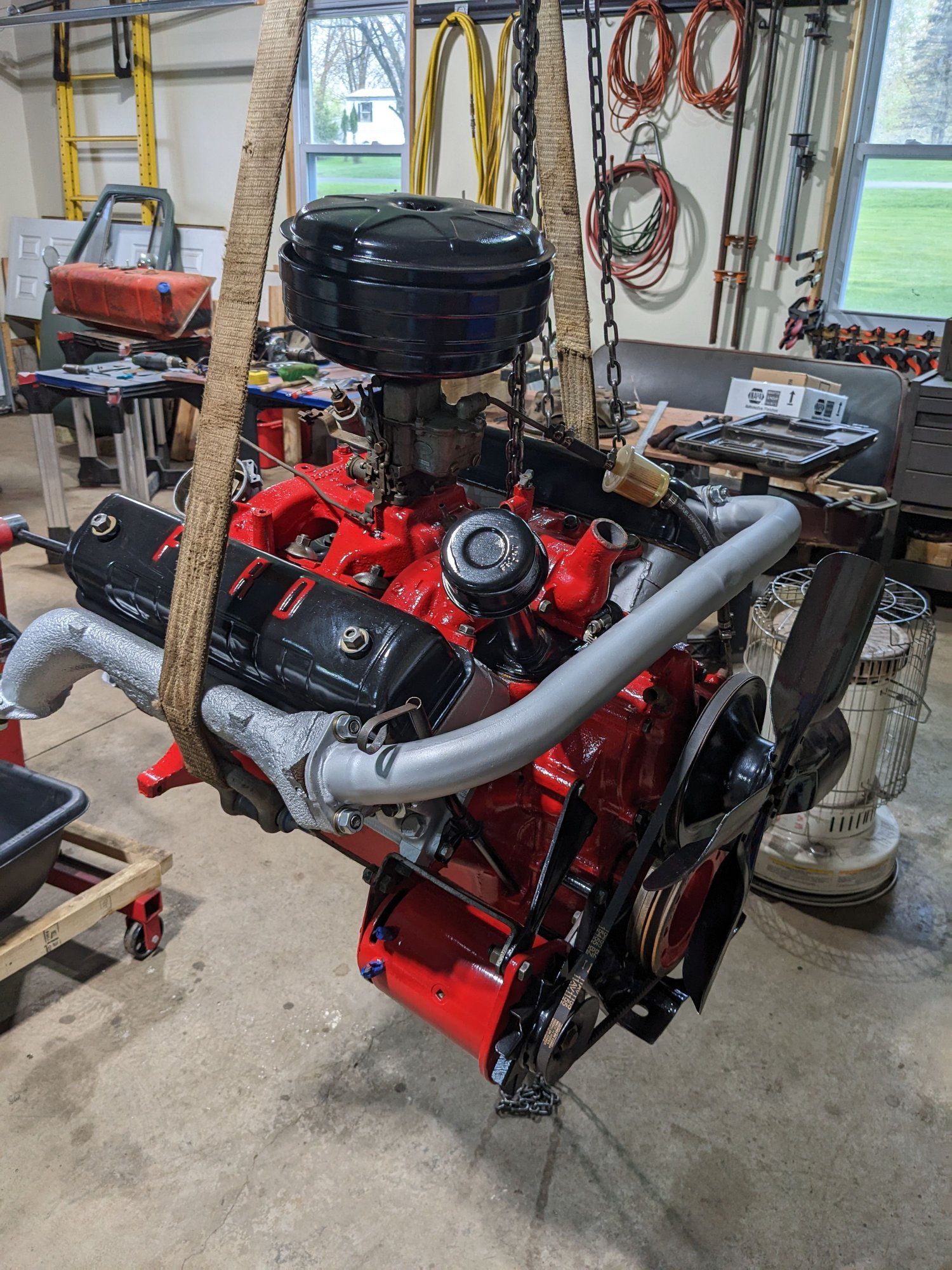

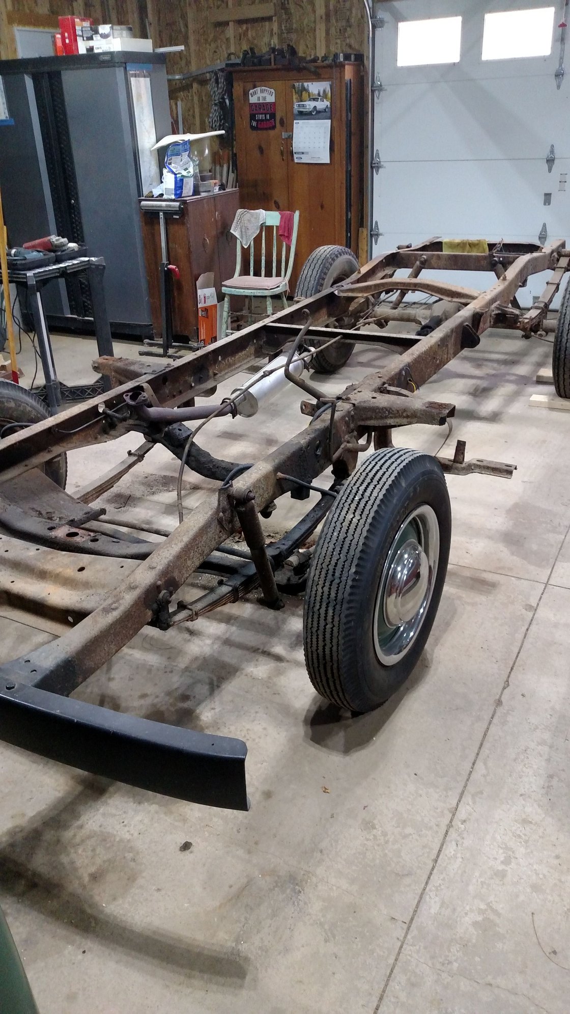

After apx 3 years of disassembly, cutting, grinding, drilling, welding, rebuilding, sanding, painting, and wood working I have finally been able to get my baby back on the road. After first purchasing my '54 F-100 and driving around I found the brake pedal sticking and the clutch pedal scraping on the split floor cover. Inspection found three out four of the cab mounts deteriorated (rotted out) and the cab was settling and binding on the pedals. Cab had to come off to repair so decided to do and off frame restoration. Well.....one thing lead to another and before I knew it I was ***** deep. Rebuilt the four corners, repaired/replaced sections of the rear of the floor of the cab, replaced air deflectors, cowl panels, repaired windshield seal flange, bottom front of the box and fabricated and installed a new cherry bed. Along the way I rebuilt the engine after having it bored .040" over, new exhaust valve seats, new valves, seals, lifters, cam, bearings, pistons, timing set, water pump, oil pump, block and heads decked, etc. Also rewired the entire truck.
I was not, nor am I still, a weldor or a sheet metal worker and all my structural repairs are hidden under a layer of bondo, but my baby is back on the road and I'm driving the wheels off her. I'll try to attach some pics. Wish me luck.
