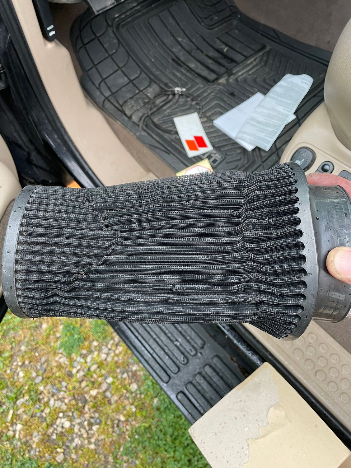

Todays fun
Was having intermittent issues with the air filter light and reset button, turns out most of the air piping has DK stamped all over it. PO said he put the intake on himself. Apparently DK is crap (please correct me if I’m wrong, never heard of them as a truck parts supplier before but this is my first diesel) due to PO stating less than 15k on the intake since installed last year and filter is trashed and collapsing under the pull of the turbo. Replaced with K&N 4” universal and runs great, no light and got 19 MPG on the way from Maryland to NY. Maybe even better than that since phone GPS Speedo app shows Speedo reading 5% slow compared to app. Also reading up more on the temps and not as worried as I was before, still may order an oil cooler prior to the big NY to MT trip but trying to research how much of a hassle to do in essentially a gravel lot with only hand tools and limited battery tools (at an RV park currently)
