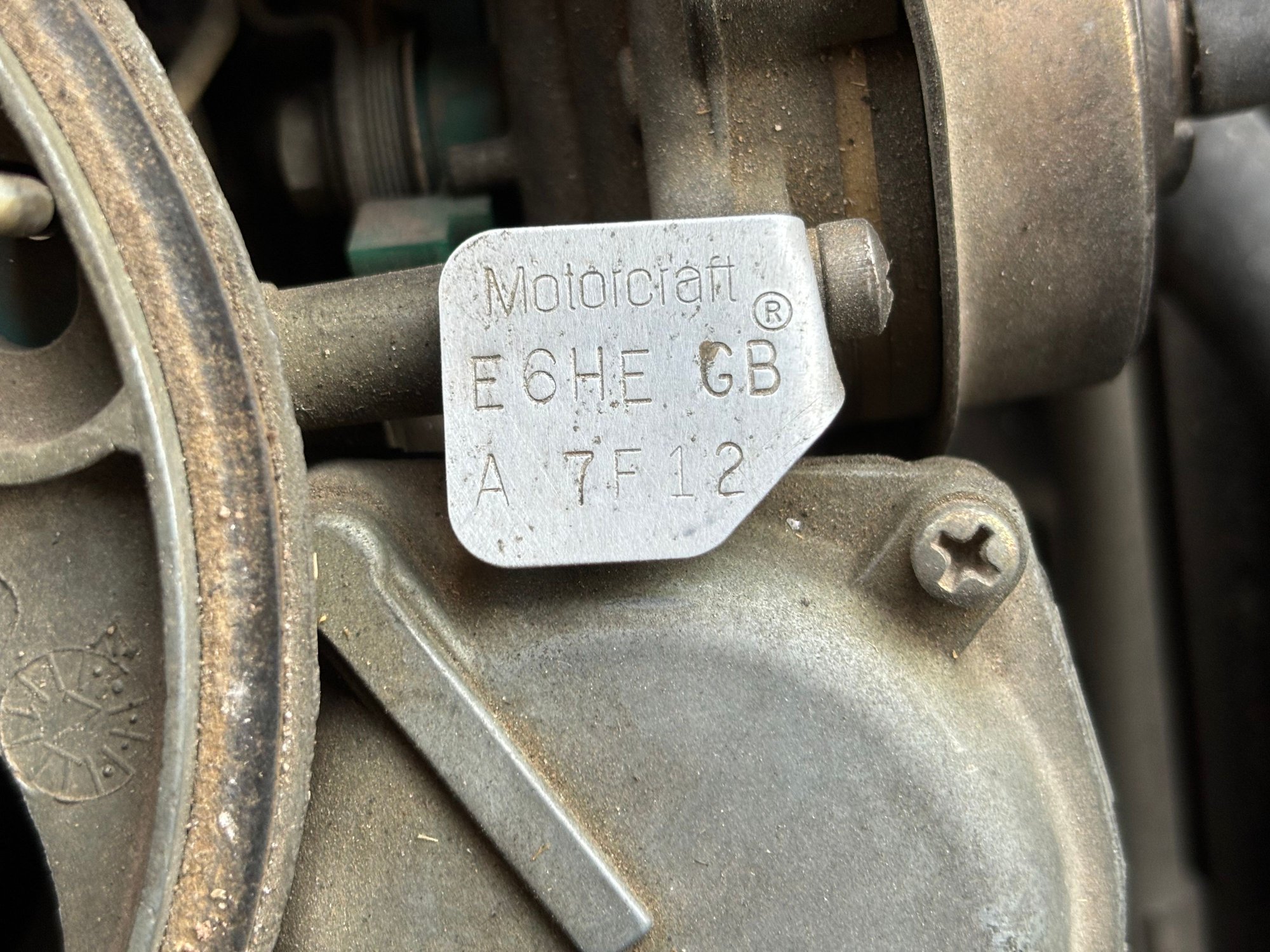

I would like some help finding a carburetor rebuild kit for my truck. It’s a 1987 4BBL F250 351W.
I’ll attach a photo of the carb I.D.
It reads E6HE GB A 7F 12

Basic Holley kit (of course there are several variations)
AutoZone should be able to order you one
With that tag number Ford can give you a part number and you can search Ebay for a New Old Stock (NOS) Motorcraft kit
Good luck
Put steel needle and seats in it for todays alky fuel
Good luck

Perfect! I found a kit on that site that fits my carb:
https://www.carburetor-parts.com/hol...uild-kit-k4098
but I don’t think it has steel needles and seats like manicmechanic007 said. So how would I go about finding those specific to my carbururetor?
Would these work?
https://www.carburetor-parts.com/ns649-holley
Thanks again!

They have always provided the upgrade sets for the carbs I have ordered ... Send them a message ... They actually answer the questions.
