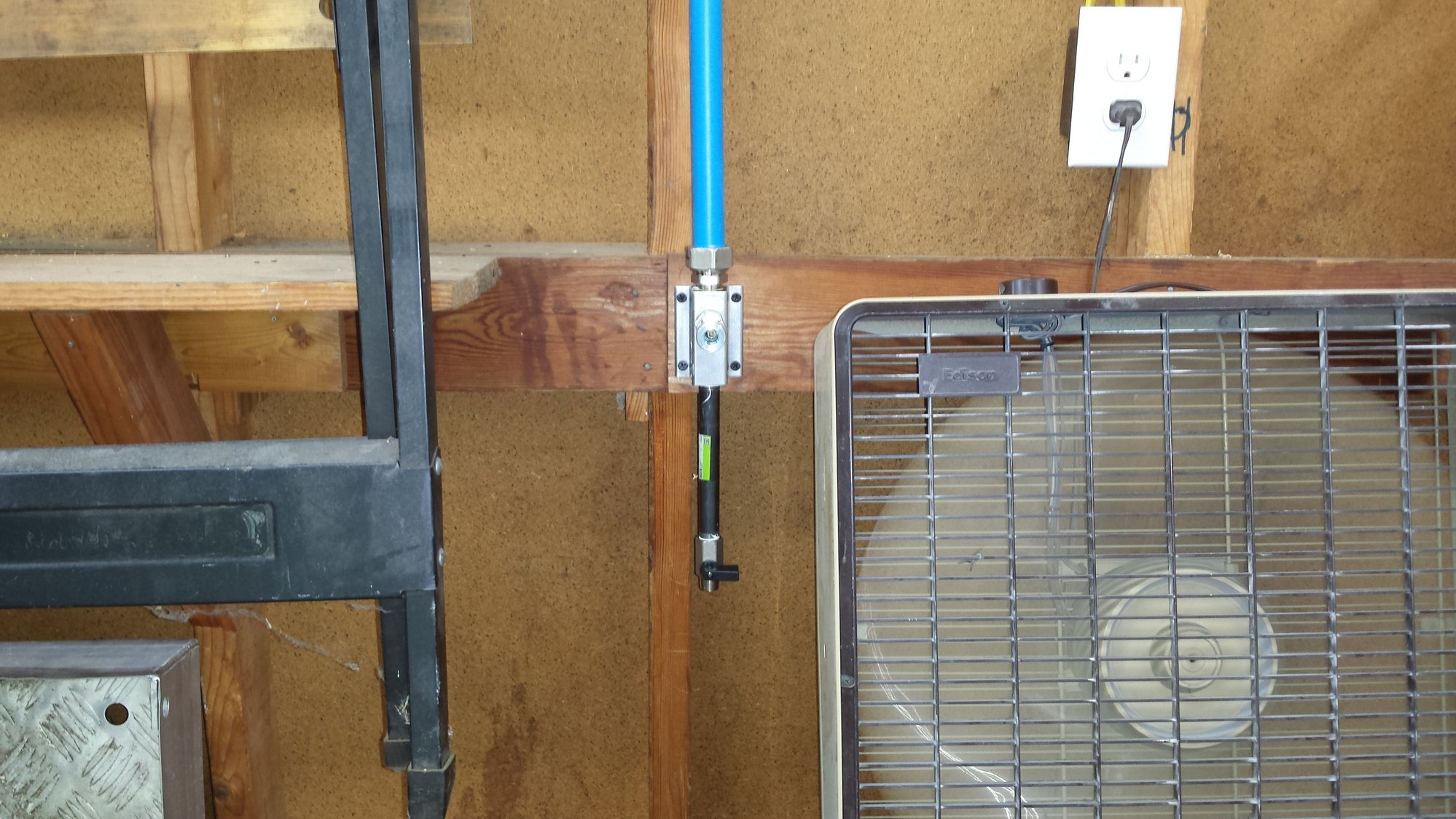

You can also see 1 of 5 air hose drops. 2 on the back wall in each bay, 1 on each side wall of the bays (the right side has a work bench where the other drop is) and the last on the front wall between the 2 bay doors. Each drop also has a drip leg.
Hose drop & drip leg, all 5 are like this.

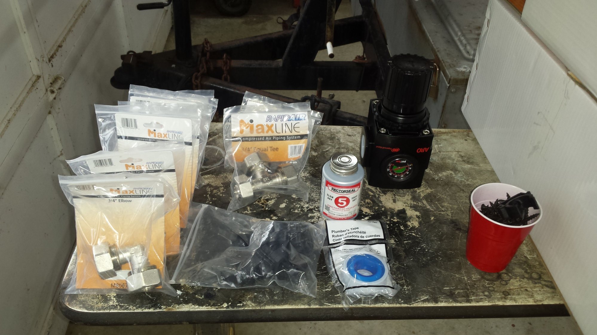

This is the piping kits I used and bought some extra parts as needed for my lay out.
I made a complete loop around the top of my garage so it feeds from both directions. It also give more time for the air to cool off if needed.
