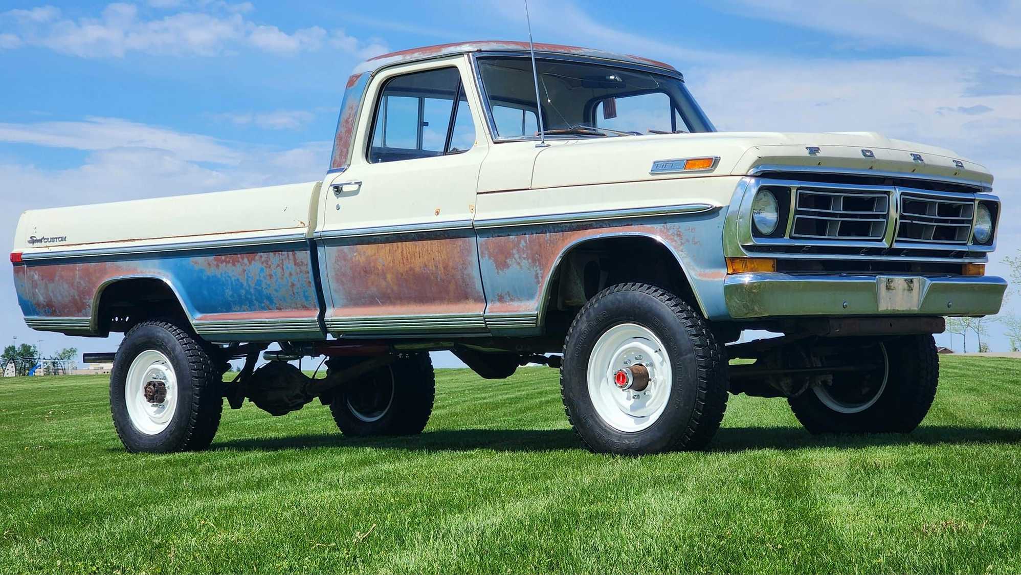

Picking up an original 72 F250 Highboy. Want to upgrade the stereo with a Retro Sound head unit and an upgraded 2 way speaker in the dash. Wanted to put some more speakers in for better sound. Would love to get some ideas on best speaker options in a bumpside that will look and sound best! Thx

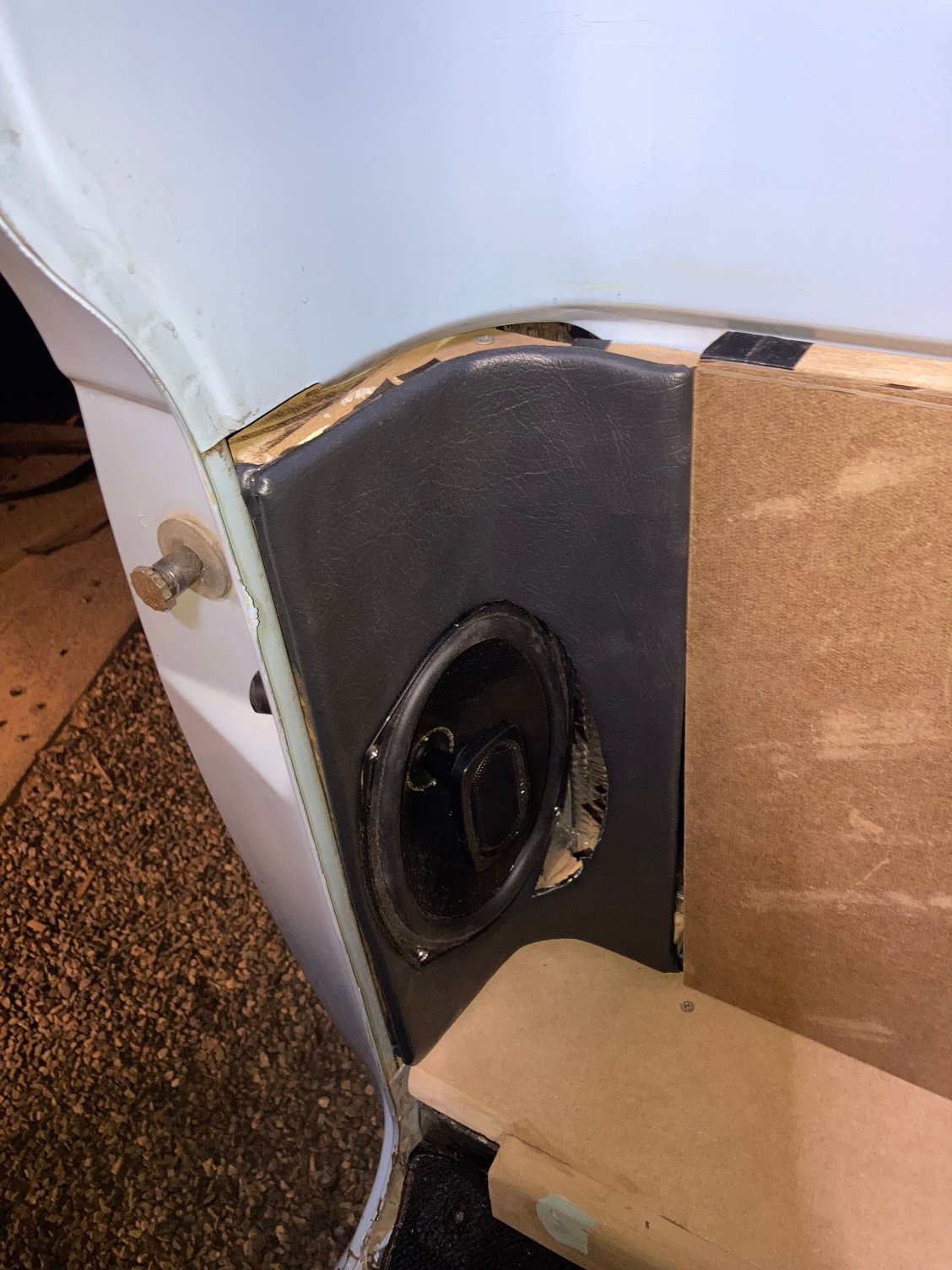

I am building a 72 highboy as well. I ended up adding another stereo below my dash because I wanted a cd player in mine. I left the non working AM radio in the original location. Anyway, I had to make a new bracket to mount a different speaker in the under dash location and also made two cab corner mounts out of sheet metal. On my cab corner speakers, I had to stretch cloth material over them for covers because the ones that came with the speakers wouldnt clear the in-cab tank. Besides what I have done, I have seen others use the headliners with built in speakers, build a kind of center console with speakers(two wheel drive A/T only), speaker mounts on the floor of cab down by your feet in the corners, and some cut holes in the doors for speakers. I think that is pretty much every scenario that I have seen. As far as best sounding speakers, Im not up and up on that. I used some cheaper Pyle speakers for now. I think it was a 6x8 under the dash and two 6x9s in the cab corners without searching back through the build.

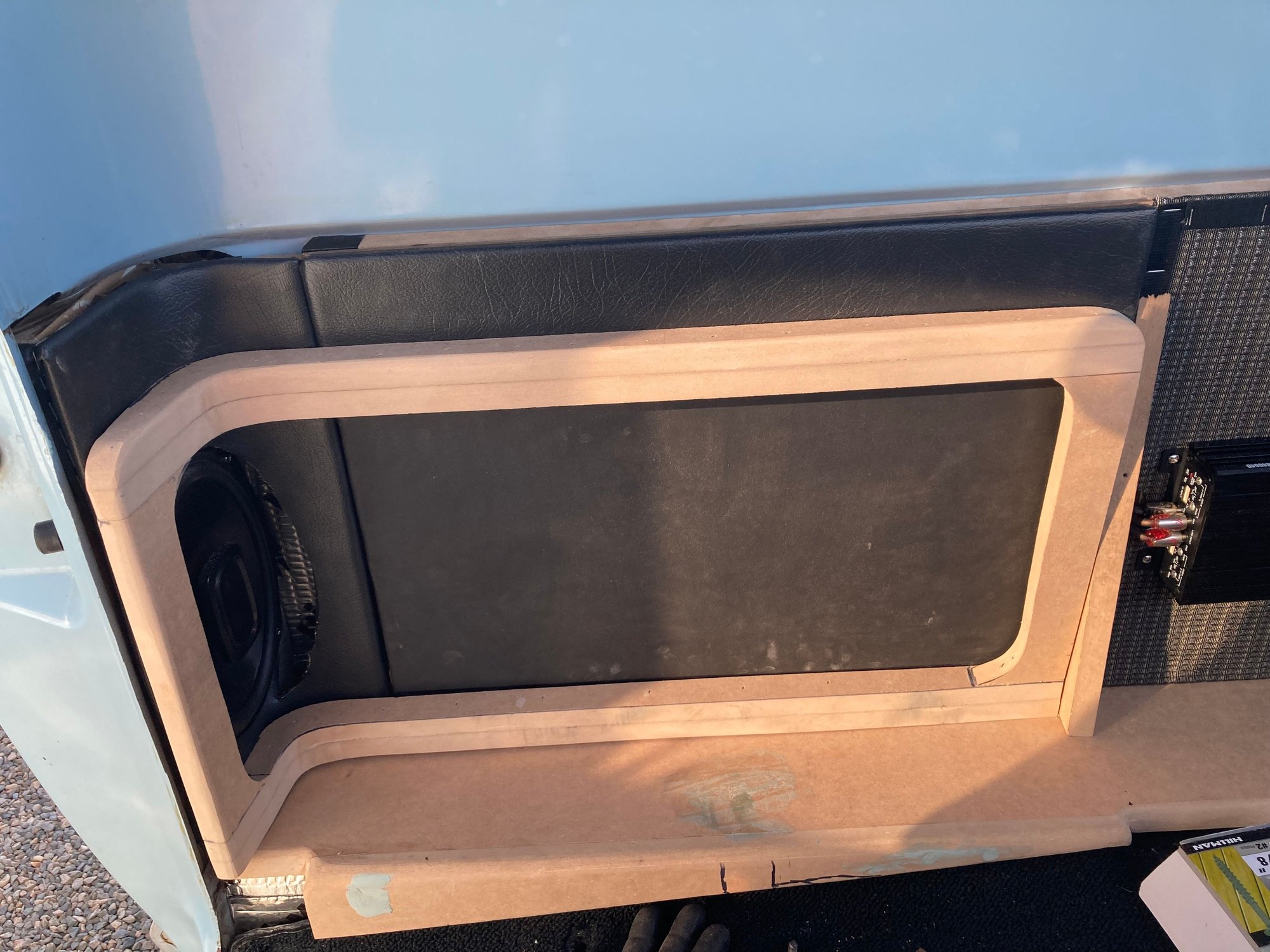

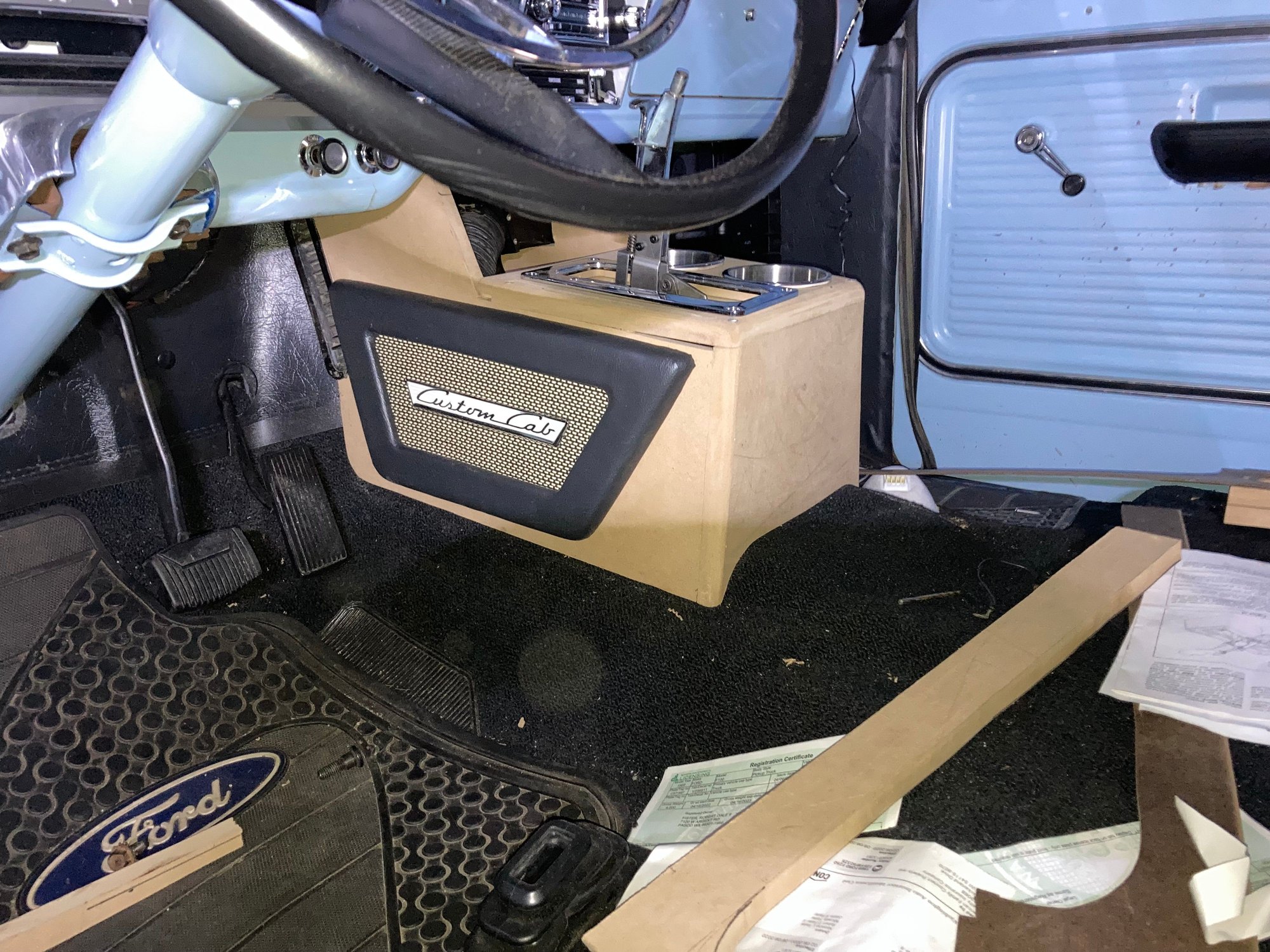

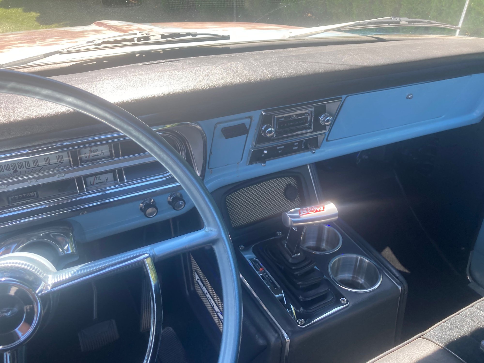

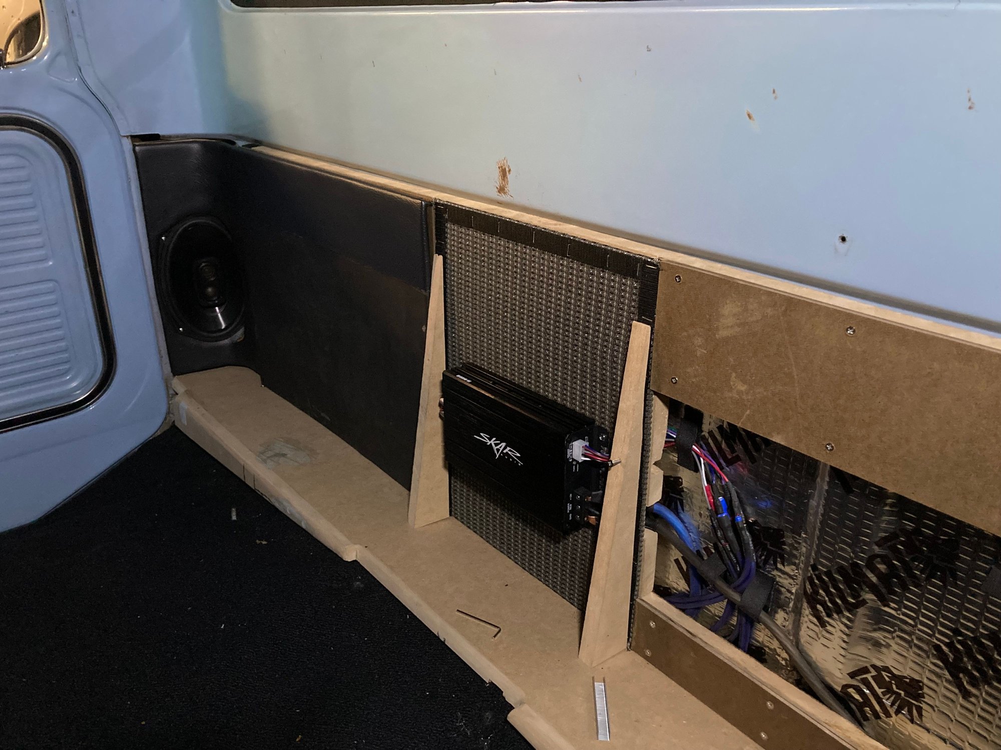

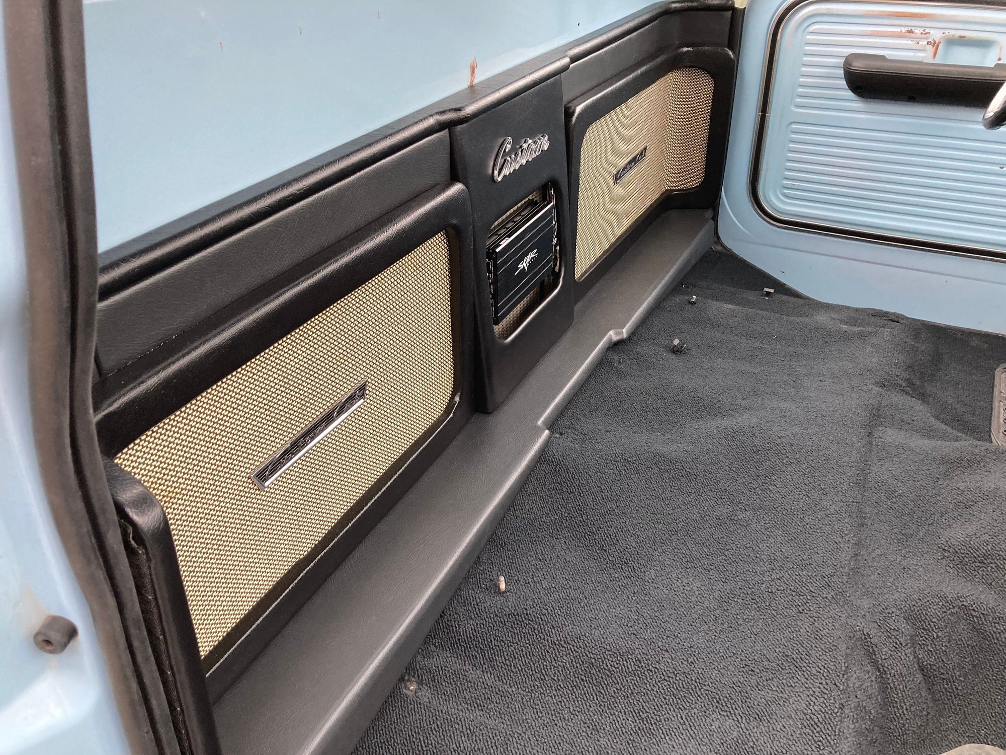

I didn't want to cut any of the sheet metal in the truck so I removed the tank behind the seat (gains a couple inches to put the seat back farther too) and just use the tank under the bed. Then built back wall panels with 6 x 9's in the corners and a mini amp in the center. Also built a center console with Speakers in the sides of it with a wireless phone charger, cup holders, and a USB plug.

You definitely have to pull the tank out to fit them in the corners. This is in my 72 f250 4x4. That turned out nice FoPar1972. I did get rid of the in-cab tank on my 70 f250 since I had a auxiliary tank.

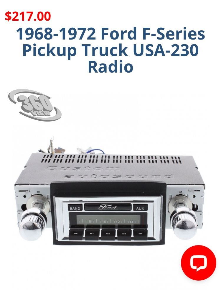

I've bought 2 head units from Classic Car Stereos and have been very happy with both. The ***** are wrong but I like that it does at least say "Ford" on the face plate. It's easy to use and with the add-on of the Bluetooth adapter for $45 you still come in under $300.00 They have other head units that have more options and cost more but this one works great for me.
Here's a link... https://www.classiccarstereos.com/19...o-usa-230.html
