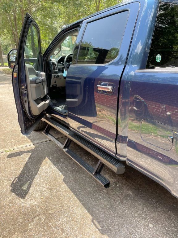

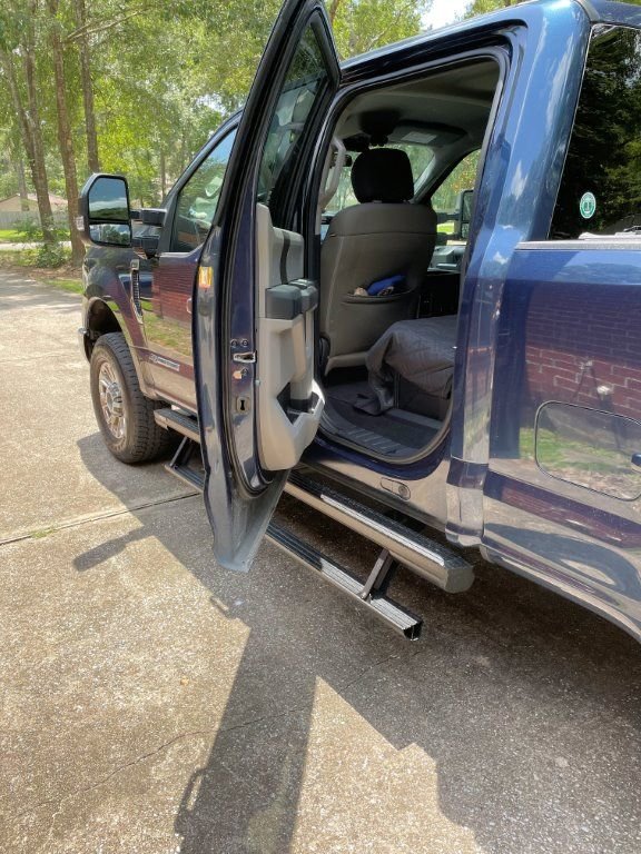

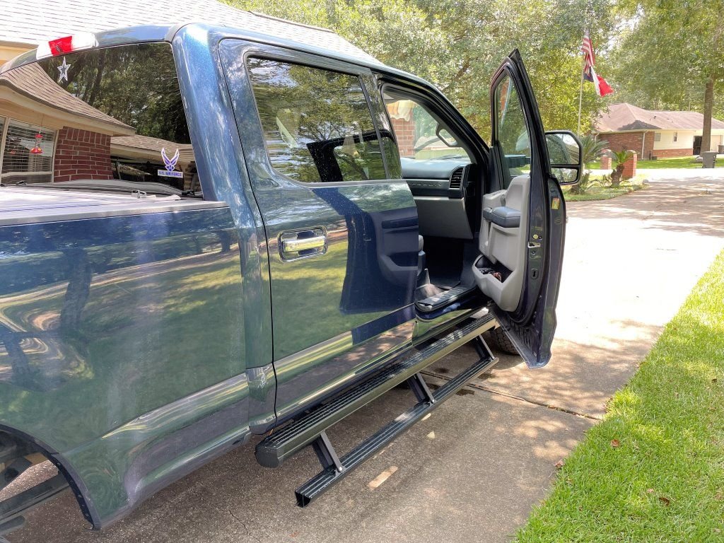

I put these on my truck. I needed some that would be low enough for my wife to get in a little easier, and then me as my knees/legs are starting to crap out on me. It took me a few hours to install them mostly by myself (I needed my wife to help actually hang them). Not too bad. Most of the real hard work was making sure the wiring was run and hidden so it all looked factory. I would highly recommend them.
