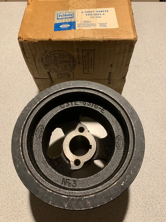

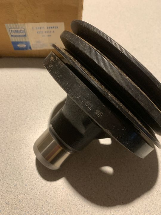

Well, since it was bumped to the top I'll add a photo. This is the double sheeve pulley for 1963/64 292 trucks.
C3TZ-6312-C - PULLEY ASSY. - CRANKSHAFT - Double sheave
