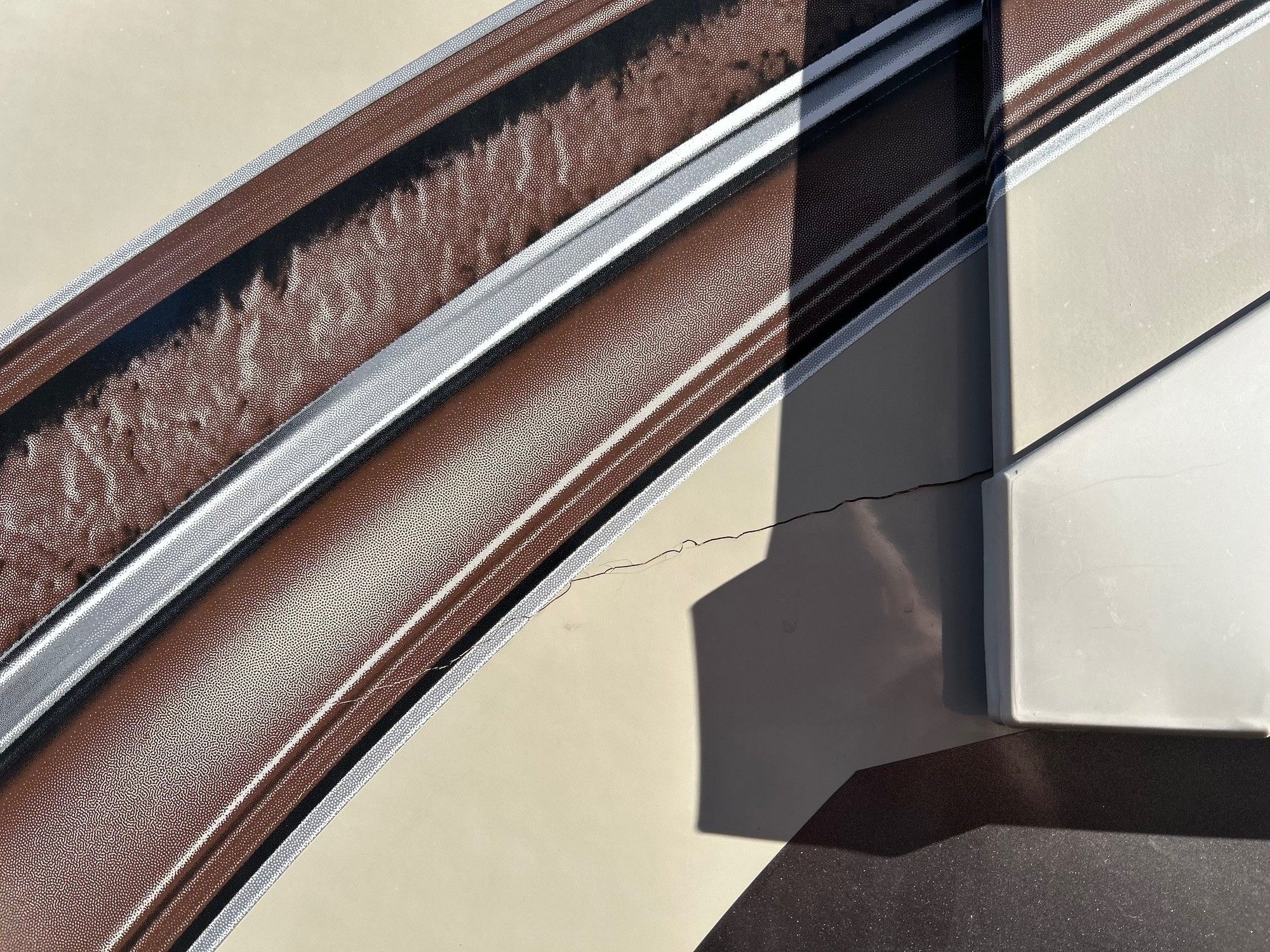

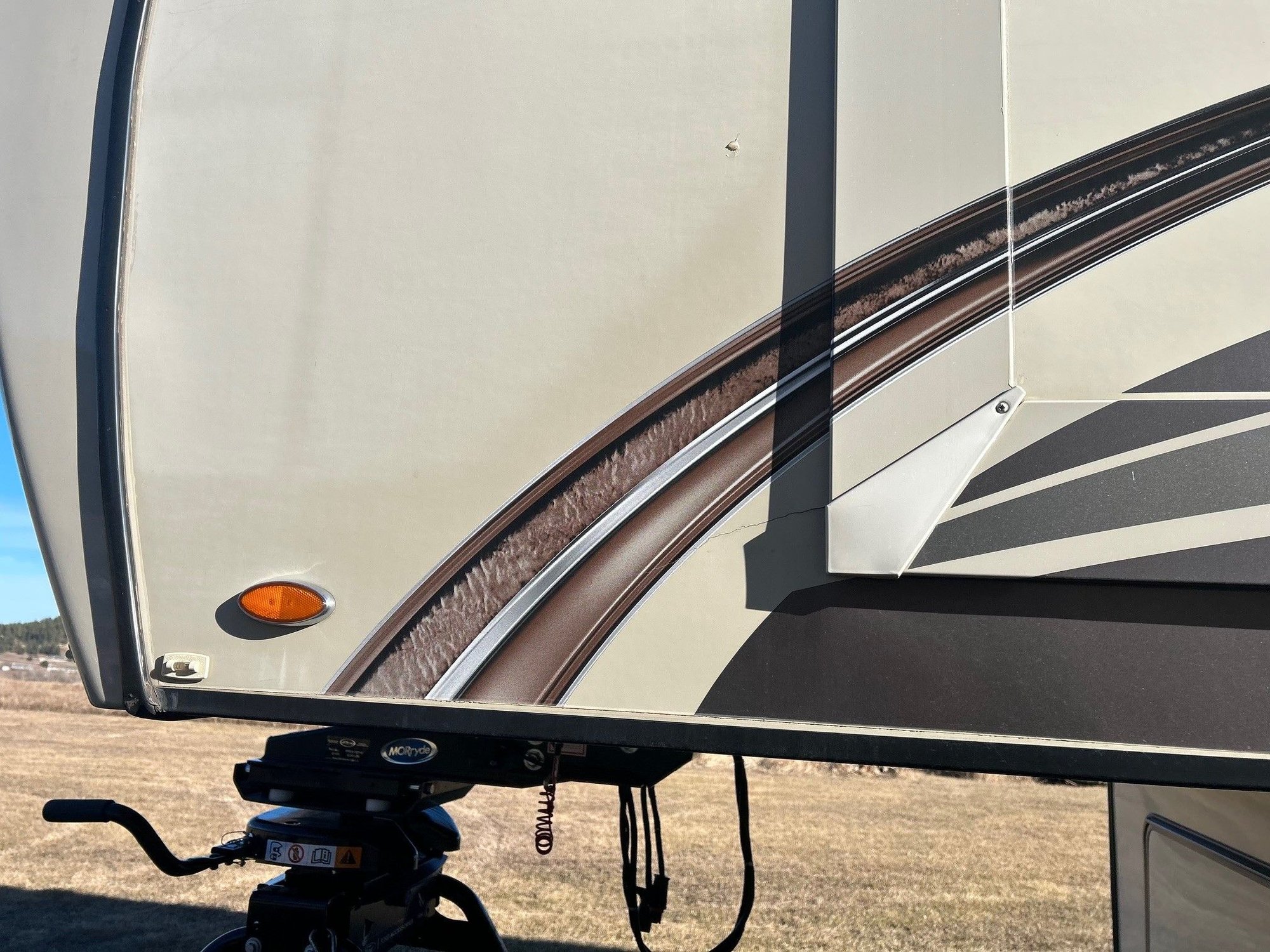

Well, it's time for me to add ours to the "crack in front of the bedroom slide" list. Wife noticed the crack back in July. It was barely noticeable to me at that time. After using and pulling ours another 1000 miles, the crack got noticeably bigger. I had a buddy that this happened to and he sent me a ton of info. I did a lot of Googling and YouTube video watching. I emailed Jayco and they declined to help with the fix. Said I was out of warranty of course. We bought the Pinnacle in early 2020. It's a 2018 model. Warranty expired in early 2022.
I towed it to the dealer last weekend. They are going to do an assessment and give me their take. I'm inclined to think that the frame is fine since the flex is less than a half inch when you take weight off the front jacks and apply it to the hitch. I'm thinking the wall in front of the slide is separating from the frame. Most are lag bolted and when those bolts loosen from running the slide in and out over the years, that causes issues including cracks in the fiberglass outside. I joined a class action lawsuit as well. No idea what will come out of that or if there even will be a settlement. In the meantime, I'm waiting on the dealer to give me the news. I'll report back here when I hear from them. This is really a low blow to have happen. And it happens to a lot of people. We bought a high end RV to last. Long enough so we could go south a few months after I retire. Now this happens. UNREAL. Can't even sell it or trade it without taking a huge hit. Thanks Jayco.
Below are some photos for your viewing pleasure. If you have a 5er built between 2018-2022, 38'+ long with a slide (or 2) over the from bunk, I would strongly suggest having a dealer look at it. Or if your handy, check the bolts that secure the walls to the frame. May save you from a crack. These issues are not manufacturer specific. Most involve the Lippert frame though.

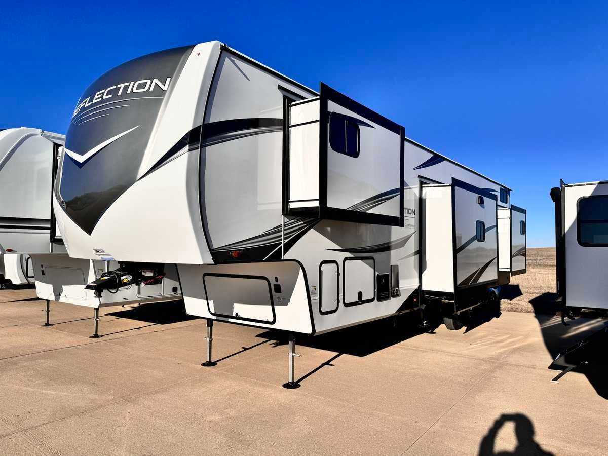

Originally Posted by MKrenn
With all 5th wheels, there is flex. It's how you manage that flex that will make your product better. I do believe, there is no such thing as a high quality RV. They are all junk. Some are better, but it's just better junk.
I have a seem at the front of my slide. I always wondered why most 5th wheels have this seem. I found out the reason is that with the amount of flex on that area of the 5th wheel, if you did not have this seem, the panel would eventually break. A lot like large cement pads. Typically, cement breaks over time and by designing where they break is better than a random break.
If you look at this photo below, you will notice a white trim piece that covers the seem. If you look at a lot of 5th wheels, they all have this seam. I was surprised that you did not have this seem and that is why the panel broke. Mostly a poor design. If you would cut the panel so there is a seam, fix the panel properly, I bet it will never break again.
I sure hope the words I chose make sense. Usually, they don't.
Front/Lower vertical white trim covering the seam.
My 2021 Solitude did not have that seam on either side and it had opposing slides on the tongue.
