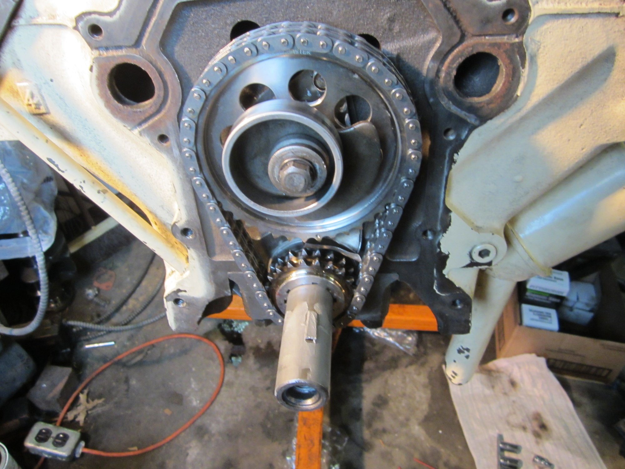

I put the engine together and I'm as sure as an old man can be I installed the timing chain with the timing gears 12 pins apart. Is it possible for the engine to run 11 or 13 pins apart? Is there a way to tell without tearing the engine's timing cover off? It's kinda a PITA because it has a vintage air system all bolted to it.

Just went out, pulled #1 spark plug ran #1 up on compression stroke a the timing mark is between TDC & 10° BTDC. I'm hoping this means the cam to crank timing is good.

Thanks for your thoughts. I would have agreed about the butterflies not being right if I'd have only tried one carb but one was brand new outta the box. Holley says they flow check EVERY carb. Yeah I know throwing money at a problem rarely fixes it. I've about consoled myself to pulling the engine so I can get at the timing cover and finally the timing chain. I've assembled several engines and never had a cam timing issue before but I'm leaning towards that being the problem.
