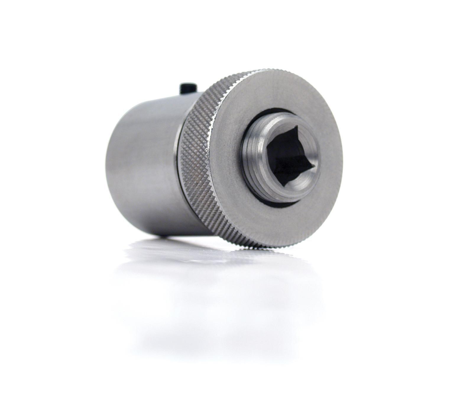

If you don't mind me asking how did you attach your degree wheel to your crank? With the key way set back so far you can't use one of the regular degree wheel mounting hubs. Like this.

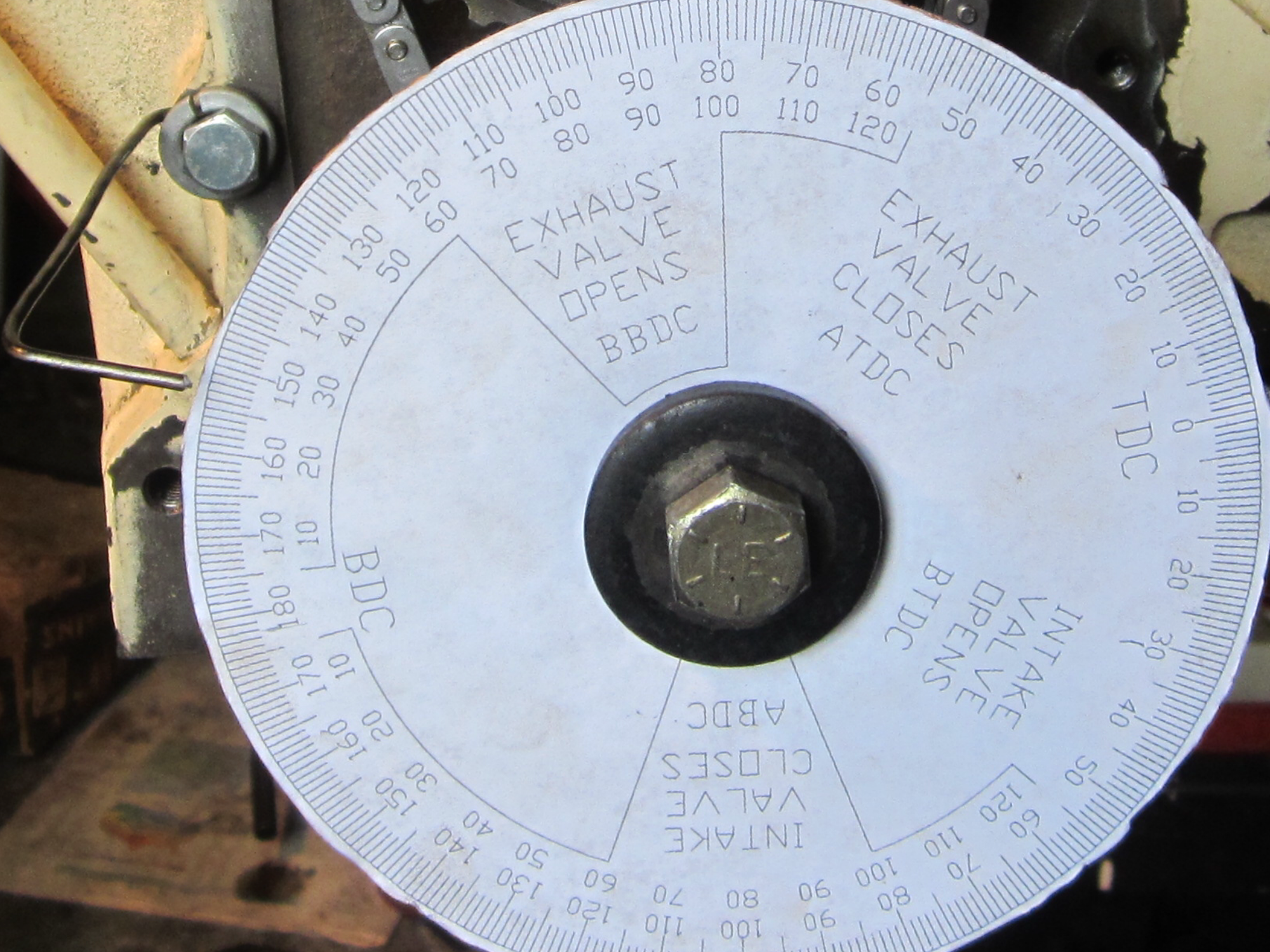

I printed a degree wheel off the internet and glued it to cardboard. I used the bolt and washer from the crank and tightened it up. The 239’s don’t have a dampener. Fastened a wire to a bolt.
