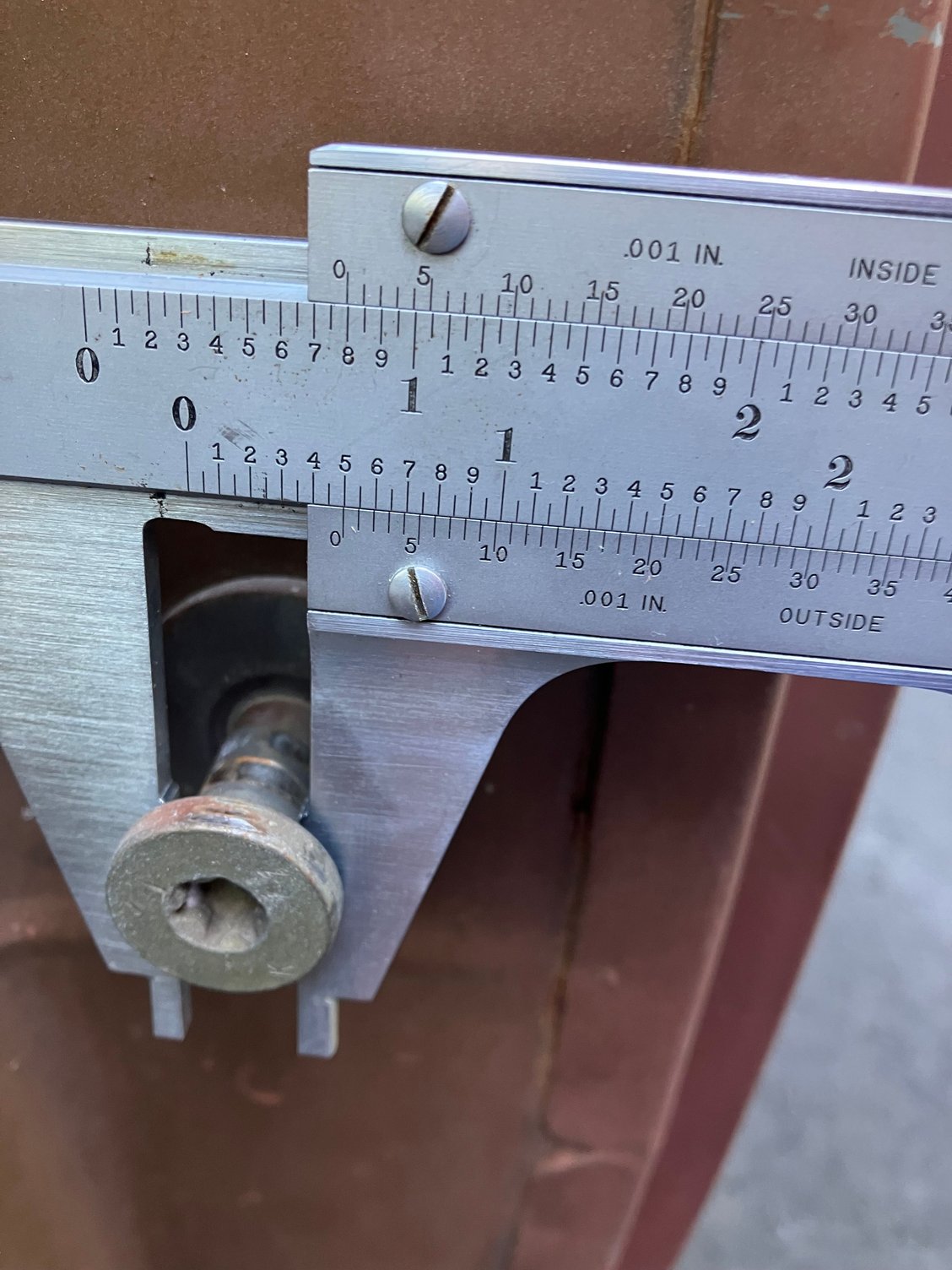

Looks like just under .500" or half an inch. That's measured on the front end of the pin, where there is no wear.

Thanks Max, and 1/2" pex is the ID, so should work fine with no tape on the pin.

I measured the ID of the 1/2" pex. It's actually slightly smaller than 1/2". About 0.47" so might be spread at the slice a red one.
