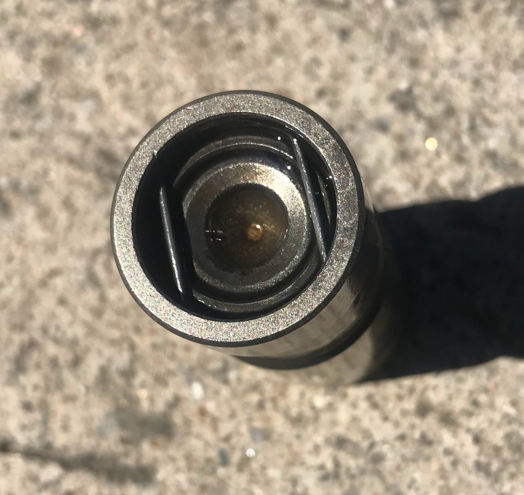

Dave, I know it's not the most accurate method but I measured clearance between valve stem and rocker on base circle and ironically both push rods that were off are MPR-311s instead of the 4170 that the rest are sporting. The clearance for the MPR-311s were 0.0805 and 0.0790. Those are both 3/8" ***** on both ends measured with calipers. Could be "sitting too high" in the cup, like you mentioned. I have one on the other bank that measured 0.2270 clearance so I'll be getting a longer push rod for that one. Just trying to eliminate some ticking so I bought a new non-adjustable rocker shaft assembly, spacers, and end stands and want to replace the push rods while I'm at it to get within specs. Would ya'll be able to tell what cup size the lifters have based on the attached photo?

To me that looks like it is for the larger style ball end.

I guess I'll have to pull a lifter again and see how well the ball fits in. I'll also measure the diameter with calipers. New to this so I really appreciate the help!
