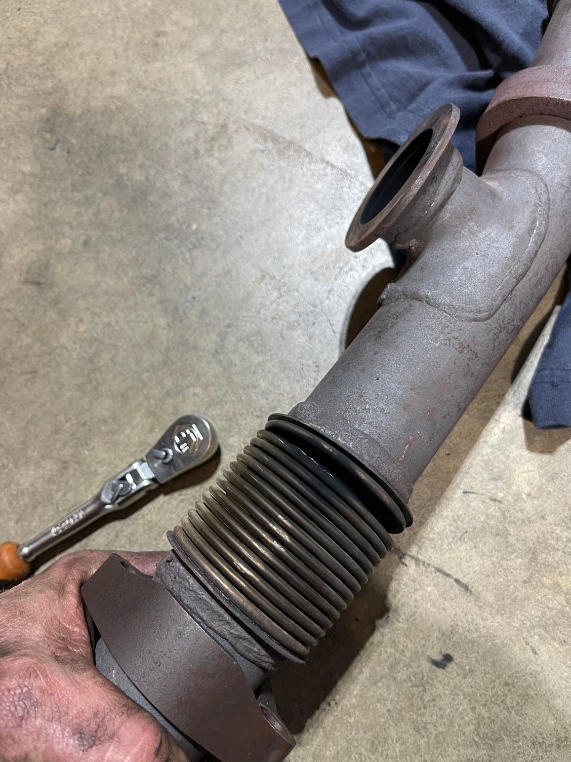

Originally Posted by bismic
The cap vents around 15-16 psi. If you reach that pressure, then the sound you hear is likely to be the cap venting pressure. Most likely source of this (if you have it) is a leaking head gasket.
It’s very likely if your degas bottle cap is venting you’ll have coolant residue under the hood. This is also a good tell tale. Check the exhaust bellows as well. These are prone to crack. The tell tale for this is carbon/ soot on the bellow itself or on the firewall behind the engine. In some cases, cracked up pipes can cause a squeal at higher RPM.

It did it all the way into town yesterday. I stopped in a parking lot, shifted the intake boot around and it hasn't done it since. I've got a new intake boot on order.
