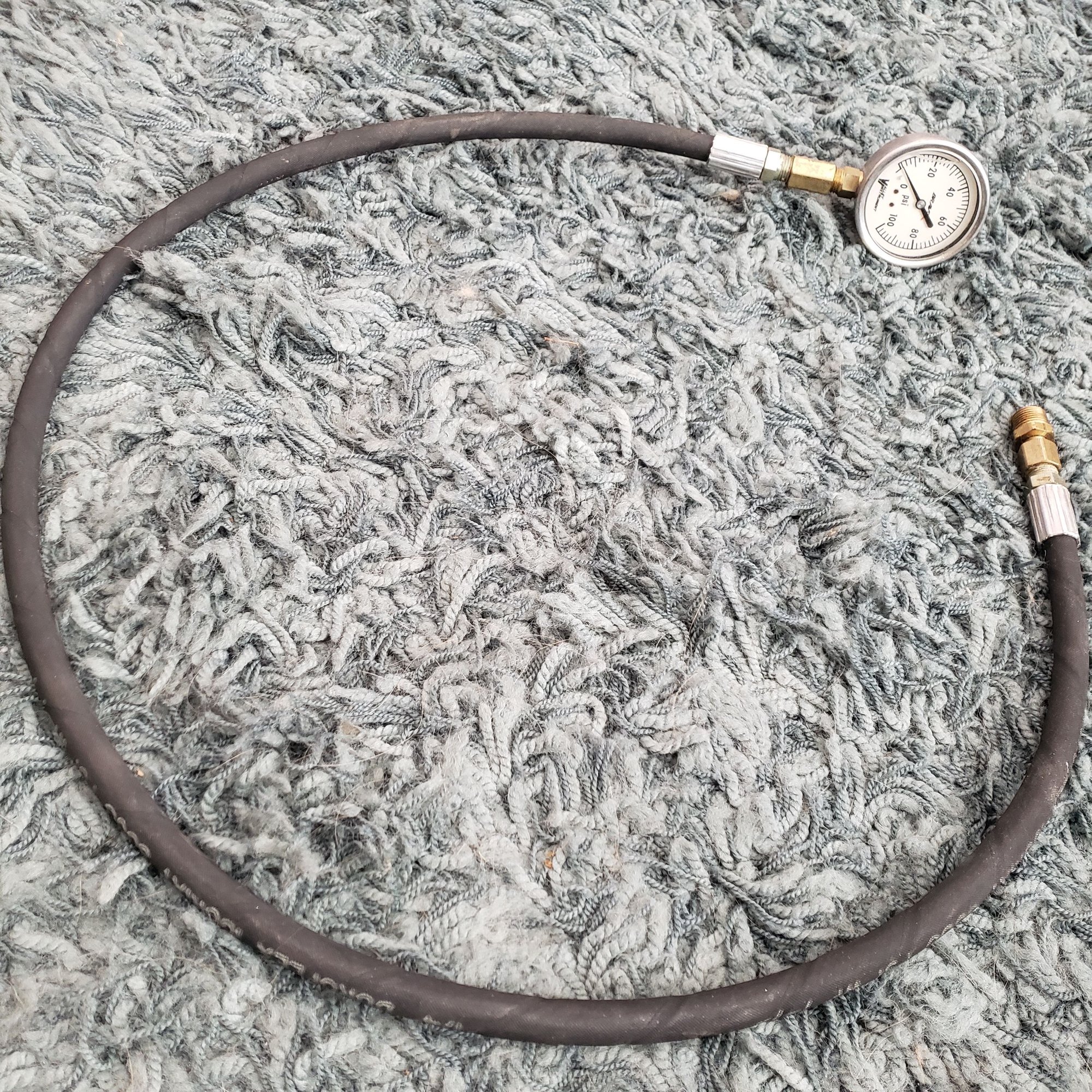

You should be able to rent one of these
Direct pressure gauge used for oil pressure testing. This one has a nice oil filled gauge, cost about 70 bucks
Okay I'm going to look into renting one of those and testing the oil pressure and change out that oil pressure sensor. Crossing fingers these two will solve my answer. Thank you everyone for the help. You all have been wonderful!
