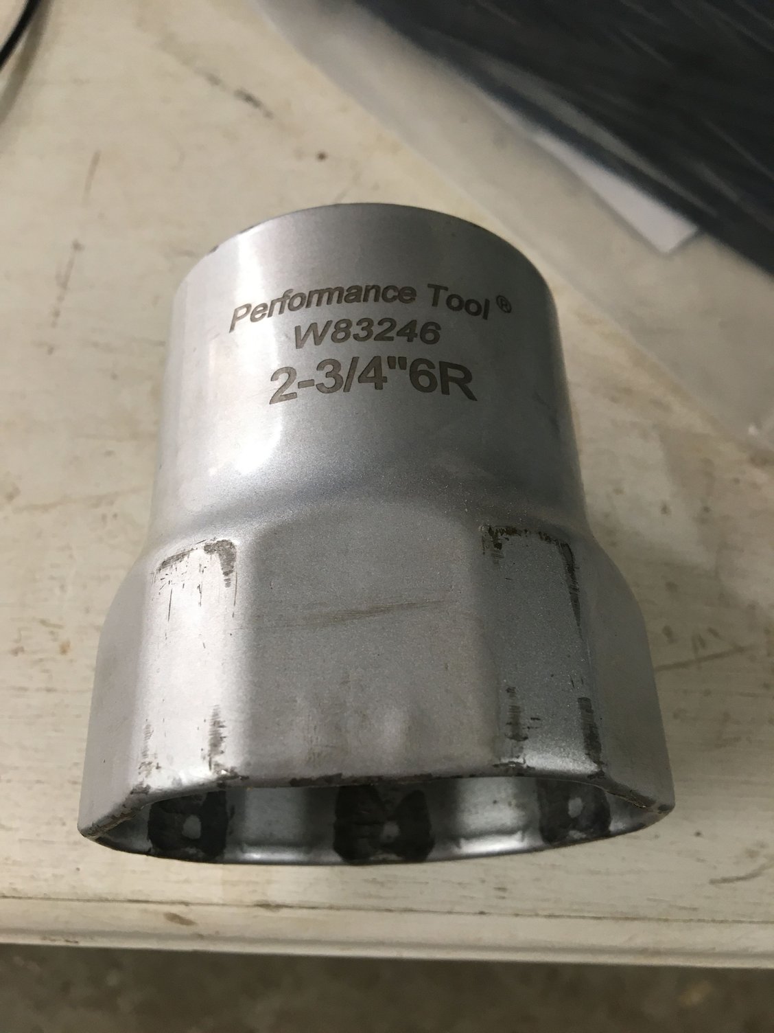

Im assuming by ‘automatic 4 wheel drive’ you have auto hubs. You will need a hub wrench/socket for those hub nuts specifically (manual hub locks use a different type of socket). You can look on torque king web site for the socket (it’s for sale in multiple places). It’ll have rounded corners to fit inside the hub 2 3/4” - performance tool W83246 - I’ll post a pic. You will also need a set of good snap ring pliers to remove the outer axle snap ring and thrust washers.
