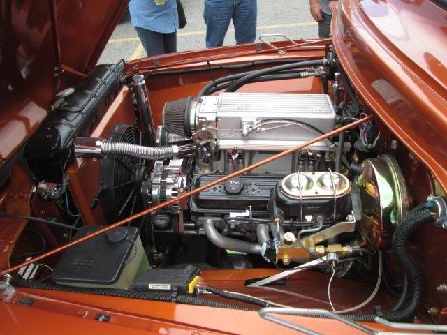

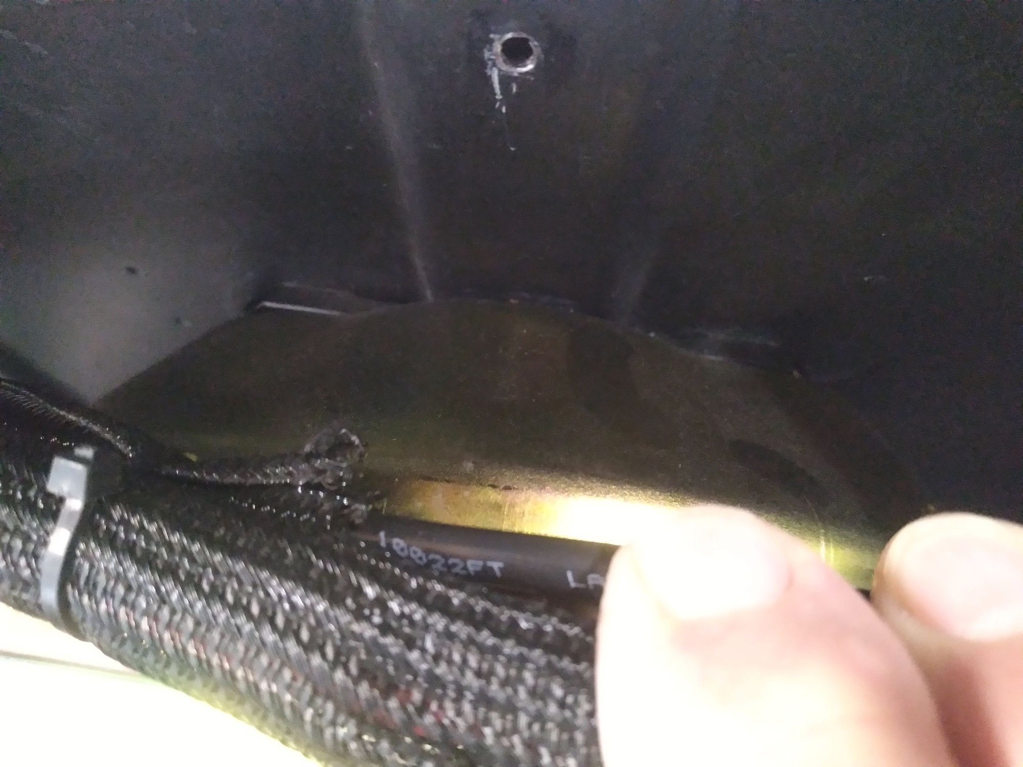

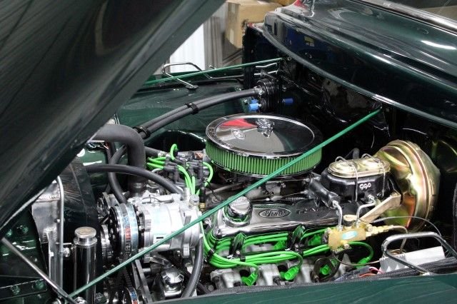

Have not installed the cpp but I installed an s-10 pedal, booster and master in my 55. Pretty sure we just put the pedal up in the dash and mocked it up where wanted it (comfortable to drive) and found a reference point to measure on the outside to make sure the booster and master wasn't going to interfere with anything. I did run close to my front end rods that run from the firewall to the rad support.

I have two 56 F100's and I used the measurements that CPP supplied no problems..

Those are the instructions that I used.

Yes those are the instructions I used..

EXCELLENT info....Thank you 56 and AV.....Appreciate it! Thanks for taking the time to post and provide pics.
